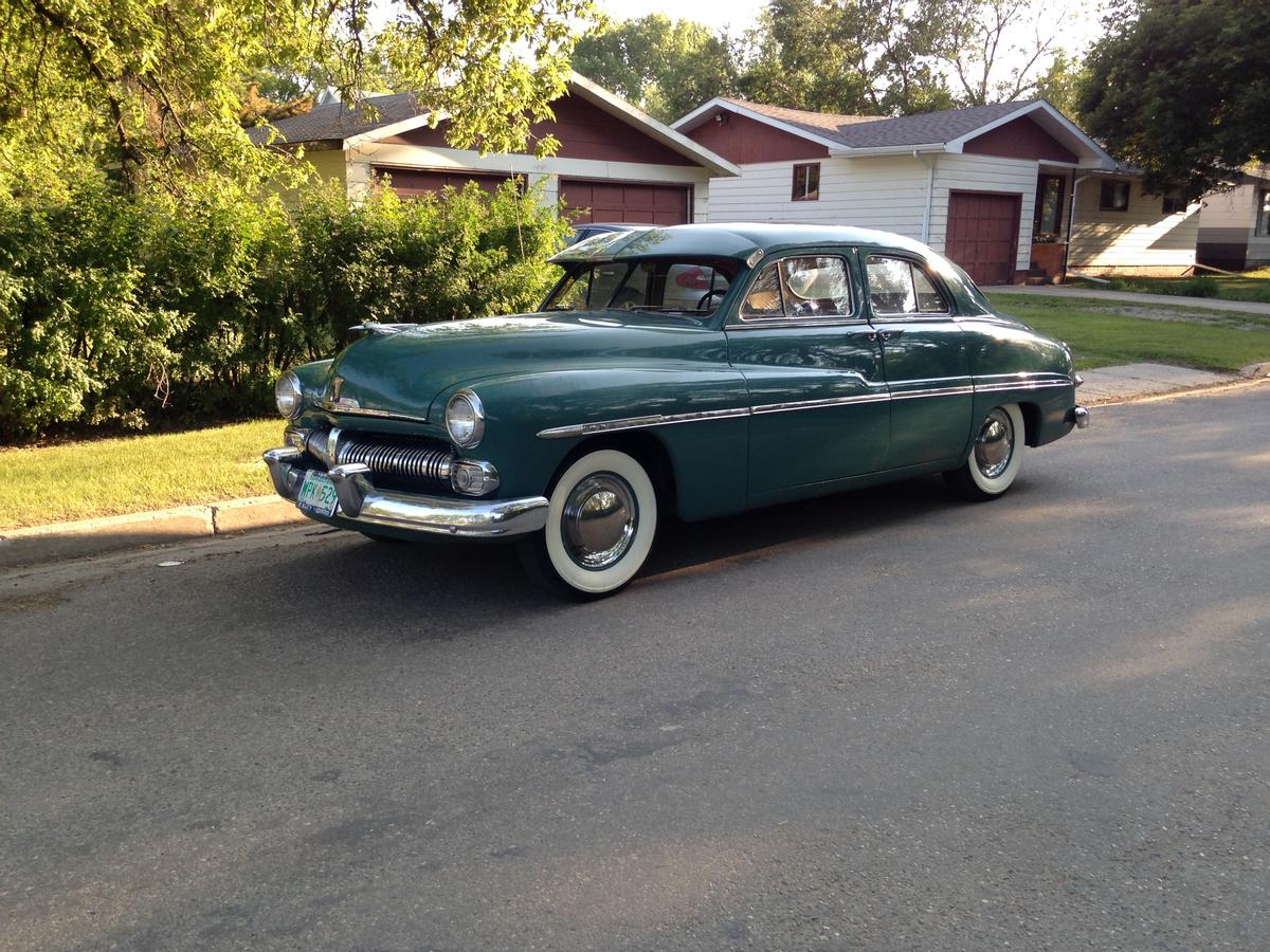

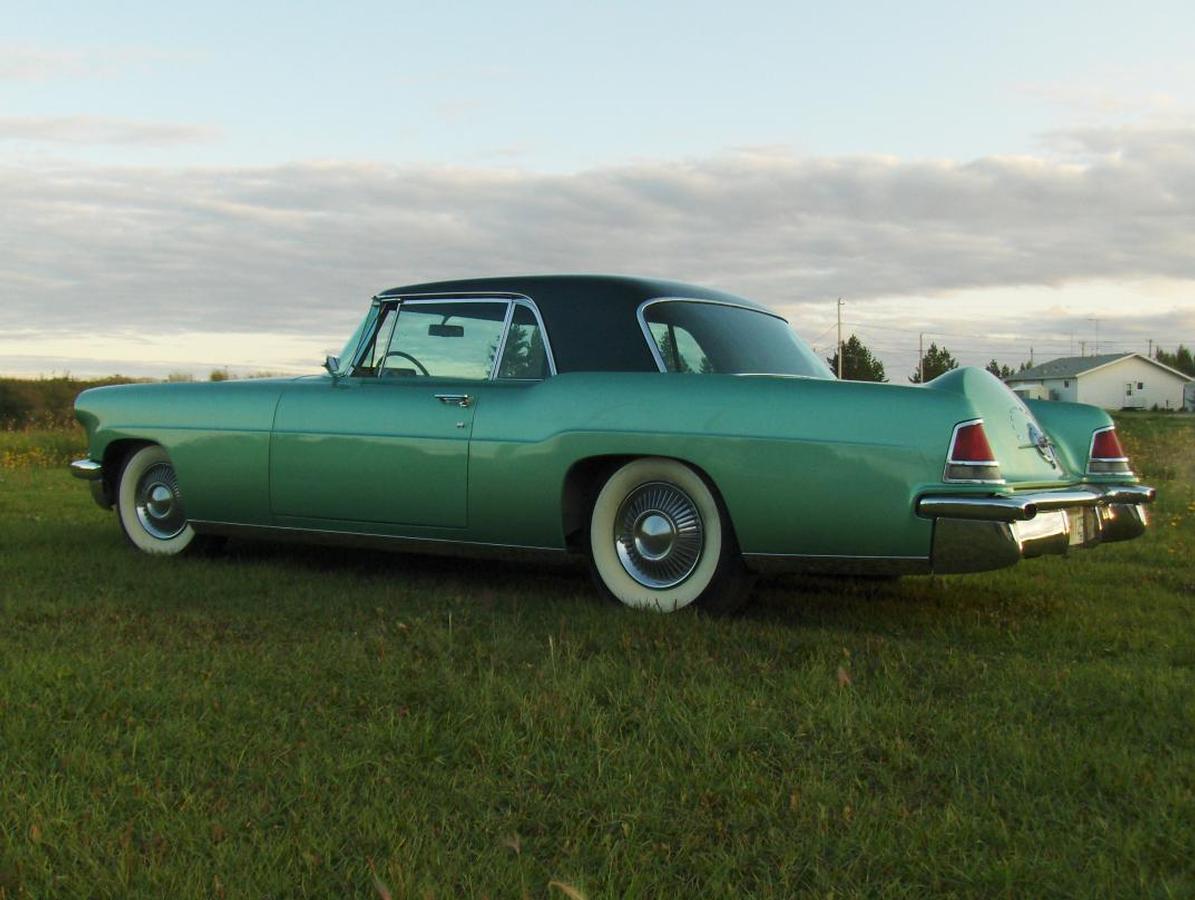

Also having a 56 Continental Mark II I have read numerous threads and posts on this topic on the Mark II forum as well. The older rims are strong enough but flex more than modern and the radial tire has more flex than the bios ply. The flexing causes the wheel covers to creep until it rides up on the valve stem and flies off and my wheel covers are EXPENSIVE! It came down to purchasing replacement rims and keeping an eye on the offset, width etc was required. I have Firestone Deluxe Champion 8.20x15 on my car because this is what my car was ordered with according to my dealers invoice and BESIDES it handles unbelievable as well!! It handles so well it makes me realize that:
Their front end/front suspension is worn out?
Their front suspension isn't. Aligned or set up properly?
Or they are running too little or too low air pressure!!
You would be amazed at how many think they should be running 24-26 PSI in the Bios ply on a car that weighs in at 5400 pounds if equipped with AC. I run 32-34 in my Firestone Delux champions on my 50 Mercury and 56 Continental and get long life out of them.
New rims, drilling holes and using sheet metal screws, silicone?? As they say in Yiddish "Oy Veh" I couldn't be bothered to watch my covers pass me in the ditch.
