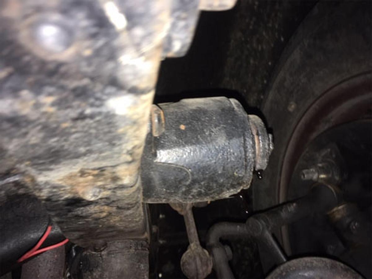

Can someone please ID the part in the photo for me, front left wheel steering suspension? Leaking grease. Any comments? Thanks.

Looks like a shock absorber. I assume an arm extends back from what we see in the picture and attaches to the link which is visible in the picture. Charlie Stephens

I enlarged the pix, it is the front shock with the fixed type of arm. Send the shocks in and have them rebuilt... Make sure you use the correct type of shock oil.

Input on the shock repair. I have 2 front 2 rear for my 36 hump back 4 door. When I checked 3 years ago there was a shop in the Chicago area who rebuilt vintage shocks. The bill for shipping there and back was going to be $230. Repair cost if the shocks were not frozen was $150 per shock. I chose to let them sit in my box of "things to do". Oh, what your seeing is not grease. They are filled with, as I remember, a special/specific oil.

It's a later service part replacement shock, not the original version used in production which had spun stamped steel cover (and a pressed-on arm like that in your photo).

HI 36 SHOCKS I used MOTORCYCLE front fork oil in hydraulic shock,on early Fords the shock oil comes in many different weights, so if shock moves to easy go to thicker weight oil , just about any motor cycle shock carries this oil as long as the shocks move this might help you out, if shock are frozen try using Liquid Wrench and soak them , for a few weeks,. keep going back to see if they move some might take longer then others also YOU CAR WILL RIDE BETTER, and MORE IMPORTANT WILL BE SAFER TO RIDE IN,esp on bumpy roads, well worth the money for being safe, keeps car under control hope this helps 37 Ragtopman

Posts: 180
