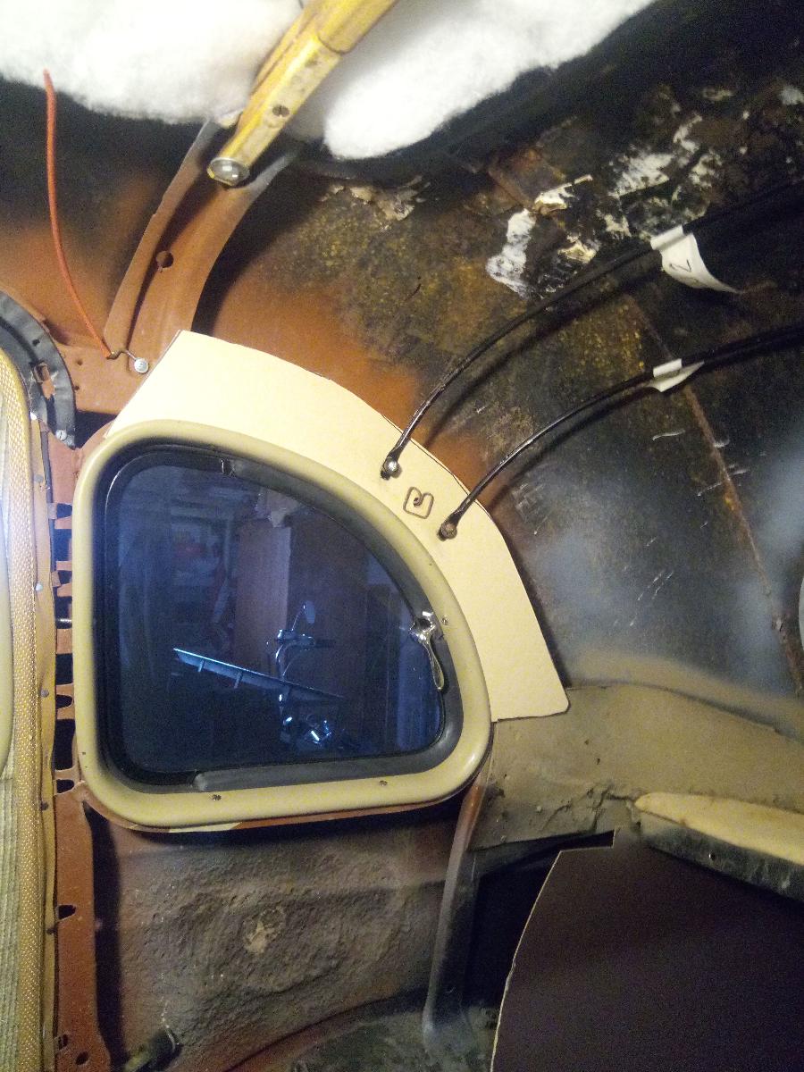

does the quarter glass need to be out to properly install the headliner in same way as the rear window thanks Brian
kubes40 |
08-31-2026 @ 9:26 AM
Posts: 3674
yes indeed.
trjford8 |
09-02-2026 @ 7:06 AM
Posts: 4407
No need to remove the glass, just the garnish molding.
square nutz |
09-06-2026 @ 6:56 AM
Posts: 18
Joined: Mar 2024
Thanks for replies hopefully the headliner is going in next week
kubes40 |
09-06-2026 @ 10:33 AM
Posts: 3674
TRJ is 100% correct. You don't need to remove the glass. I remove it so I can get more material glued down in that area. I've never had an issue but my gosh, if the liner became lose there, I'd not be happy with myself.
