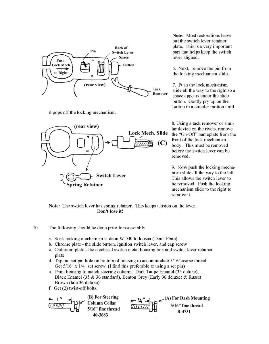

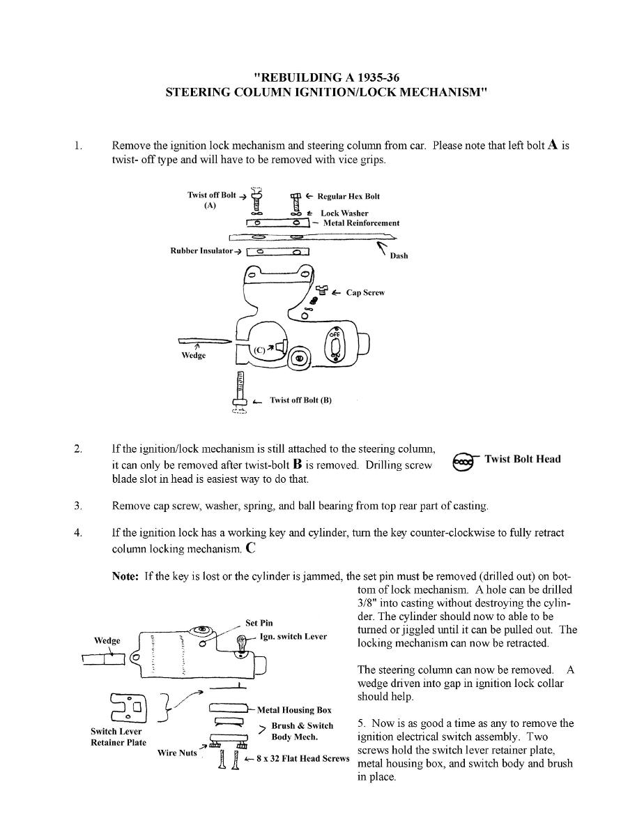

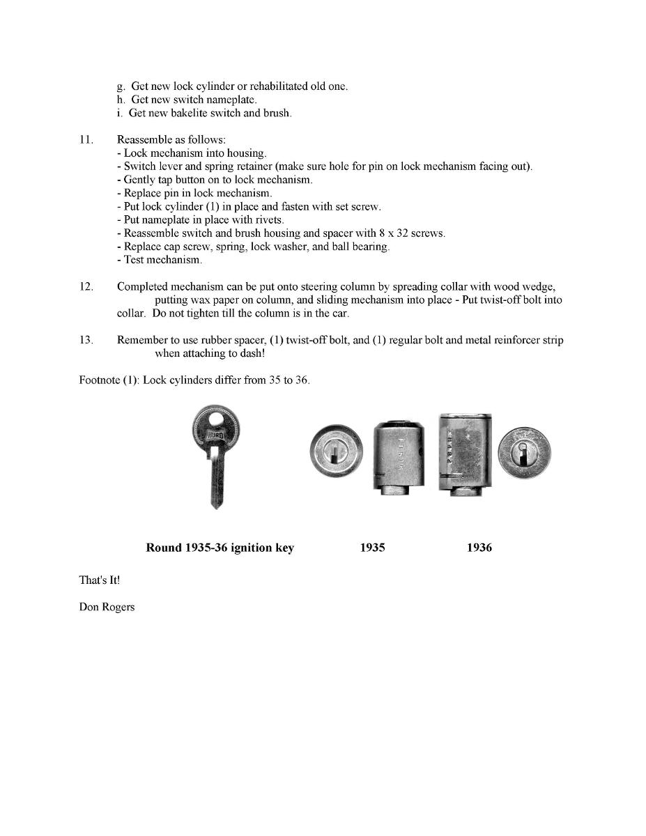

Don Rogers
04-25-2026 @ 7:27 AM
Posts: 518
The following images might be of some help
funfordjack
04-25-2026 @ 12:12 PM
Posts: 3
Joined: Mar 2022
Don, Thanks for the illustration drawing outlining the disassembly of the switch.
After reviewing the drawings, it appears very straight forward with patience.
Step 6 refers to remove the pin from the locking slide shaft. I understand the purpose for pin. How firm is the pin held in place and what procedure and tool do you recommend for removing the pin without damaging?
04-26-2026 @ 5:34 AM
Posts: 1816
The 36 lock cylinder has the name HURD imprinted in the front. The retaining pin is under the cylinder. The pin has to be drilled (Very small like 6-32 and very shallow) and tapped to use a puller to pull the lock pin out. The cylinder then can be removed. Typically the ignition lock cylinder also operates the door lock. They can be keyed alike by a locksmith.
