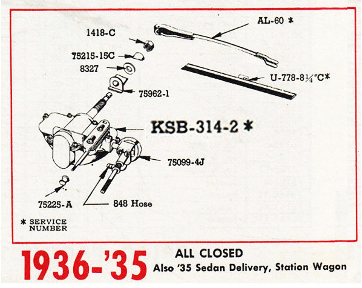

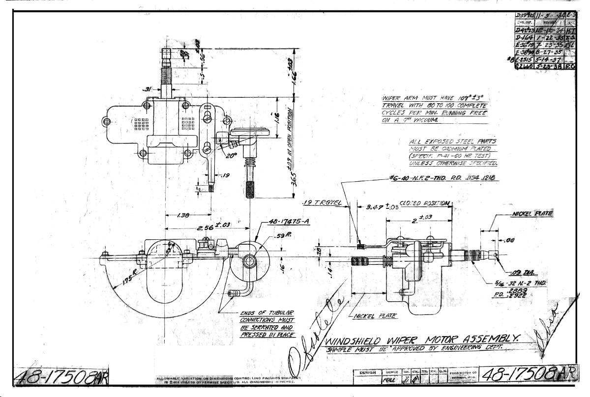

Here's a diagram of the wiper motor that you are looking for
square nutz
02-28-2026 @ 7:32 AM
Posts: 16
Joined: Mar 2024
Excellent technical diagrams. You folks convinced me and I did purchase the one I had linked above should receive next week. Thanks for replies.
