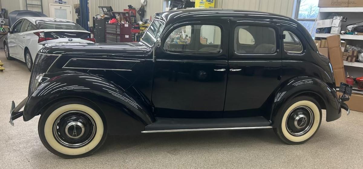

After having had 5 Model A's and one Model T I decided that I wanted to get something that would be a little more drivable on todays modern highways.
Last Friday I brought home a 1937 Fordor that had been stored in a climate controlled garage work shop for it's entire life. The car is all original except for the paint and it has absolutely no rust anywhere, even the undercarriage has the original black paint with no rust. It has Engine and frame matching numbers and the 3 owners only drove it 37K miles. The owner that I purchased it from had the car for over 26 years.
I would like to know from the Club Members what would be the most practical upgrades that I should do to make this car a daily driver? I have an aircraft Mechanic who retired as a Mechanical Systems Engineer from the Shuttle Program after 36 year so I would consider myself to be a pretty mechanically inclined person who would be doing most all of the work myself.
Some of the modifications I'm considering are:
1. New tires, actually just ordered 4 Diamondback Auburn Deluxe All-Season Whitewall Radial Tires and I plan to order some new Radial Tire tubes and new rim strips.
2. Electronic Ignition, I could most defiantly use some help with a recommendation for the best and most reliable.
3. 12 volt conversion, again need some help with recommendations for best conversion. Replace 6v Starter?
4. The car has a new gas tank with an electric fuel pump. I know nothing at all about these flathead 85HP V-8 engines but the previous owner removed the mechanical pump; should I buy a mechanical so I have both electric and mechanical??
5. Turn Signals, any recommendations for best kit?
6. LED Lights?
7. Duel Exhaust?
8. Glass replacement. The car does need all new glass, any recommendations? I did find an eBay company, Bob's classic Auto Glass?
9. DE sludge the engine? I changed all the fluids and the oil looked pretty clean, not dark or black at all. I figured with only 3 owners and 37K miles how bad sludge could there be?
10. Should I install an oil Filter?, this car never had one.
Sorry for all the questions, just very excited to get started on this car.
