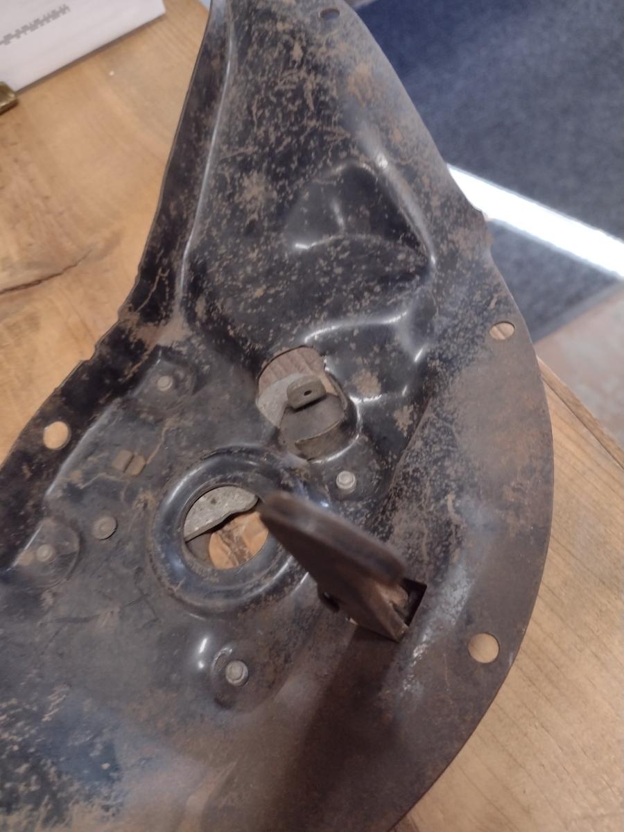

Take a look at the picture from the above post. In the lower right you can see what looks to bed a 'hook'. I believe that is keeping your hood closed. If you can get something to push the hook back towards the firewall the hood should be free to be opened.

Joined: Nov 2012
As our editor shows, you need to press on the release to allow the hood to open. What will work is a very thin, 1/8", 3/16" max and long flat blade screwdriver. I used a couple of shims, the type you use when installing new windows to raise the hood. Do not jam them in but just enough to allow you to shine a light into the release latch area. Slide the screwdriver in and press, this should do it, I've done it. Now when the hood is open you need to find out what is causing it not to open. Let us know how it turns out
