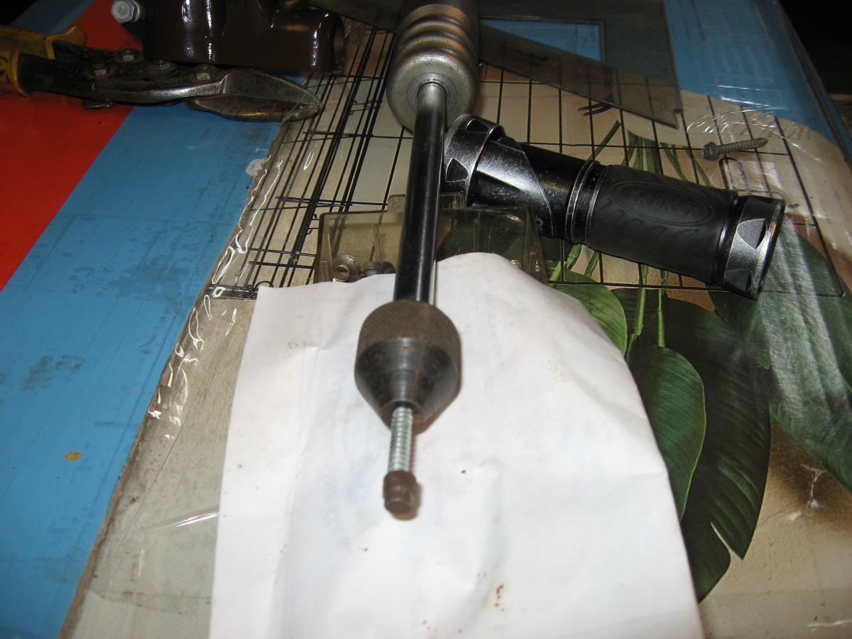

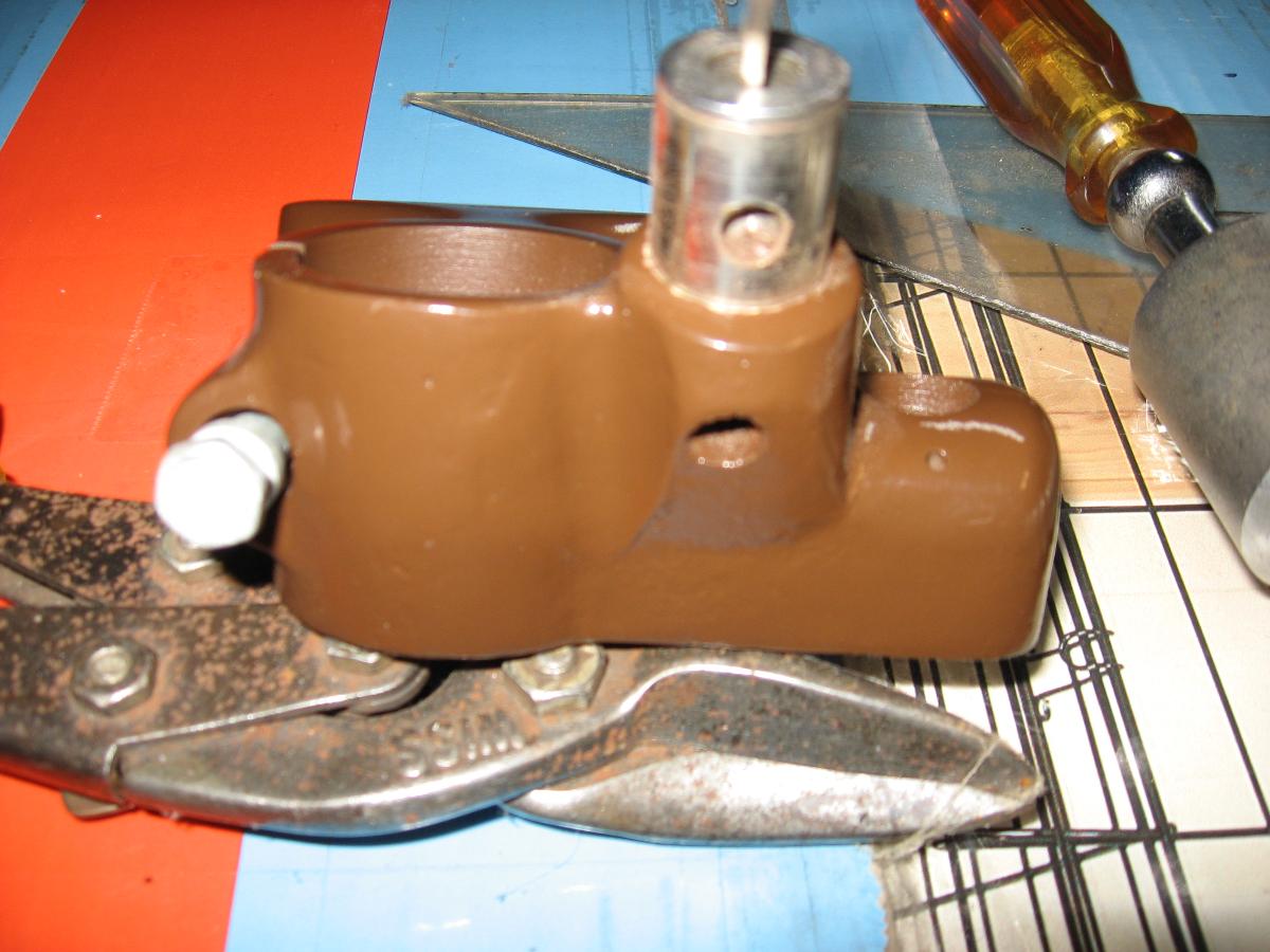

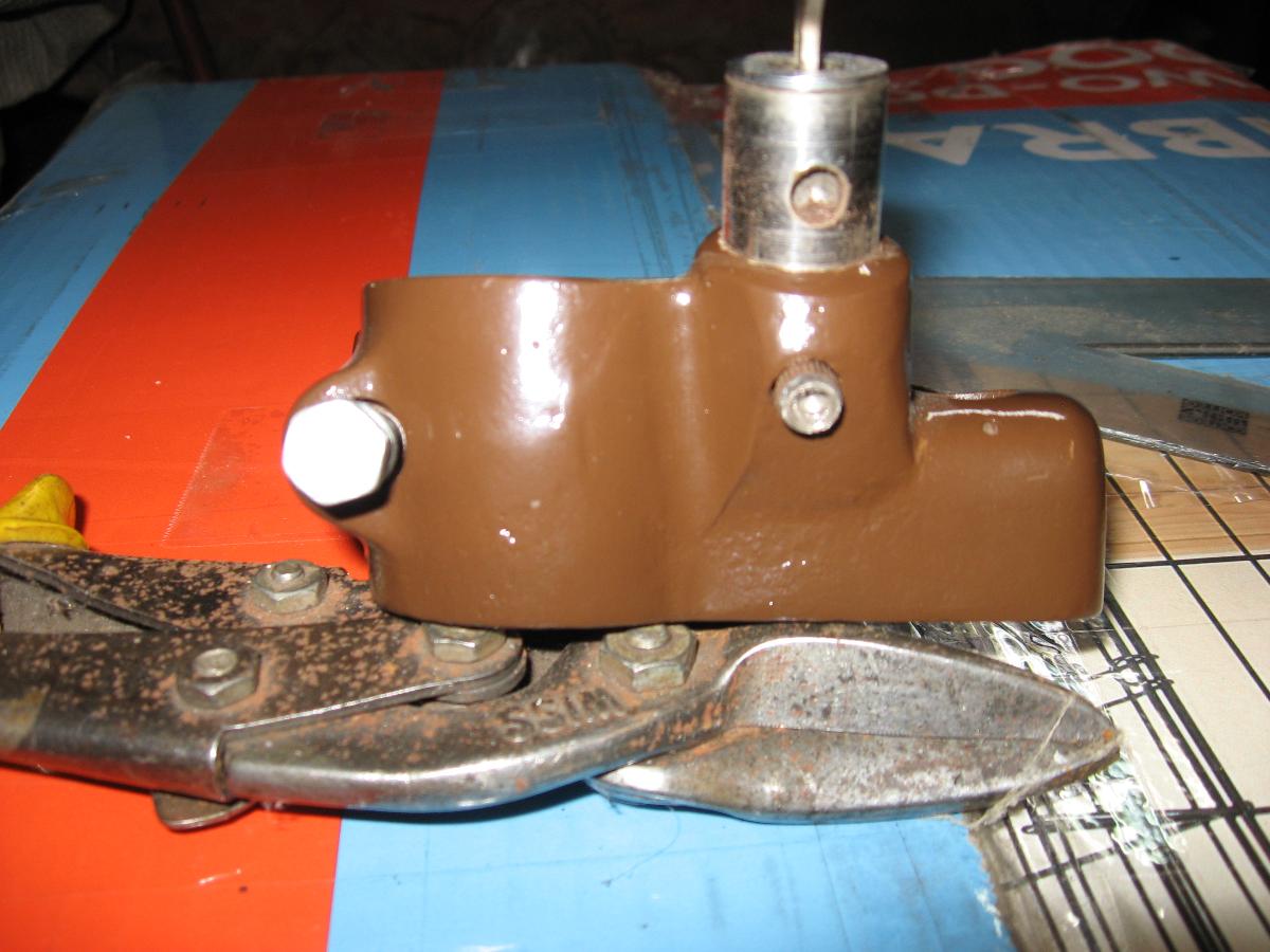

The lock cylinder can be replaced without dismantling the housing or removing it.
Bottom of the housing is a small, serrated plug that holds the key lock. You can drill a small shallow hole in the plug and use a sheet metal screw in a slide hammer to remove this plug and pull out the lock cylinder. When I did mine, I drilled and tapped the hole and use a small Allen wrench plug to replace and allow easier future removal if needed. First photo shows the lock out and the plug almost out. The second photo shows the plug removed and the third photo shows the sheet metal screw on the slide hammer.
