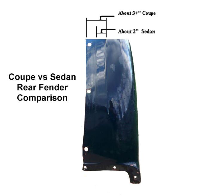

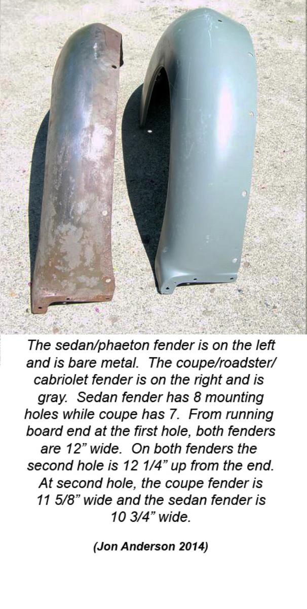

Don Rogers
09-09-2025 @ 7:37 AM
Posts: 512
Here's some comparisons that V8er and I put together a while ago
wlzemke
09-09-2025 @ 7:46 AM
Posts: 38
Joined: Jan 2024
Thanks Don for taking the time for all the great images and explanations. Thanks everyone in the forum I now know what to look for. Bill
