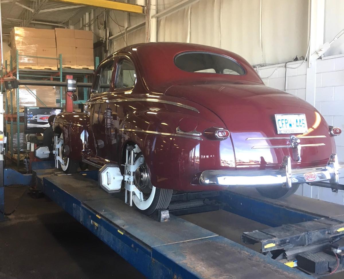

I took my '46 Super Deluxe to the local Ford Dealer, the Shop Foreman had to check if there was clearance on the wheel wells to mount the alignment devices on the rims, and all was good to go. The Alignment Tech had to convert the toe in inch spec. that I provided to degrees, and job done.
