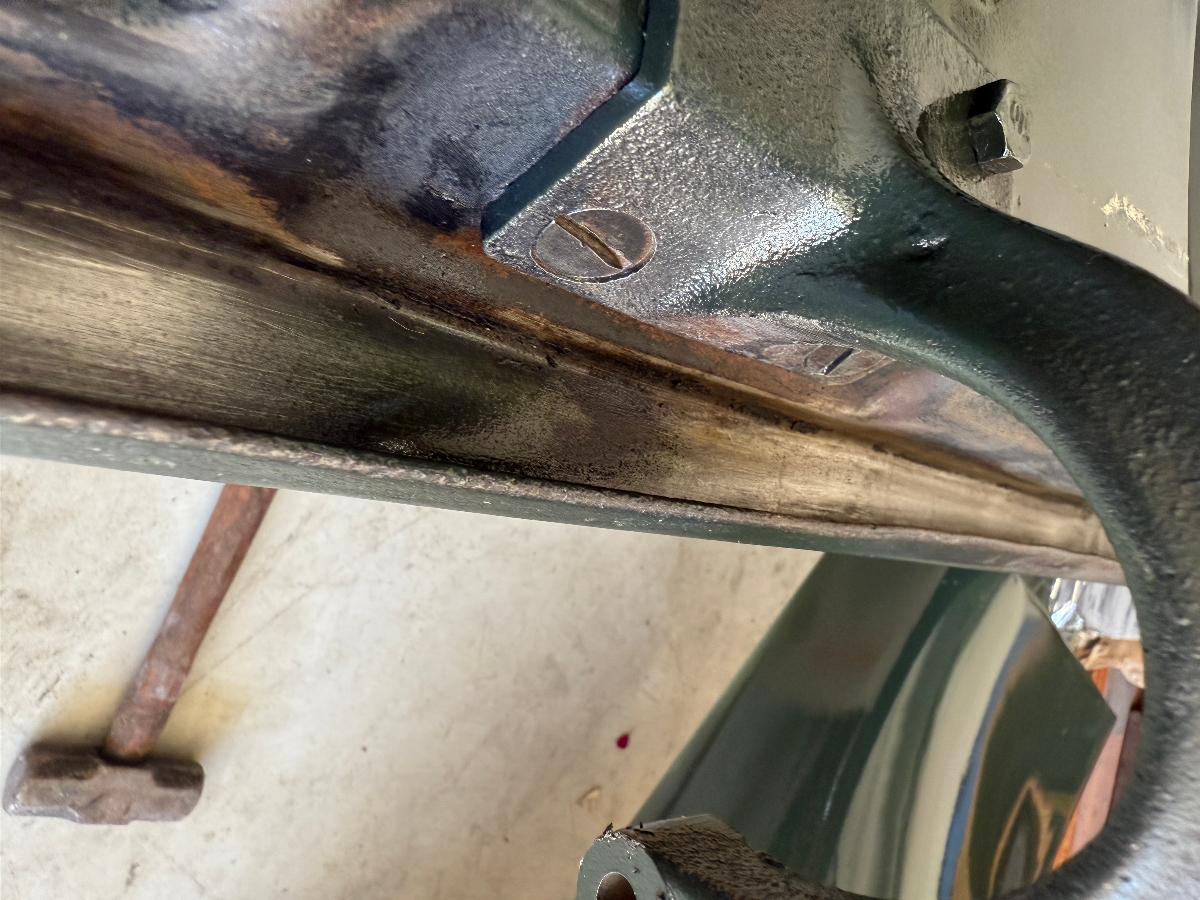

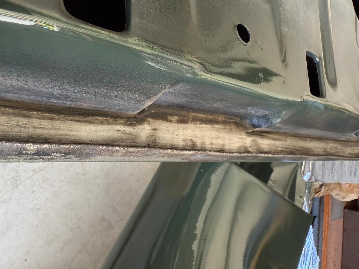

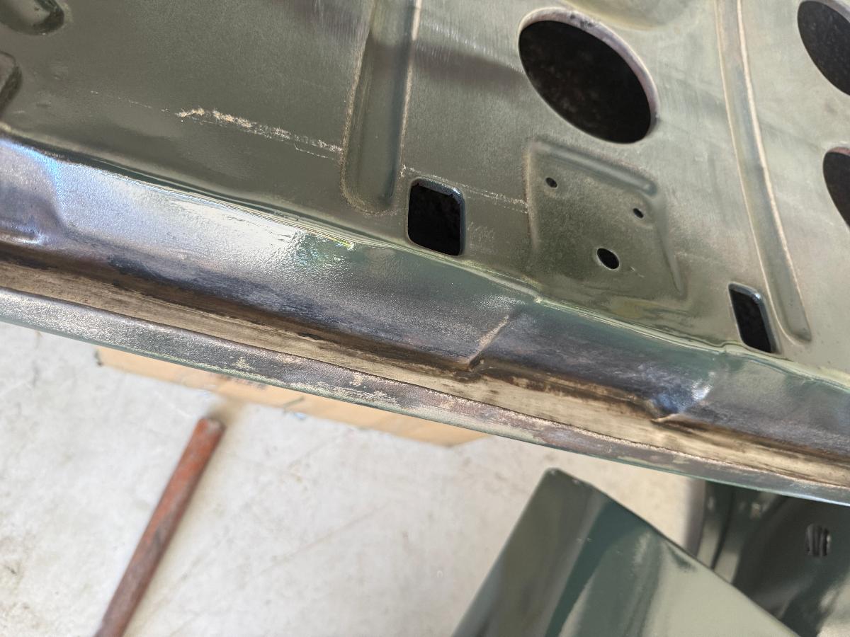

Here is what I’m talking about. Being that I have had this car for 65 years it wasn’t done by me.

The edge is bent in. It should be straight and go straight down.
