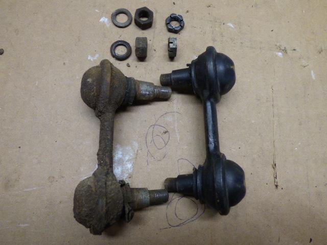

Hey Don,
In my experience, it appears the shorter stud links didn't go into production (assembly) until very early in 1939 or perhaps as early as late 1938.
Of course, who really knows when each and every assembly plant started using them.
The shorter studs were designed to eliminate interference with the sway bar introduced in 1940.
I have attached a photo that I hope depicts the early vs. late links and associated hardware.

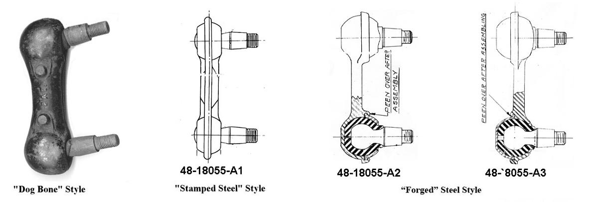

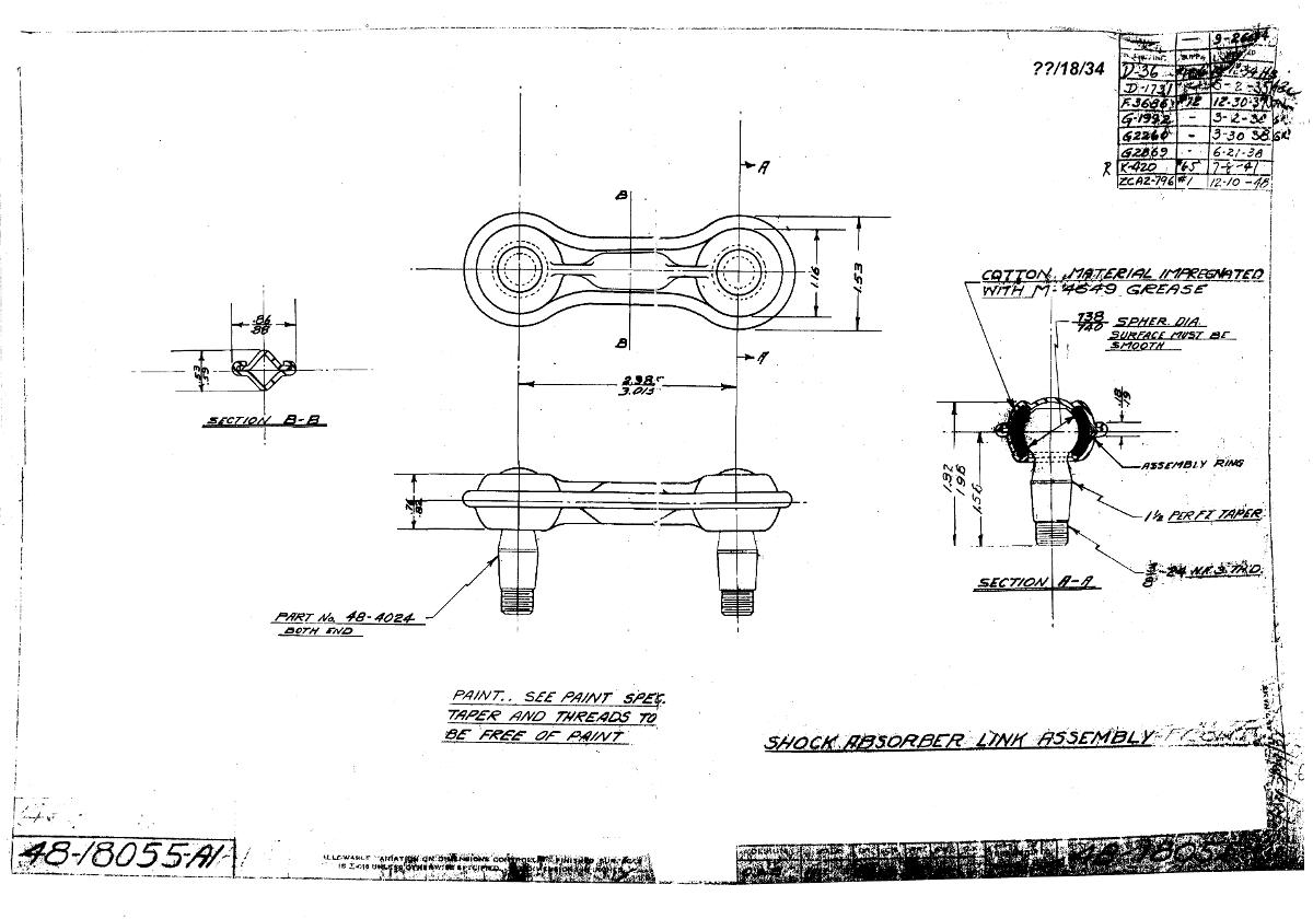

Mike pointed out something that I missed while writing the 35-36 Ford Book. The threads in the ball studs were shortened after 1he 35-36 model year. A close look at factory drawings indicate that the drawing were changed on 12/30/37 to show the shorter thread length.
The drawings also show that the stamped steel link was designed in late 1934 to be used on early 1935 models and later and that the forged links did not make an appearance till about June of 1935.
The images show a stamped link on an early 35 chassis, a link comparison, and an early 48-18055-A1 drawing of the stamped steel link
