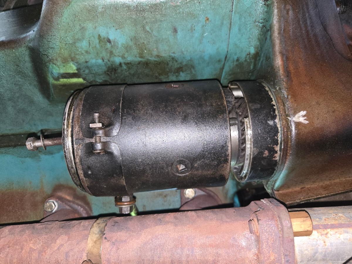

Both nuts I located were not for the starter. The correct starter nuts were located at the starter endcap. After they were loosened the starter housing started to pull out very easily. The problem is the armature would not come out. Is the bendix gear locked in with the flywheel? If yes, how do I remove? Lower the car back down and rock it, in gear, to hopefully free the bendix? The attached picture shows the bolts loosened, stater housing pullled out and the armature. Is the something else I am missing?
Thank you from a novice.
Ray

Since you already have the starter mounting through-bolts loosened and the starter still won't come out, try hitting the sides of the portion of the starter housing that is stuck to the bellhousing with a rubber hammer to loosen it. Be gentle with the hammer blows and try using some penetrating oil to loosen the stuck part of the starter housing to free it.

My guess is that the Bendix spring broke thus your starter will not engage the flywheel. The aluminum end piece is stuck to the bell housing. Try to hold the starter together in one piece. Like Car Crazy said tap the stuck part with a hammer to get it loose. The armature and Bendix should come with it. You may have to wiggle the starter a bit to get it passed the flywheel.

Typically the end plate comes out of the oil ban with ease. Do tap on it with a hammer.

40 Coupe, I've applied penetrating oil to the housing connected to the bell housing. I tapped the housing and it did not break loose. I also rocked the car while in reverse and also in first. No luck freeing the bendix. What am I missing here?

Hit the starter end plate hard with a hard rubber mallet, if you can get it starting to come out you can use a pry bar to help it out of the oil pan housing. With the starter body off and the two long bolts removed, there should be nothing to prevent the armature and starter end plate from becoming loose.

Possibly the stamped steel cover on the other side of the oil pan may come off, if not you may have to remove the oil pan to prevent further damage.

If the bendix is hung up on the flywheel, the procedure to free it up is to put the transmission in 3rd gear and then push the car backwards. Just rocking the car may not free it up, because you will not be turning the motor enough. If you can push it and the motor turns over, the bendix is not hung up. Get some help as it is difficult to push the car when it is in gear.

when you get the starter out, make sure you rotate the engine and check the ring gear. it might be worn causing this problem
when pulling the starter out you may have to angle it to remove it,
you might have to take the starter apart , where it is,
and put back together when it is out,
if you have a enoscope you may want to use it to s
see what it is hangine up on,
I never heard of not being able to remove a starter.
let up know how you made out, with a update,
