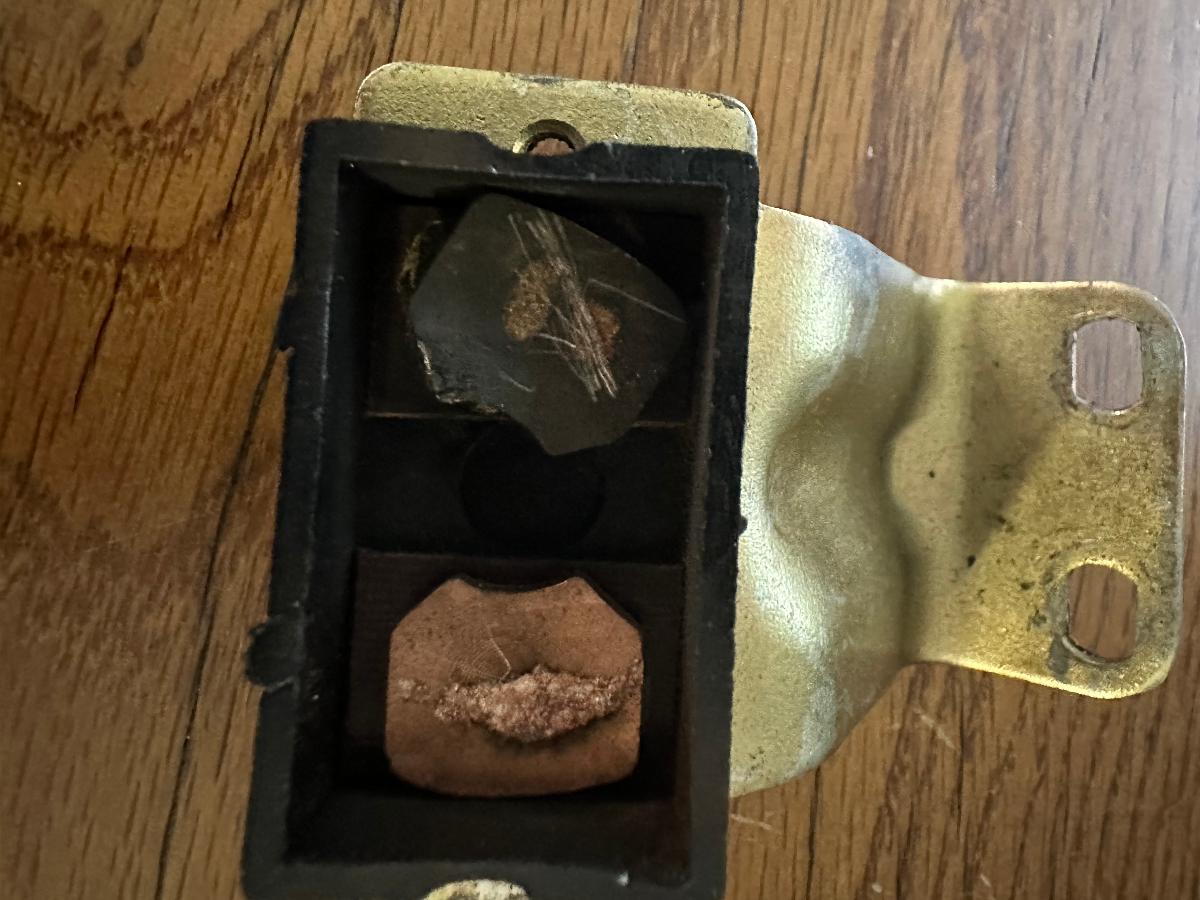

Update:
I decided to remove and take apart the floor switch. I cleaned all of the copper surfaces and carefully reassembled the unit. I reconnected the battery and starter cables. It now works like a charm!
The 6V starter spins so much faster than before. New question- should I install a 12V starter?

Per the 1936 Electric Diagram you should have a yellow wire attached to the battery side of the switch on top of the battery cable. This will run power to the ammeter, then to the fuse block and on to the ignition. The lights have a another wire running from the fused side of the block.
The wire leading from the starter side of the switch should only go to the starter. Be sure the cable ends are not touching any part of the switch other than the lugs.
If the above is correct I suspect you have a bad starter switch. Is the starter side lug touching the side of the switch? From your photo it looks like the one contact is twisted maybe contacting the inside of the switch housing. Check to be sure there is no continuity between the lug and the case of the switch.

I am picking up the power for the lights from the battery side of the ignition switch. I disconnected the starter cable from the switch and it still sparks when I depress the starter switch. So, bad switch?
Should I just install a starter solenoid and starter button? It would probably be a safer option
I just took the starter switch apart. The battery contact is very dirty. Perhaps that is the source of the sparks. I ran the continuity test on both sides of the switch - no contact with the housing everything is insulated
