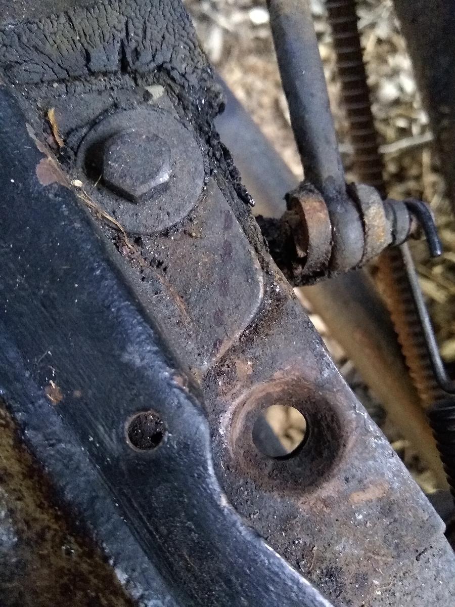

Mike...planning to do exactly that, but for a different reason. It seem the angle the steady rod takes from the engine boss to the frame dimple cuts across the edge of the floorboard. In the photo the dotted line was hard to draw accurately and is a little too far into the floorboard. My hope is that I can nudge the engine/trans unit over enough to eliminate the floor board intrusion from the steady rod path. Right now the steady rod will not sit down in the frame dimple due to the floorboard.
What is the purpose of the notched washer? Does it simply tighten the tolerances of the bolt to the steady rod? And what retains the steady rod/washer/bolt in the frame dimple? Is there indeed a bolt on the underside of the frame dimple? Thanks for the help!

Thanks for the photo. Okay, I am, 99% certain what the issue is. The rods will work without modifying them or the floor. I hate to say it but perhaps the best way to go about this is to unfasten the front engine mounts and loosen the rear (transmission) mounts. Jack the engine up a little in the front. Insert rods. Get the bolts inserted through the frame. Let the engine rest back down upon the mounts. Tighten the rods fully. Secure the four mounts.

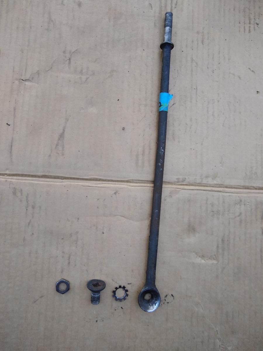

It looks as though if I cut off a small section of the floorboard right next to the dimple (dotted line), I might get the beveled bolt of the steady rod inserted into the receiving dimple. I've attached a photo of what came off the car, but the nut on the left is from my inventory. I don't remember anything falling down to the concrete and haven't found anything where the car sat during the steady rod removal. It's possible in the battle to remove that beveled bolt that I somehow missed it. But It sure seems there must have been a bolt underneath that holds the beveled bolt in place because the frame isn't threaded, right? Anyway, thanks everyone...
Mike...they look to be the right length, but the floor board is raised about the frame dimple and the rods pass above the frame...
This message was edited by MICHV8 on 4-24-25 @ 3:45 PM

Mich, these can be a PITA to install once the engine / transmission is installed.
If your 59A block has the holes cast in for the rods, the rods should fit.
Are you simply having a difficult time installing them or did you install them, and they are too long?
