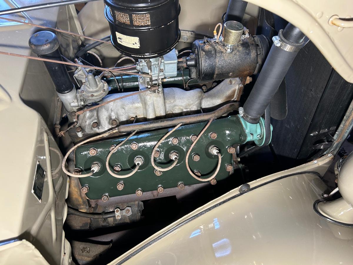

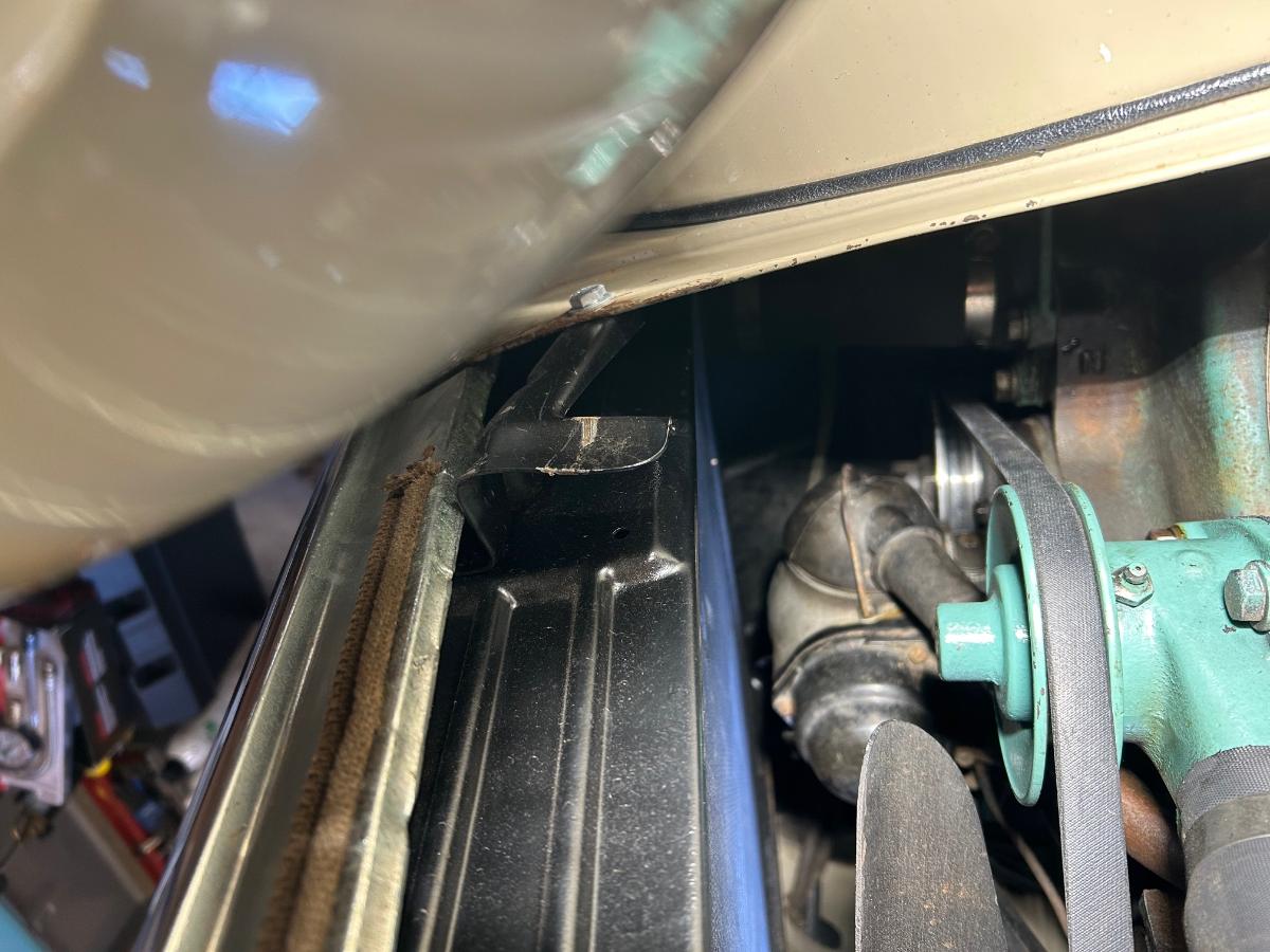

Just got this last summer. It starts easily, runs at low RPM well but when I gets up a little in RPM, it seems to hesitate and not want to rev higher. Fuel, tank, electric pump all good. Carb seems new and good but unknown. See images.
1. Possible/common issues related to symptoms?
2. First thing to check and next?

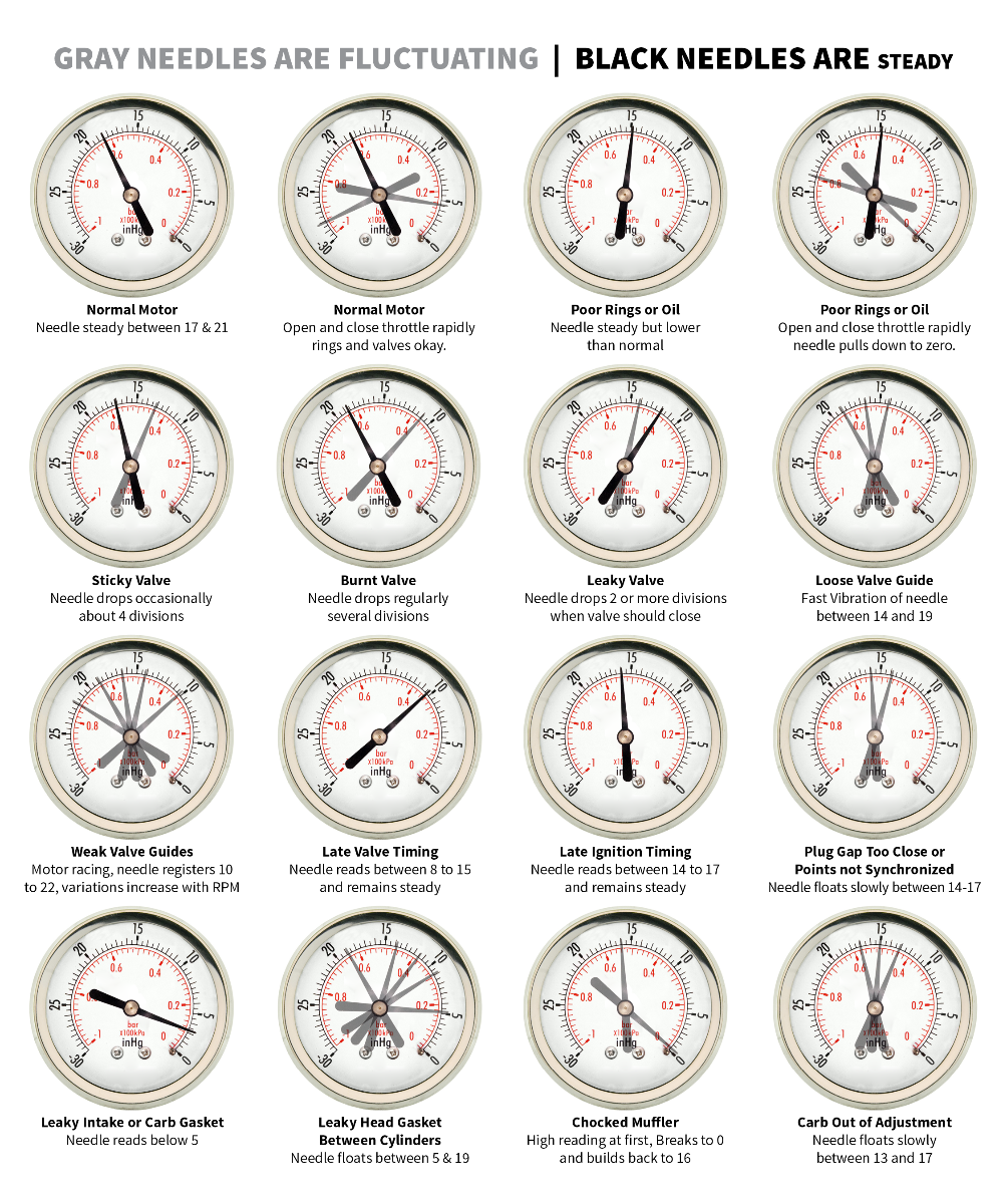

To better pinpoint your problem, use a vacuum gauge to determine if you have a healthy engine - reading should be steady and about 19" during idle at sea level.

Check everything CarCrazy suggested. Can you post another picture from the drivers side of the engine?
It looks like you have a later model fuel pump with some dubious rubber lines. You may need to check the amount of fuel being received at the carb.
Bits of rubber line or rust from the fuel tank can restrict the jets and internal passages in the carb. The car will idle but not have enough fuel to accelerate or run at cruise speed.
I have seen some replacement carbs with very small jets (#36). You should have around a #49- #51 jet.

The photo that shows the coil shows the coil to look very old. All my V8 Club members have had Skip Haney in Florida rebuild our coils.
If your coil is not rebuilt, or you don't know, get a rebuilt from Skip. My V8 starts with a touch of the starter button even in 90 degree temps.

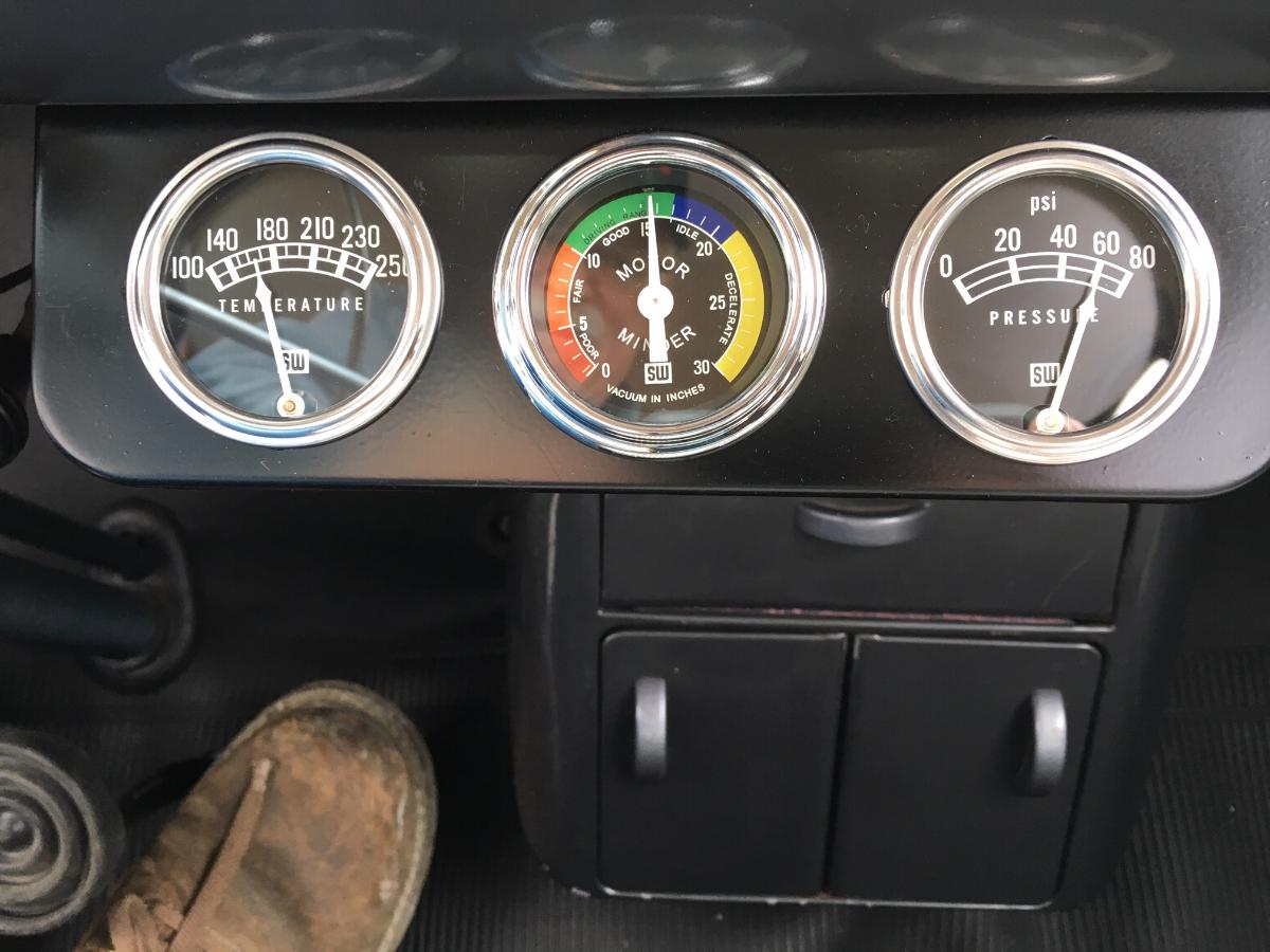

All good suggestions noted above. Generally, if an engine just "runs out of power" under load, the issue is fuel related. If the engine is "running rough" then look at ignition/electrical items. Vacuum gauge readings is an excellent troubleshooting tool. I have a "Skip" coil and a "Tubman" capacitor on my stock 59AB engine in my '46 Coupe, with thousands of miles travelled and great reliability. Also, I had Charlie NY rebuild my carb and fuel pump. He corrected two issues that were causing poor performance, them being; wrong sized main jets, and the fuel pump discharge pressure was too high. He corrected both, and ran the pair on his test engine before returning them. Bolted them on and didn't even need to adjust idle speed or idle mix screws.
Pictures:
Vacuum Chart Vacuum at Speed Vacuum at Idle
