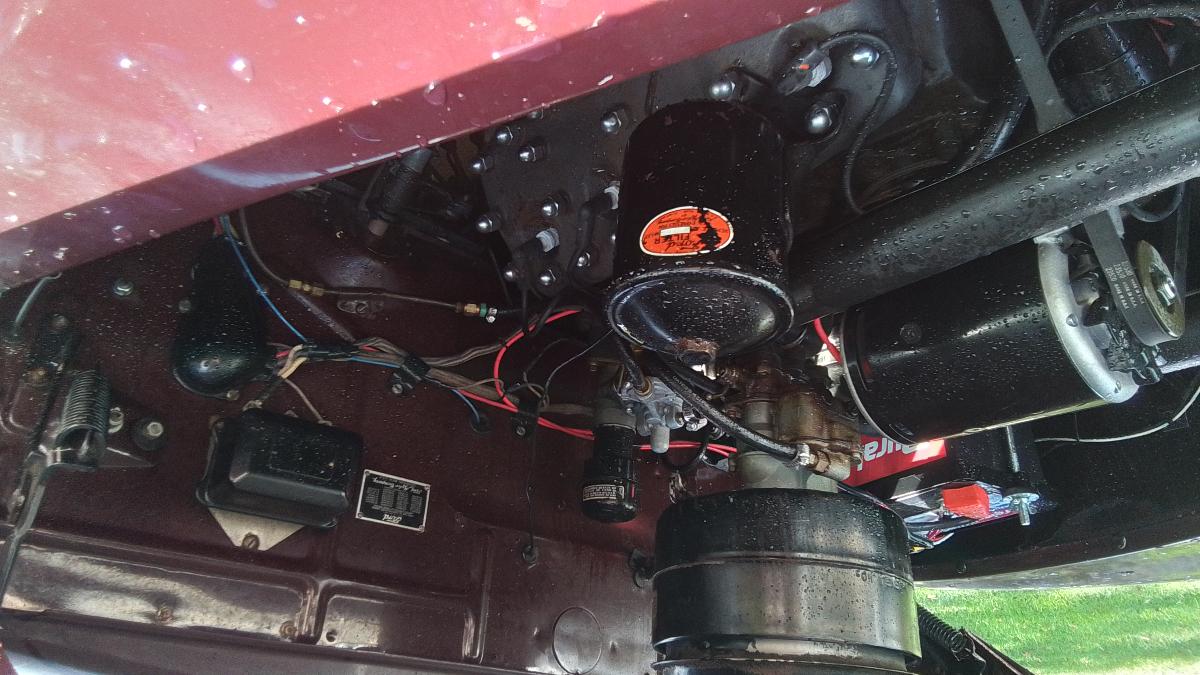

There is a rear seal, but they do have a tendency to seep a bit. The hole in the bottom of the housing allows oil to drain so the clutch doesn’t become soaked in oil. The cotter pin in the hole moves around and keeps the hole from getting plugged. Someone once said that old Fords are like dogs, and they like to mark their spots. I noticed you have a Powermaster alternator in place of the standard generator. I have a 6V + ground on my 59AB in my ‘46 Coupe and it works well.

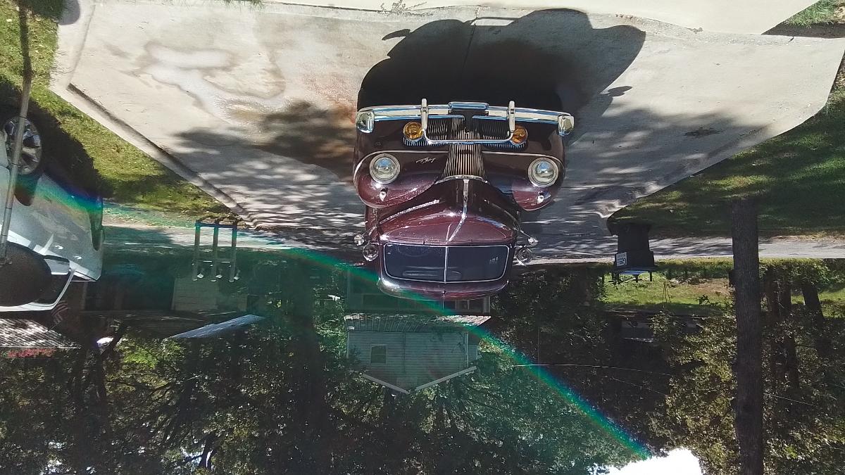

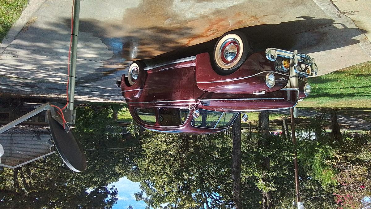

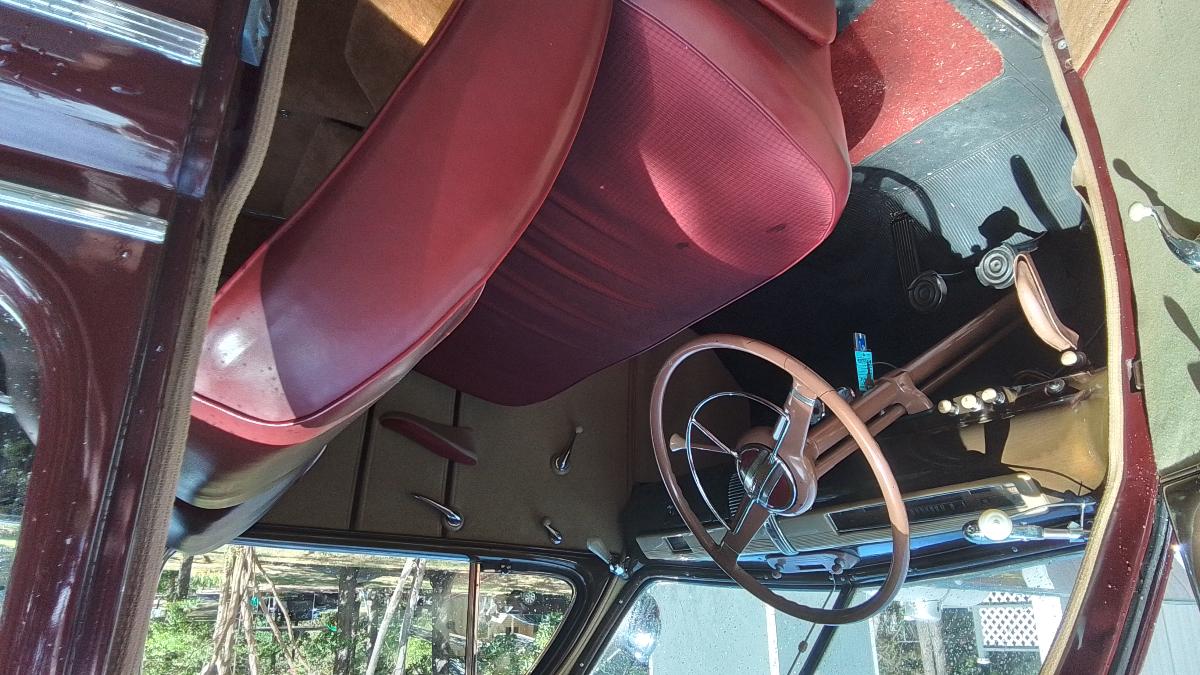

For some reason, your pictures posted upside down.

Yes I did a 12v conversion and added the pertronix electronic ignition. Starts right up every time.

Pictures: I noticed they imported upside down, I went back and turned them upside down before importing, but they still came in upside down, any ideas?

Apologize for the upside down photos.
We thought we had fixed that issue in our software. Apparently not.
