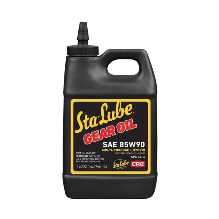

I looked for GL4 today at NAPA and other suppliers, did not find any. May have to order online.

Tractor Supply
They seem to be just about everywhere now.
They even have the gear oil recommended for Ford Tractors. Yes, those Ford tractors from the 1950's.

I checked TSC, I seem to remember them having it in the past, but an employee said they do not have any.

I bought a gallon of GL4 the other day at O'Rielly's. It is 140, seems they would make it in a multigrade, which I would prefer.

Mac Van Pelt has GL-4 in stock.
