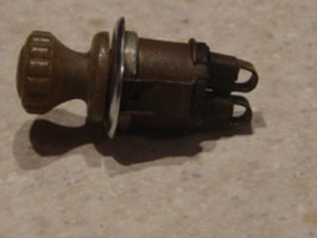

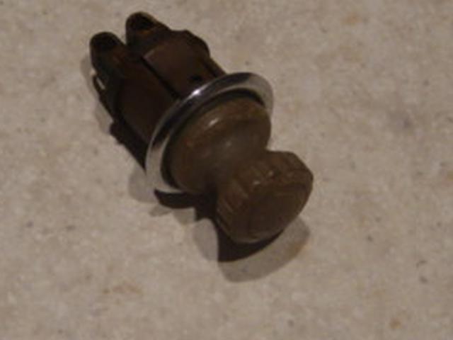

The dash light switch is at the top LH of the four holes, as you have indicated for 35. The switch operates reverse to the 36-37 dash light switch. They are very hard to find especially in operating condition. Suggest if you find any of the 35-37 switches just change the knob to 35 and live with the operational difference. Photos below are of the 37 switch, which varies from 36 by just the knob.

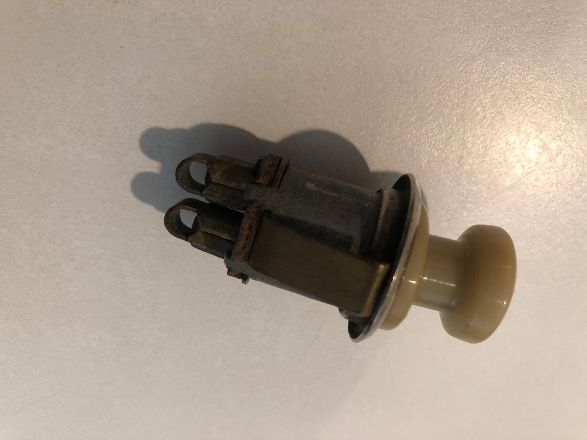

Howie1935
10-16-2024 @ 6:21 AM
Posts: 34
Joined: Sep 2024
Excellent information!
Thanks.
Dennis

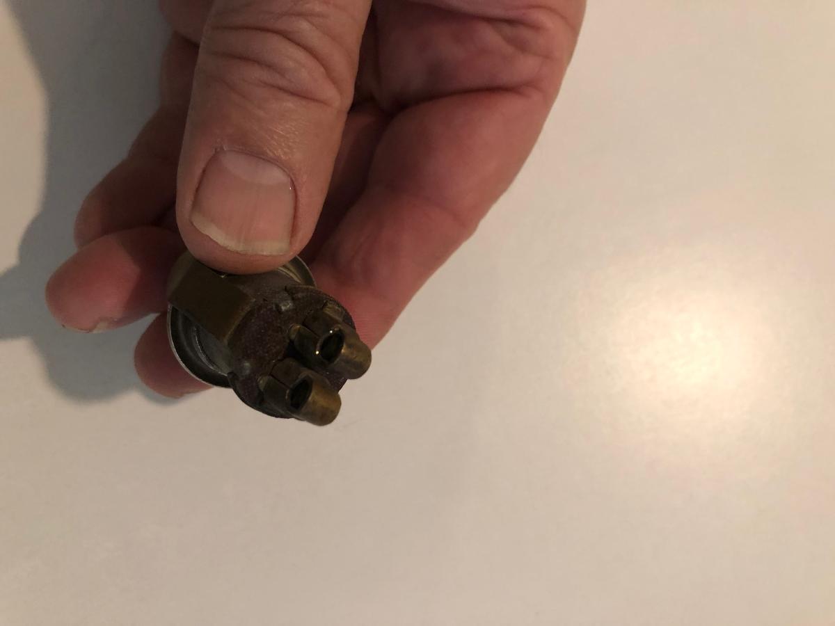

Howie1935
10-17-2024 @ 6:46 AM
Posts: 34
Joined: Sep 2024
I have a switch ordered but wrong knob. A friend says he can make one on 3D printer to match OEM.
We'll see.
Dennis
