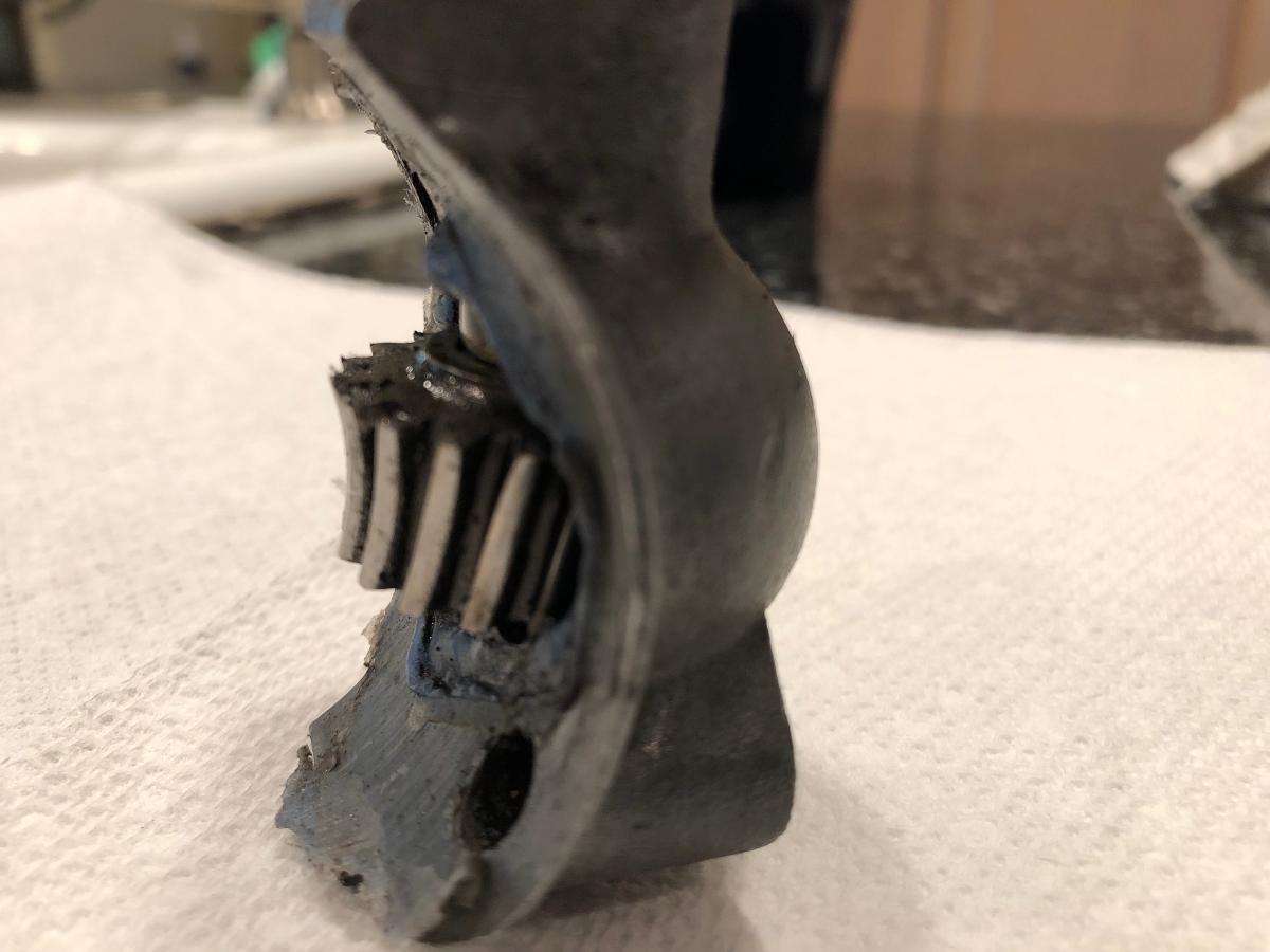

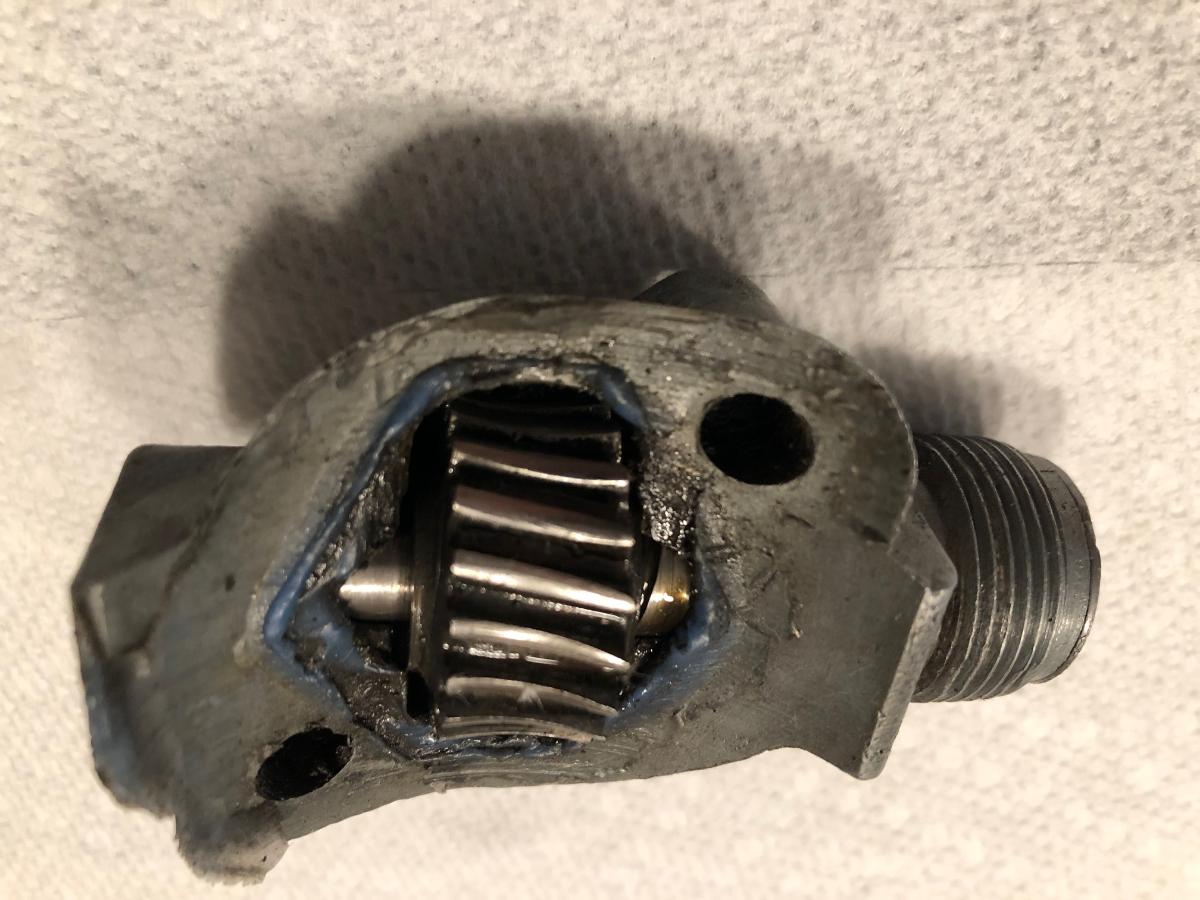

Thanks for response. Cable is intact, when I put a drill motor on trans end and rotate slowly, speedo works fine. It seems well lubed. I want to know a safe way to see if trans speedo gear is rotating when driveshaft is rotating.

Thanks. The driveshaft has a torque tube surrounding it, I can't rotate by hand. I was hoping you'd say I could rotate the wheel, raised on a jack and see the gear rotate. I'd need a 2nd person to do that. I'm reluctant to start and run in gear on a stand by myself and crawl under car to inspect. Any other thoughts?

To understand. 1. See if I can manually rotate gear once cable off. It should NOT rotate. 2. If it does rotate, remove two bolts to turtle and carefully remove without damaging gasket between turtle and housing of trans. 3. Remove gear and inspect or replace.

you could put into gear with out the motor running and turn the motor over by hand, a hand crank,
do a 1/8 1/4 at a time and inspect the driver gear, the driven gear is the housing that you took off,
see it any of the gears has damage,
use a good light and a mirror,
if it is the driver gear it is a big job, will have to remove the rear end, to get at that gear,,
let us know how you made out,
HOPE this helps,
37RAGTOPMAN, Maine

Put the rear end on jack stands. Take the trans cover off to get at the turtle. Start the car and put it in gear. You should be able to see it turn with the cable disconnected. From your description to date, I doubt if the turns. You can take it off and see if the gear on the driveshaft turns or examine the turtle and see why it doesn't The turtle should have a number on it (like 19 which corresponds to the gears in the turtle) or a gear ratio (like 3.79 which corresponds to the matching rear end ratio) If you need a new turtle start with a similar one.
