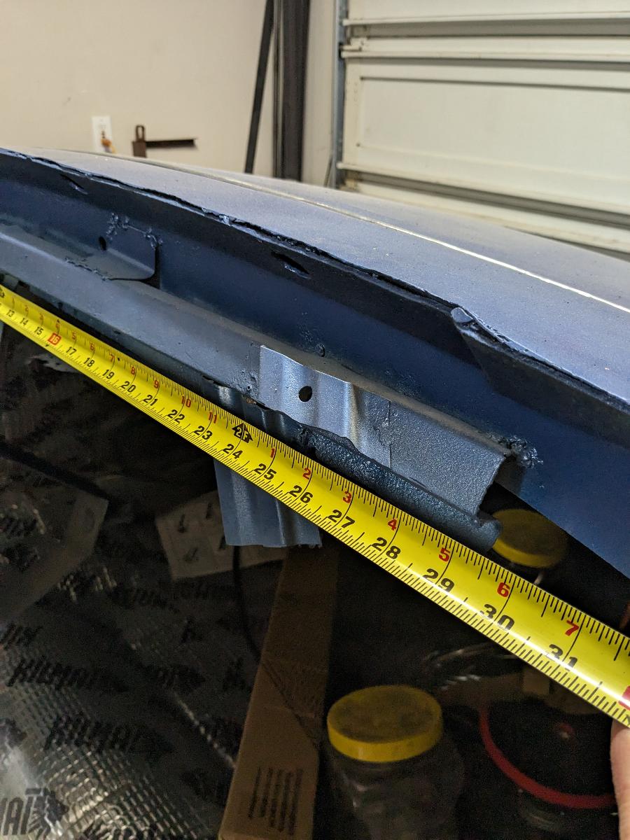

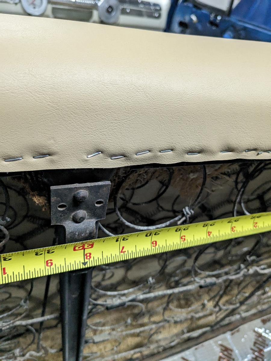

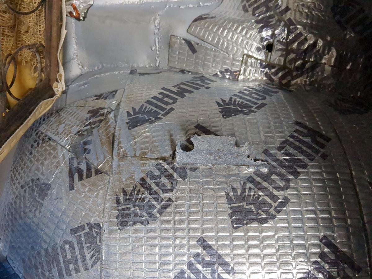

I have a '47 ford convertible I am slowly restoring. I bought it as the proverbial "bucket of bolts, but everything is there..." I'm at the point where I want to install the rear seat, but my re-upholstered upper seat doesn't fit where the mounts are. I'm pretty sure the mounts have been tack welded in the wrong place. It looks like the former owner was trying to delete the top and just mount the seat to the rear of the passenger compartment. Anyone able to take a picture of the stock rear upper seat mounts, with the top irons, so I can get an idea of what I need to fabricate?

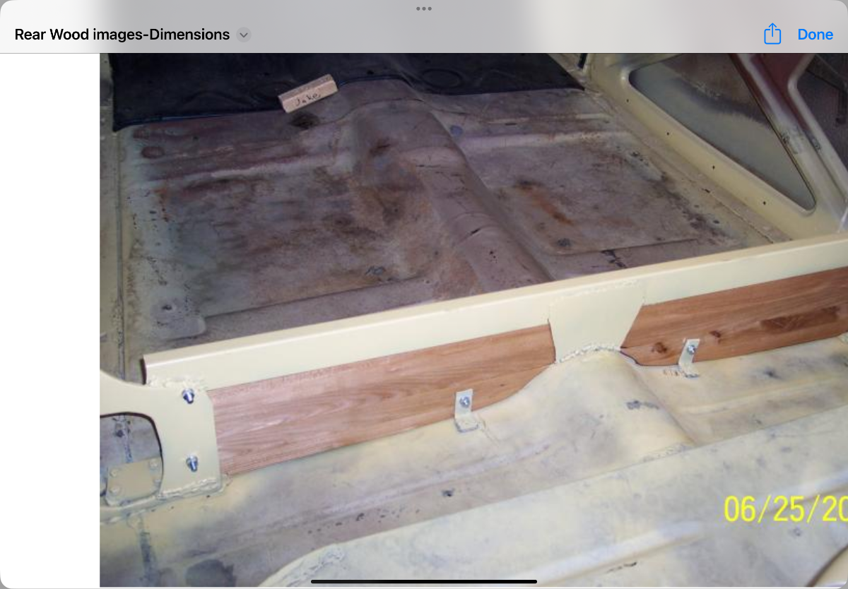

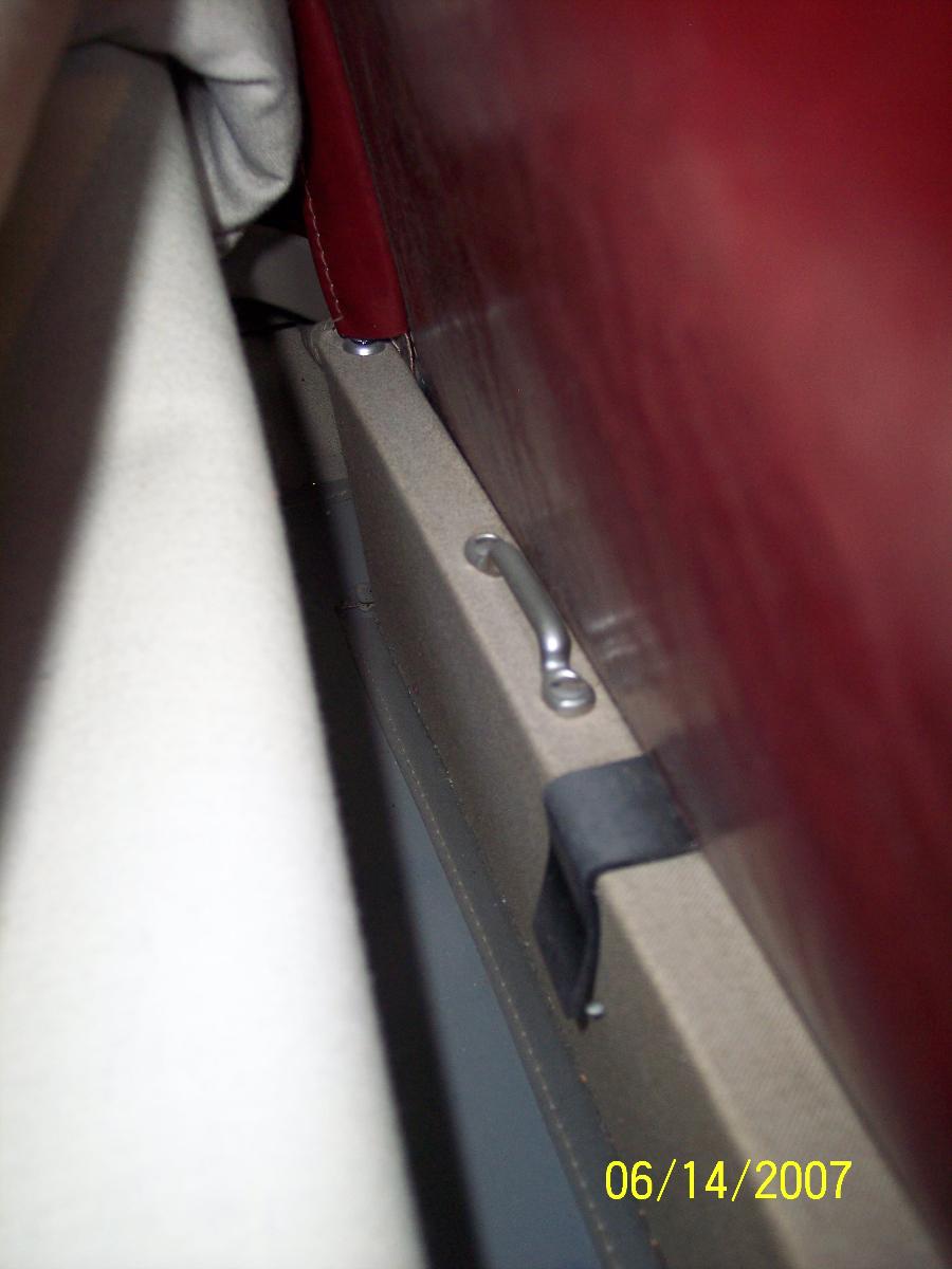

The rear cushion does not mount to the body , it hangs on the package tray with 2 hooks on back of cushion & the bottom bolts to 2 short brackets welded to floor. The tray is a piece of 5/8 plywood with a piece of 5/4 by approximately 3 inches mounted to the front of the plywood for the hooks.

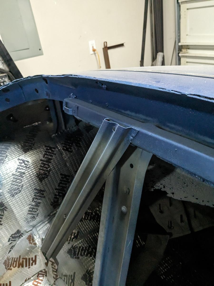

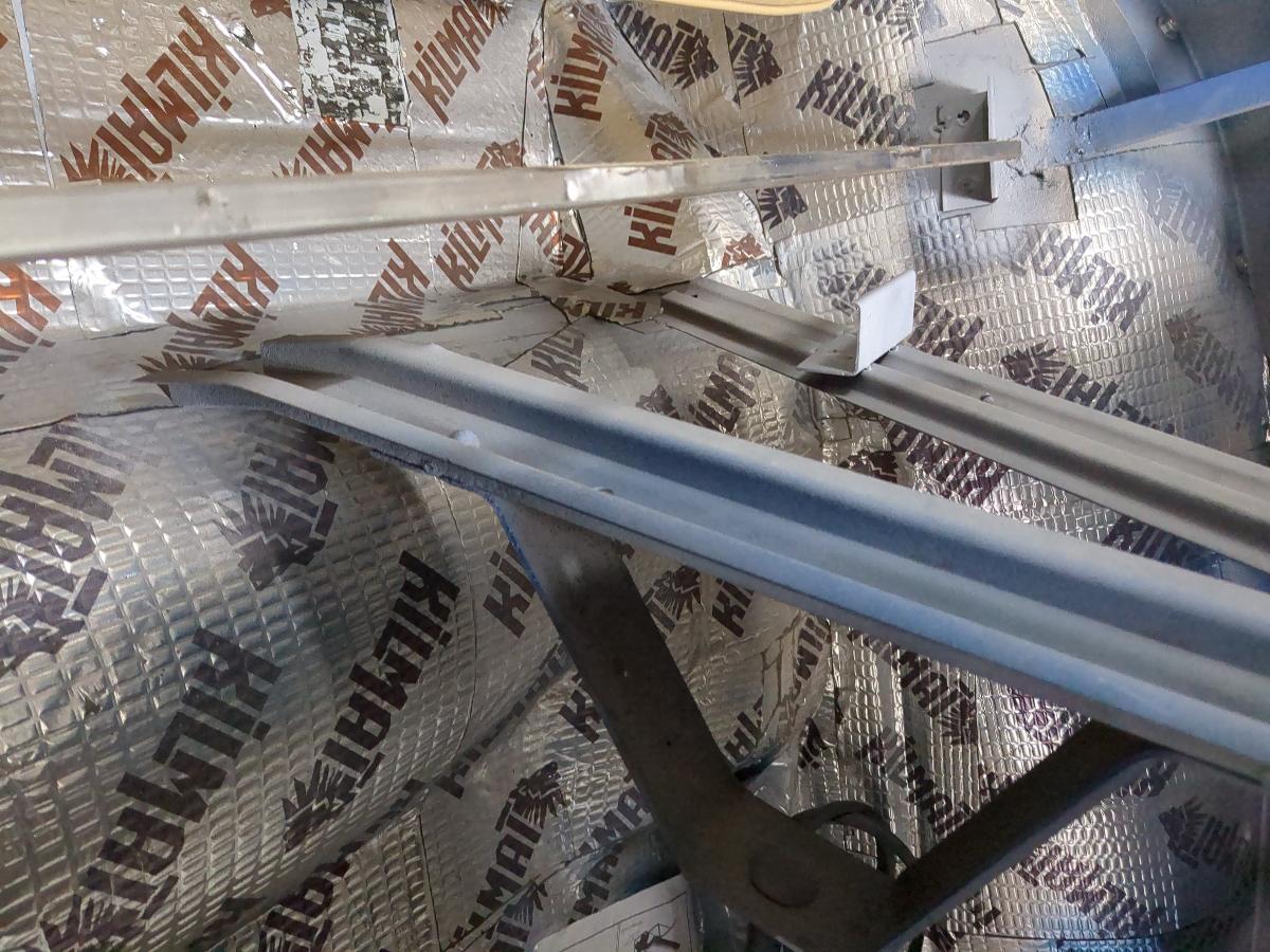

I can’t tell by the pictures but do u have the 4 brackets needed to support the wood shelve. 1 on each rear brace & 1 on each wheel well

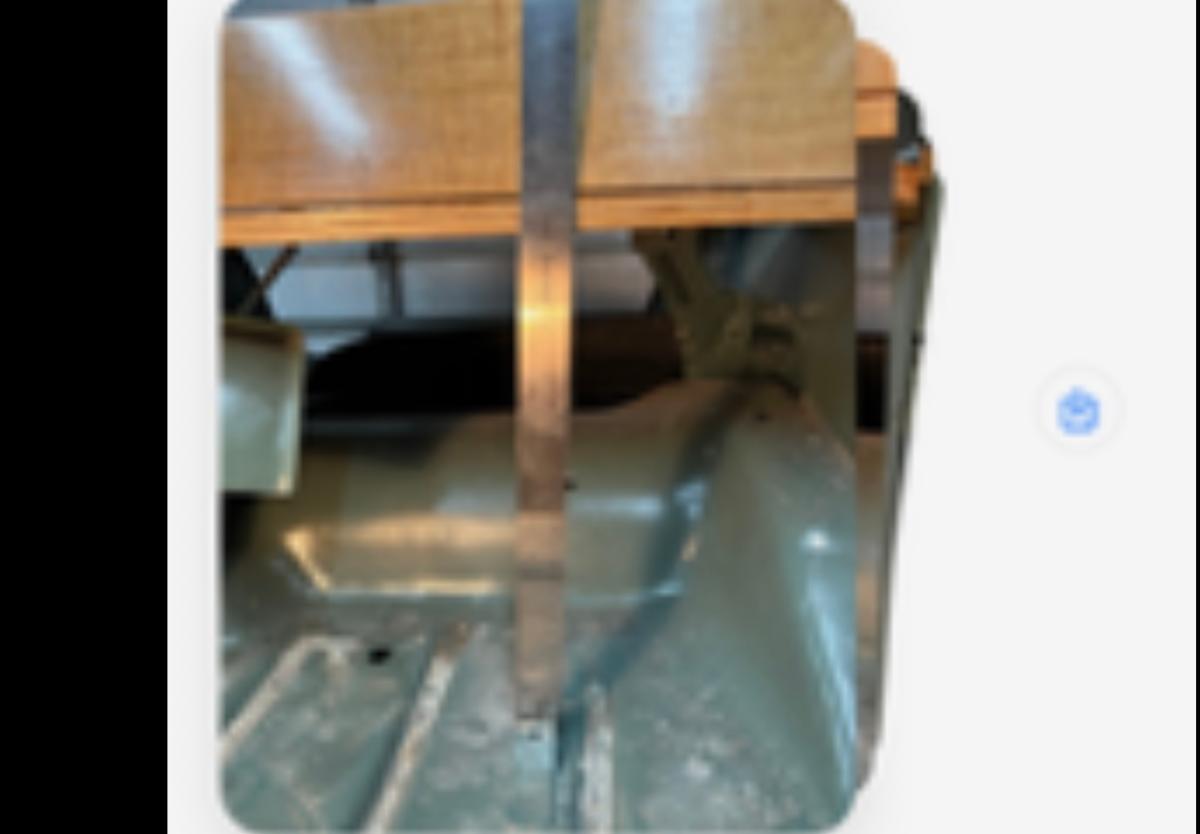

I have the remnants of some brackets on the wheel wells. The pictures I added shows the state of the rear braces.

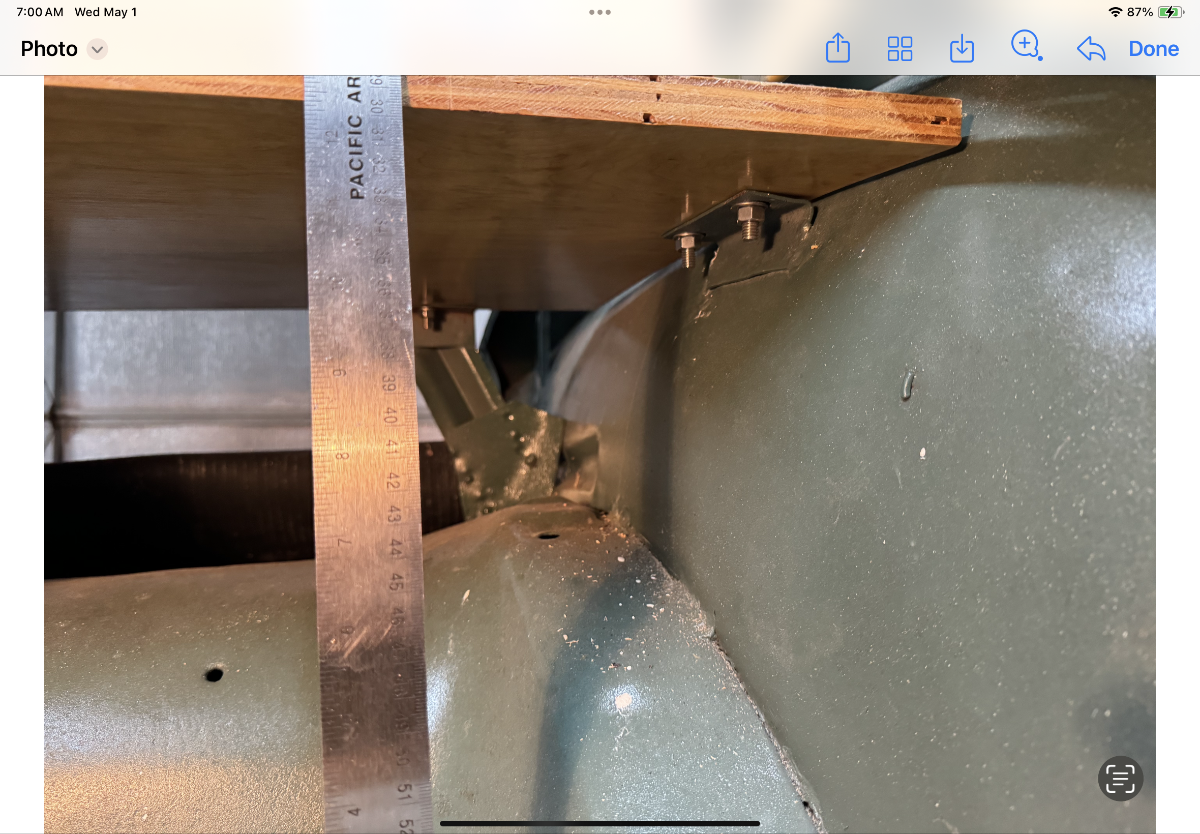

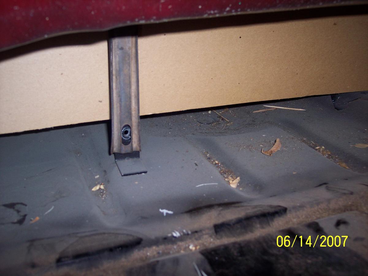

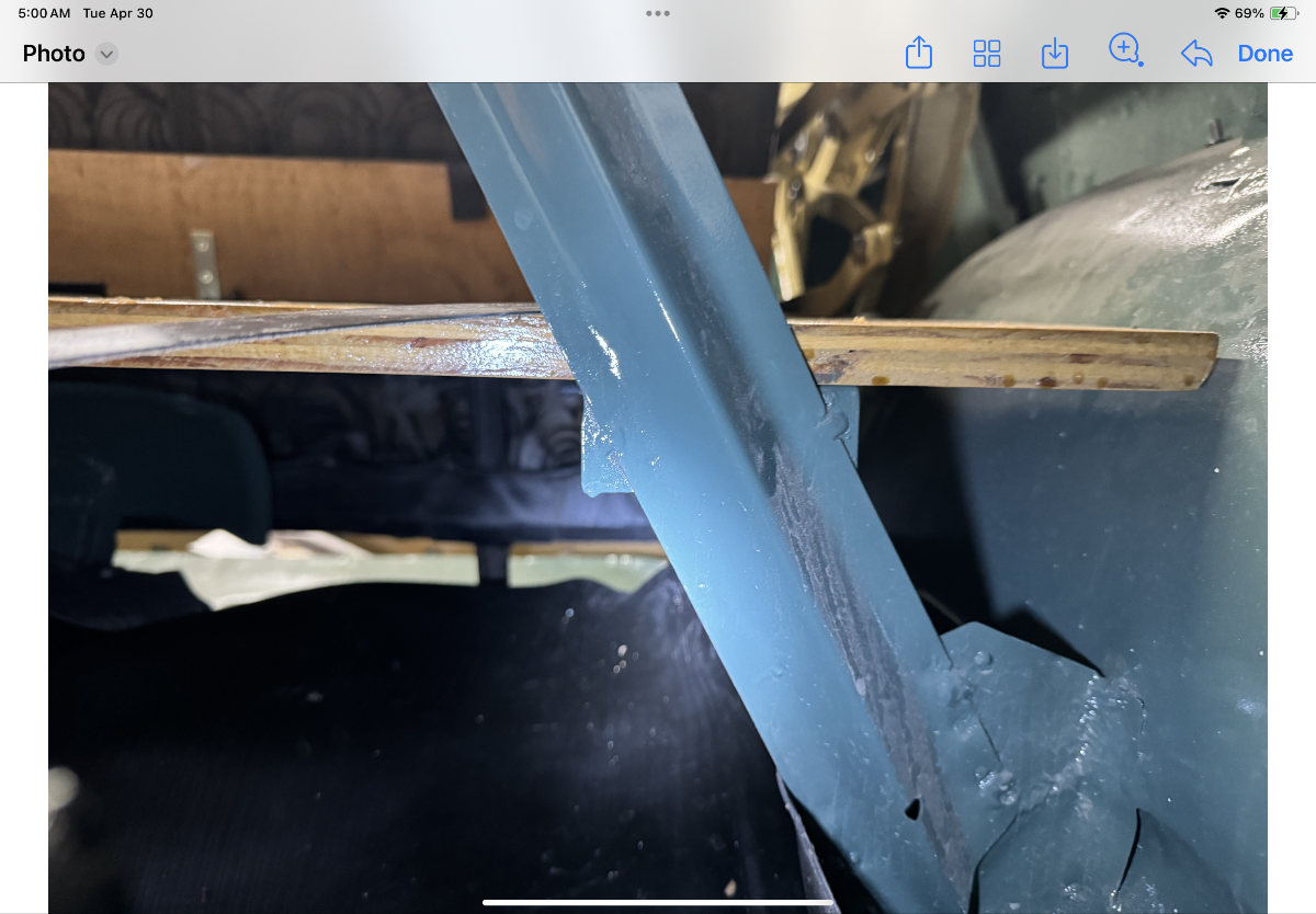

The picture is taken from insid trunk looking forward. U can see the shelve & the riser in front the back cushion hooks on, just to left of support brace is the hook on cushion . I will try to get u some measurements & more pictures

Great picture, thanks. That gives me a much better Idea.

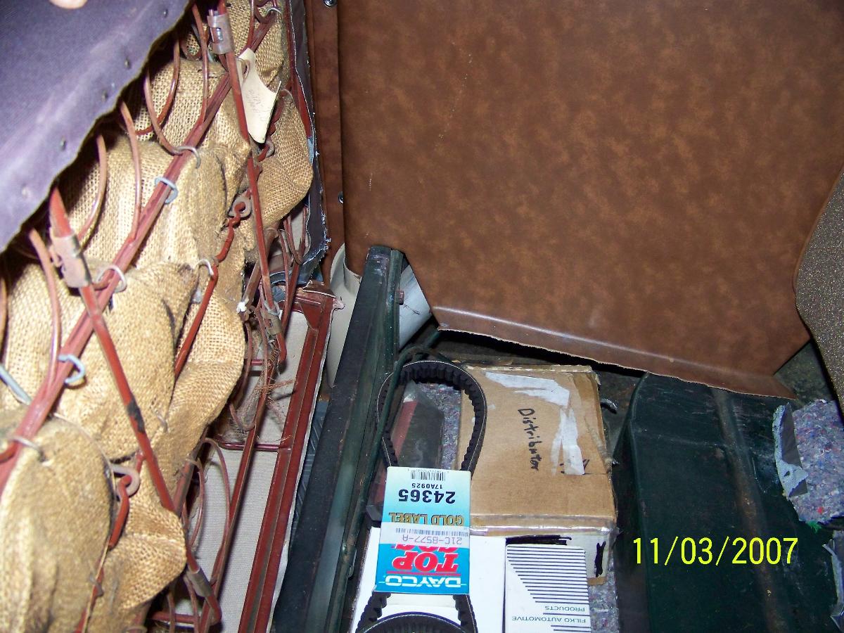

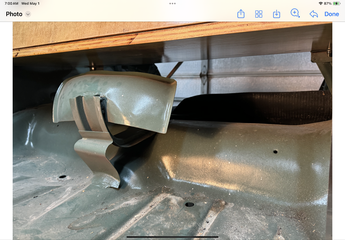

Here is picture of front , hard to read the fuller but about 13 inches from floor inside the car to bottom of plywood shelve.

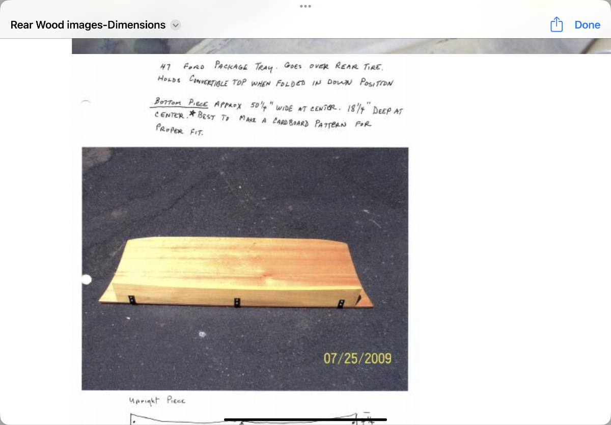

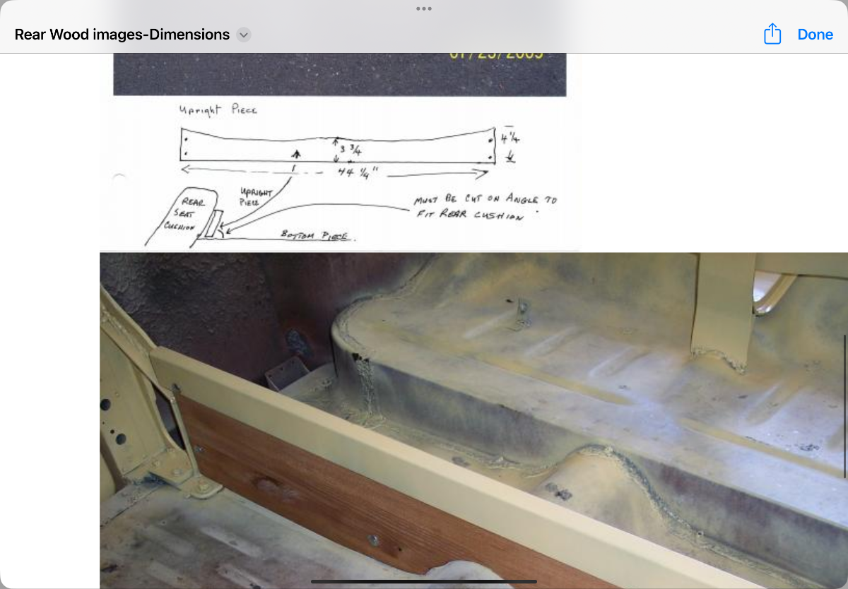

What are the measurements of the plywood piece? Looks like 5/8 thick as mentioned above, width will obviously be determined by the wheel well mount points, but depth?

Wil get a pattern , more on the way
