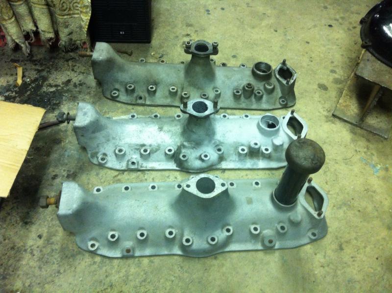

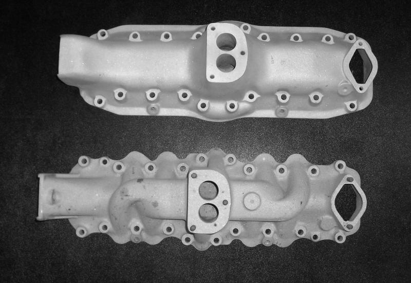

Since you have a intake manifold for a two barrel Carb, I suggest contacting Max Musgrove at Stromberg for a 97, Max rebuilds Strombergs and supplies parts. His email is: madmax1946@comcast.net
There are just a couple of places that can rebuild a Detroit Lubricator single barrel Carb and can supply parts. They can be found on the web. The original intake uses a special fuel pump also.
Below are a couple of the different 33 intakes and some of the 34 intakes for two barrel Carbs.
