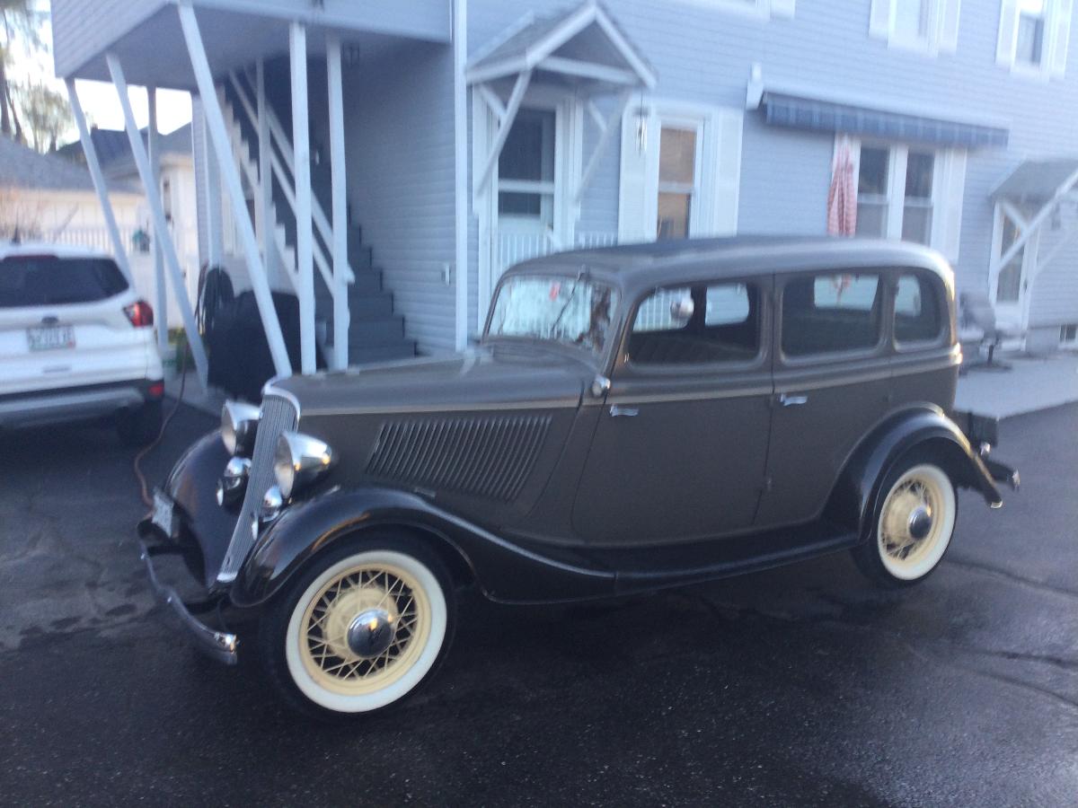

Took me a little over a week and many long hours but finally she’s registered and on the road. I have one problem I have gone through two radiator caps and nothing seals the radiator maybe I’m Filling it to full any suggestions. Thank you very much I love this website

Nice looking 33 Fordor. One like that was my first early Ford V-8 back in 1974. Mine was the same color also. Enjoy!
