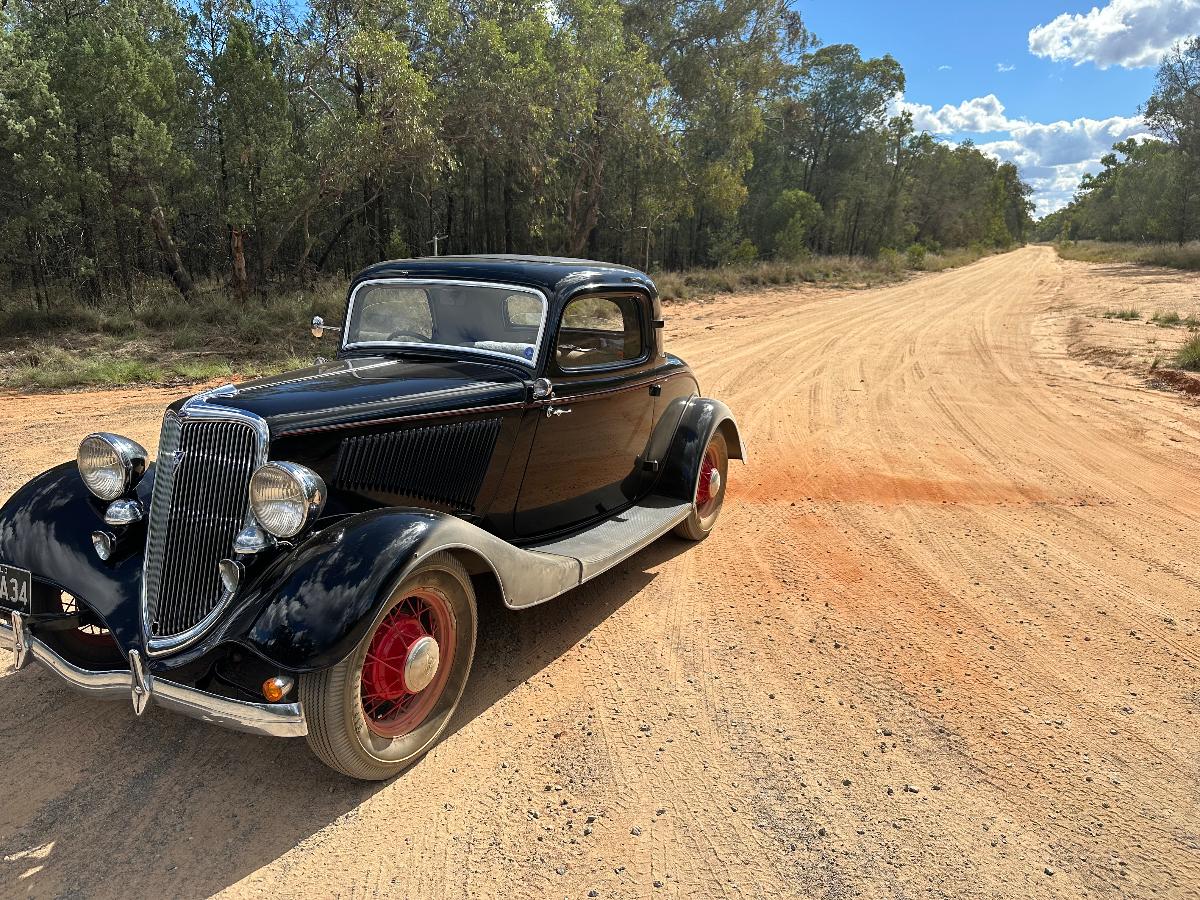

Those early engines had a steel camshaft and the lightest lifters you ever saw,plus only 35-40 lbs seat pressure.
I don’t know what the concern is about using a zinc type oil , unless you are using a non steel cam and very high seat pressure.
I have just done 4500 klms in my stock 34 , I just use a good brand 20/50 oil. The engine is as clean as inside.
You can hardly hear the engine.
