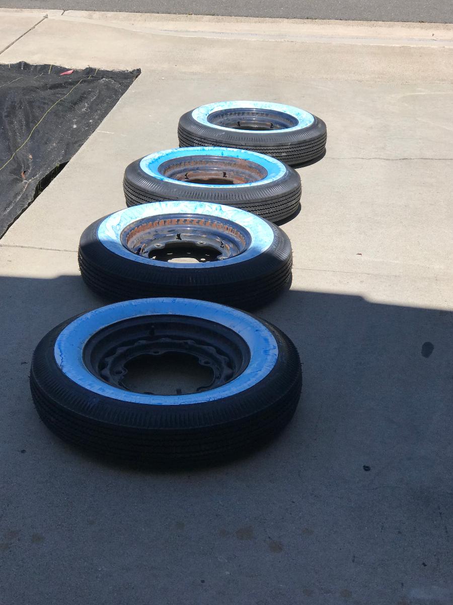

Got the Coker tires from Speedway, 6.00 x 16
After a little bit of a search, found a local shop that installed and balanced them.

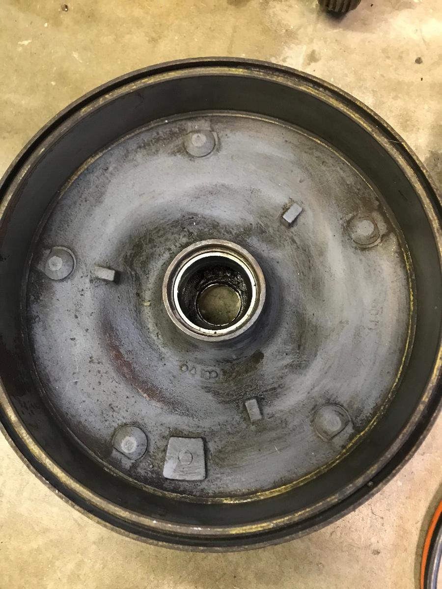

Used the front drum (1939) without the bearings to get them to fit on their balance machine. Thanks to whoever first suggested this, works perfect.
Hard to believe, but that's $1200 worth of tires with tax, installation and balancing. I remember going to CW Moss years ago and they had Firestone tires with a wider whitewall for like $89.

...About using the front drum to balance the wheels/tires, I hope they first balanced the drum with no wheel attached, otherwise the balancing of the individual wheels would be invalid.

It is my understanding the drums were balanced at the factory, See the weight at the 6 o'clock position.
But yes we checked the drum before attaching a wheel/tire and it was fine.
