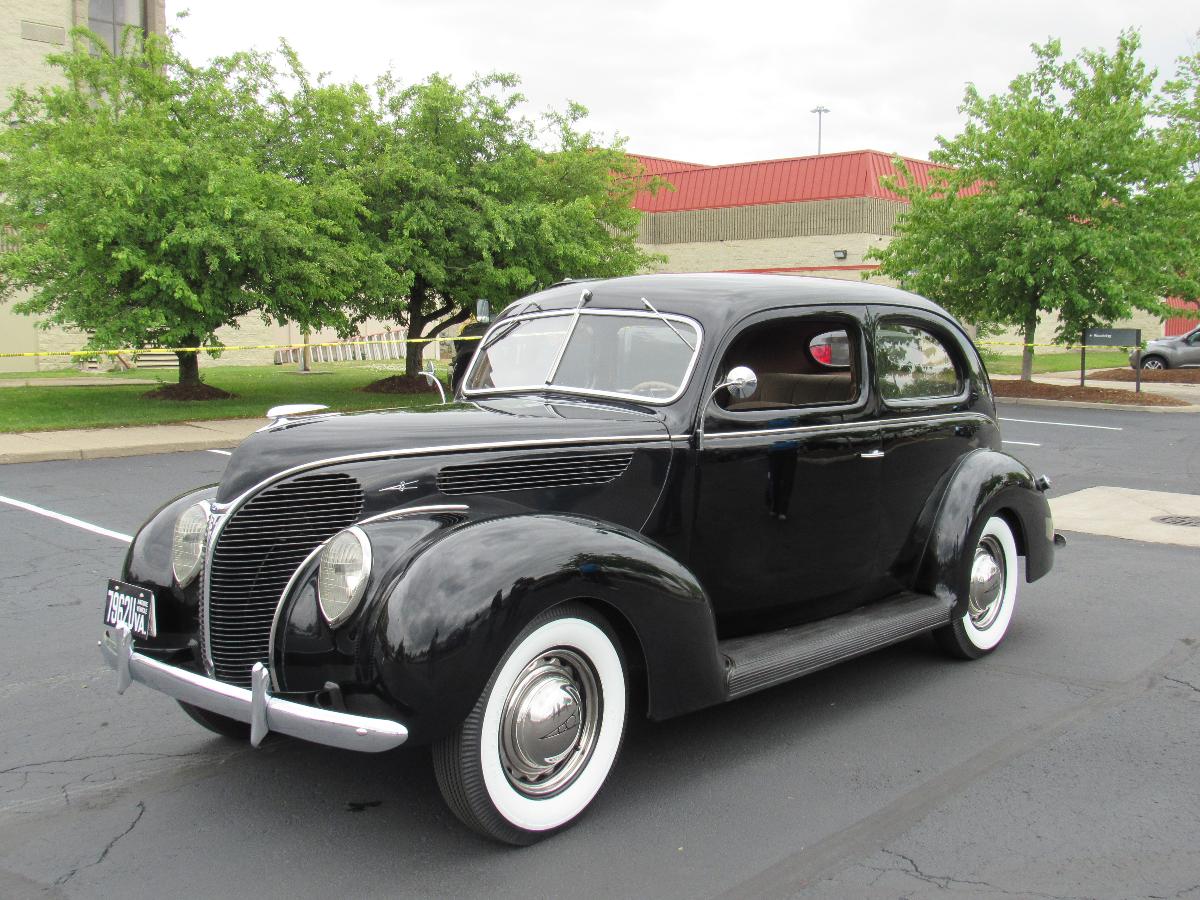

Who sells a coolant recovery system for a 1938 Ford flathead 85 hp. Thanks Terry

Terry, Congratulations on your Dearborn Award at the Grand National Meet. Hope you had no problems on the drive home. Ken

Oh, I hope you are not considering putting a recovery tank on a Dearborn car! Your car has a built-in expansion tank above the radiator core. A second, redundant expansion/recovery tank serves no purpose. Won’t help cooling.

Thanks Ken and all the others. My trip back to Virginia from the Dearborn was withoiy incident except for the loss of coolent which led to elivated temperature. Not dangerous but higher than I prefered. I had to add coolent half way home. I'm going to add thermostats and see if that helps before I put in a recovery system. The Dearborn show was more than excellent. Thanks to the club a d see you in New York
