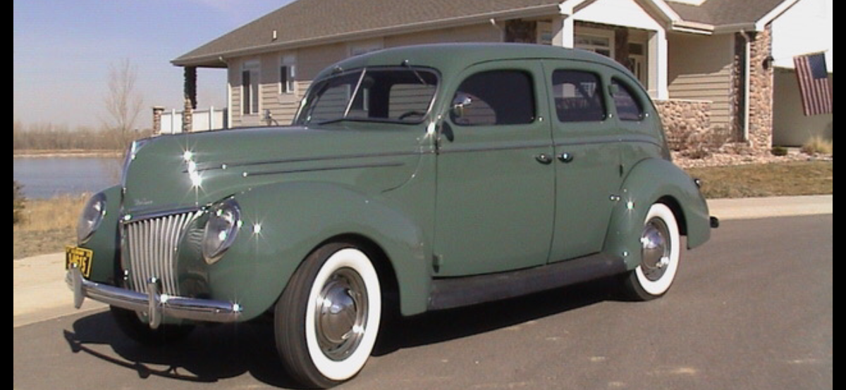

I am considering driving my 1939 Ford Deluxe from Colorado to Florida ! The car is in good condition, but it is 84 years old ! Our plan would be to take the back roads and take our time.

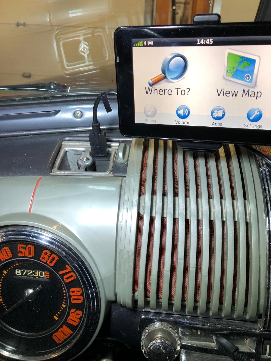

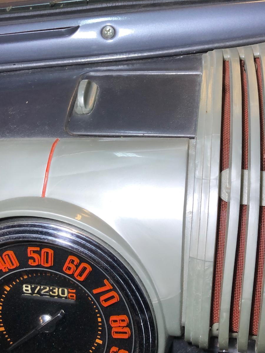

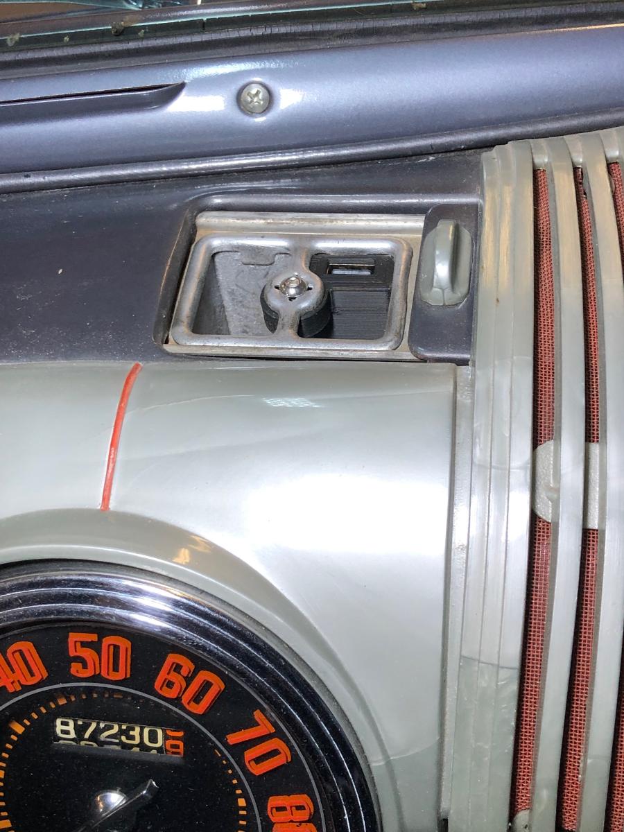

My '46 Super Deluxe Coupe is still 6V + ground, and I installed a USB port that I purchased from Classic Chargers. The owner custom made it to fit in the ashtray. It was an easy install, having only to drill a small hole in the bottom of the ashtray for the rubber grommet that was supplied, feed the two wires through and connect to ground and power with the correct polarity.
https://www.classicchargers.com/
https://www.classicchargers.com/product-category/ford-usb-chargers/
