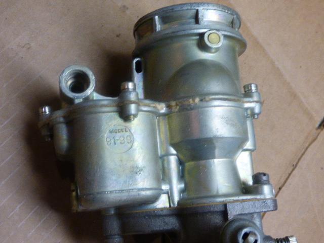

Authentically, they had a dull / satin "zinc" plated appearance.
The golden plating we see on the concourse occasionally is WRONG, WRONG, WRONG. And please, don't paint them.
If you'd like, I could (later) post a photo of a NOS carburetor.

Here ya go. Some of the NOS carburetors I've had had a tiny tint of "gold" on them as does this one. Others, not so much.

Don’t know why people did this - my ‘36 Phaeton arrived here with a gold painted carb. The ‘38 wagon came with a gold-ish (not painted) carb.
Would be interested to find out how this unfortunate trend started.

I'm not certain how that trend started. Ignorance?
I'd seen some on the concourse that were BRIGHT gold.

As often as not, that slight "tint of gold" appears to me to be more like a very faint rainbow of colors. That's what I see in your photo. Beats me how that was bumped up to yellow chromate plating in the minds of some.
