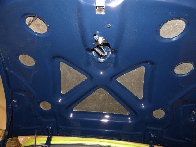

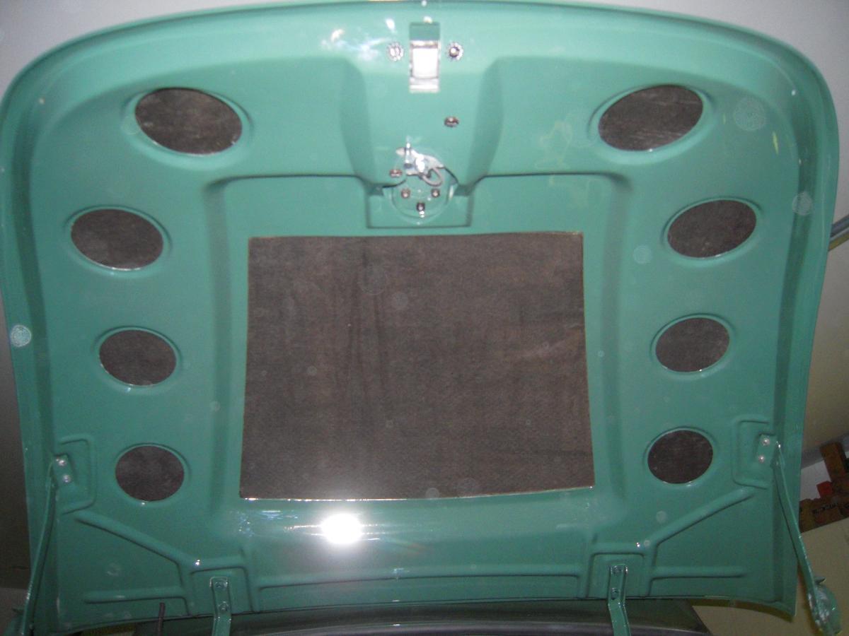

James, As has been advised, Drake sold it at one time.
The paper was in fact installed as a sheet prior to the trunk lid being crimped over the inner structure.
There was no masking of this material, so any overspray did "color" the paper. However, after decades, the paper had a tendency to absorb the paint.
Photos attached of both a '39 and a '40. Same process as your '47...
