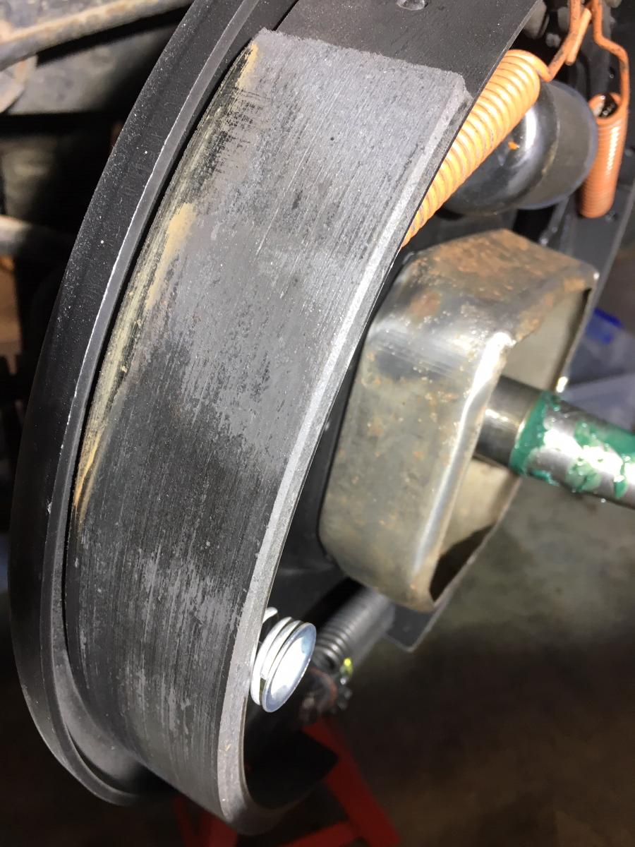

I had a very recent brake job completed. Now I have very little pedal goes almost to the floor. All the rods are good not bent to the extreme or if at all. When I apply the pedal goes almost the floor, 1-2 inches from it. I used to have 4-6 inches prior to the brake job.
Anybody have any ideas that might help the problem? All drums are good and turned within specs. All clovis pins are new. Cables are very good. No, I do not want to change to hydraulics.
This car is a survivor has not been frame off restored its nice,

Compare your linings to the old ones. Some reproductions are much thinner than the originals. Also in a V-8 Time article the author noted that the steel part of the shoe was smaller than the original by about 1/8 of an inch. Combined with brake drums which have been turned, this will cause a low pedal. It does not take a lot of extra clearance at the brake to make a huge change in pedal height.
We found this problem on a 1946 sedan. The cure was to reline the original shoes, which corrected the low pedal. The linings on the repo shoes the owner had installed were thinner than the worn out originals!!
51woodie
10-26-2022 @ 3:36 AM
flatfoot. You mentioned the drums were turned within specs. Were the shoes arced to match the curve of the drum face? If not, then what happens is the lining at the center of the shoes contact the drums first when the brakes are applied, then the shoe body will flex a bit, trying to put the full length of the lining into contact with the drum. If that makes sense. After I installed new shoes on my '46 Coupe, I had a "soft" pedal. Bleeding the system had no benefit. I pulled the drums after a few hundred miles driven, and found poor contact area on the shoes. The "soft" pedal and poor brake performance went away after the shoes were arced.

The brakes have been adjusted and new old stock rods installed. All wheels are turned and adjusted. However, the pedal when applying the brakes normally goes below the gas pedal in order to barley stop the car. The mounting system is in excellent shape. Drums were turned but could not arc the shoes(nobody in this area does that). I had good pedal before the brakes being renewed. The shop unfastened the rods then adjusted each wheel and then the rods. Still no or very little pedal. I am afraid to drive it. It is really bad,

Have you looked at the metal part of shoes and compared them to originals? If they are only 1/8 of an inch shorter it will cause the problem you describe. Please let us know what you find.

I don't have the originals anymore. brakes had been replaced 20 years when I bought the car. I just replaced the replaced shoes. lol
