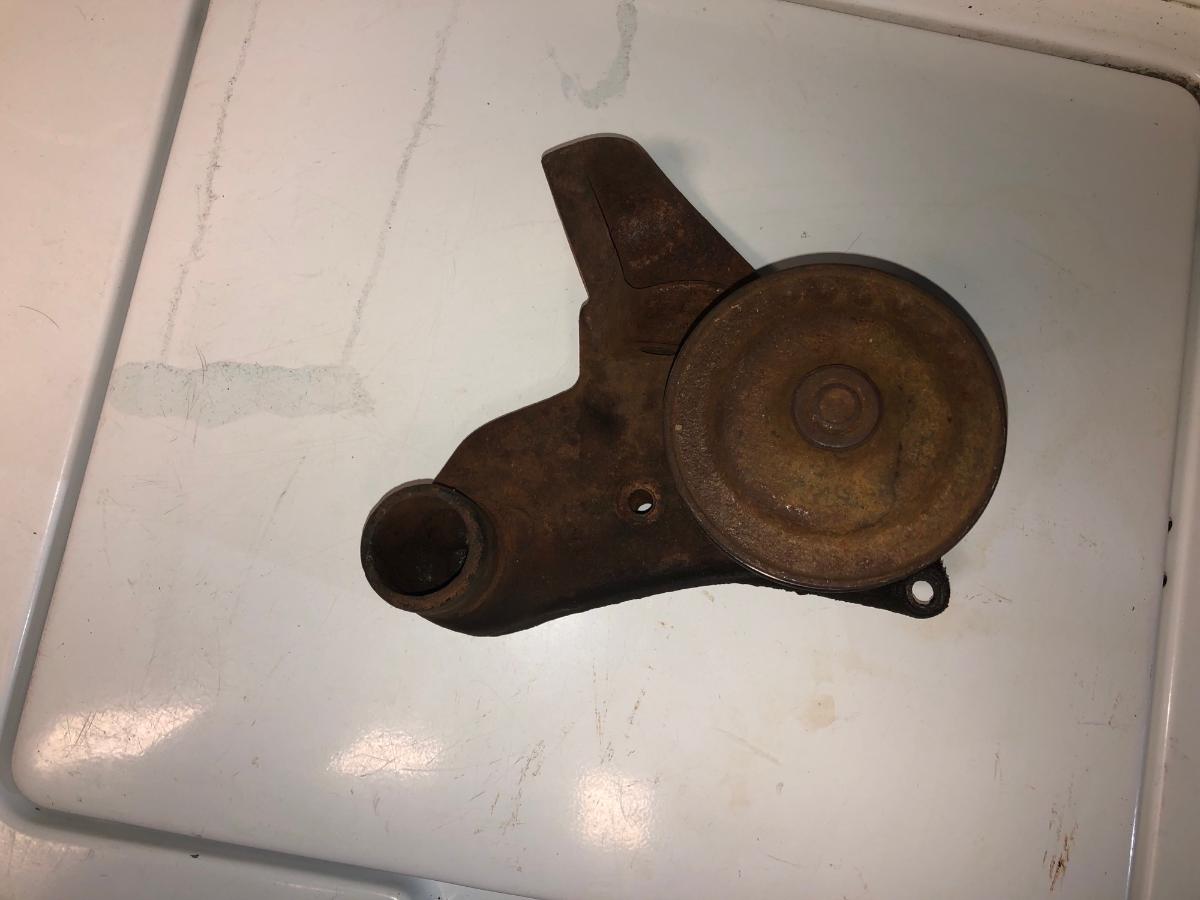

Thanks, it drives great and runs good. These pumps are one less 70+ year old time bomb to worry about. One of the old ones must have been making noise, the engine is noticeably quieter now. I have wide fan, crank pulley and generator pulley on the way. Now to just keep picking away at other things.

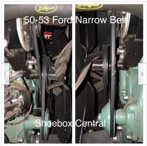

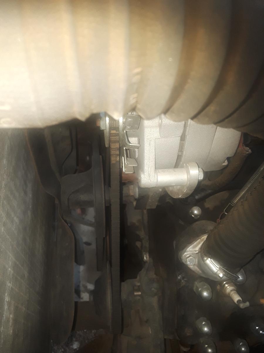

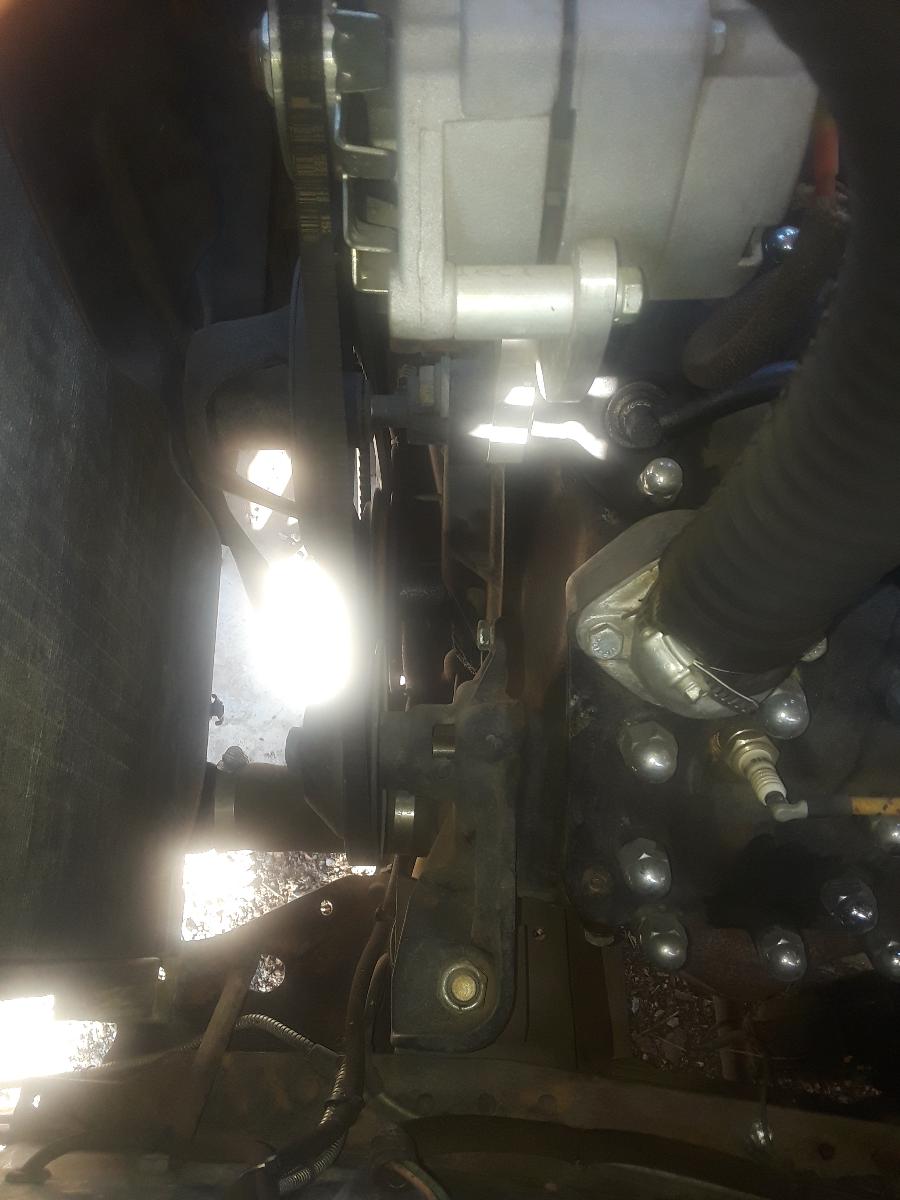

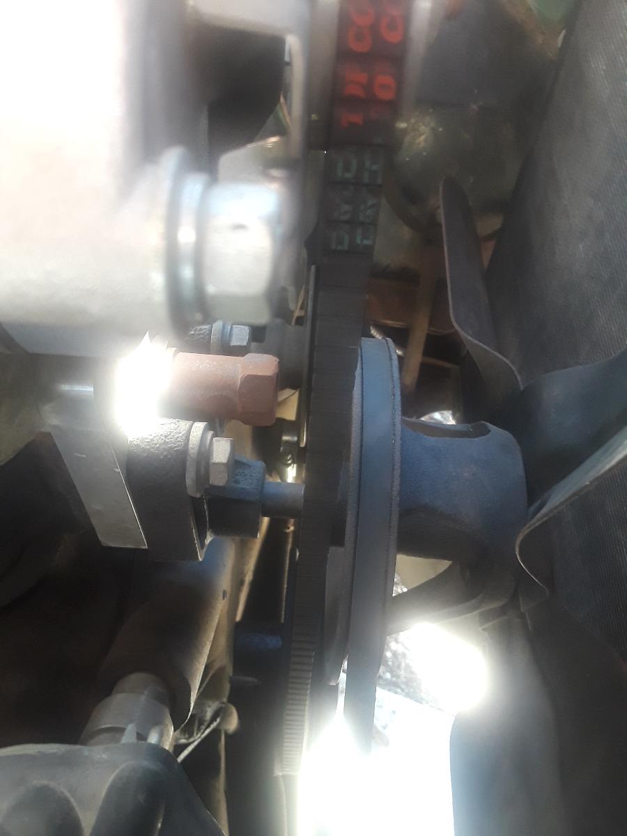

I bought a pair of truck pumps, they fit perfect, the stock motor mounts were under the stack of rubber spaces they had under the Mercury pump ears, it sits in the and bolts up perfect, looks much better under the hood and the motor sits a little lower than it did, makes the fan sit better in the fan shroud. I am running a 1/2" belt as a compromise for the time (i ran out of patience and just wanted to drive it). I think I have found everything I need to convert the rest of it to wide belt truck stuff over the winter.
Is there a market for my Mercury cores?

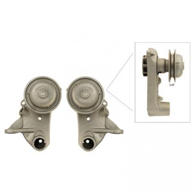

I found the pair of pumps on Carpenter's site. I did see the shallow passenger side pulley for an 8BA, the deep pulley he has is for the goes up to 48 cars, 47 trucks, is the shaft diameter the same between the two style of pumps?

10-20-2022 @ 1:00 PM
Posts: 1979
To the best of my knowledge, the 1948 to 1952 Ford Truck F-1 water pumps with the wide belt (11/16") pullies should bolt up to your engine and function properly. Also the holes should be in the proper location to bolt up to your frame with spacers. If you want to put smaller belt (3/8") pullies on these pumps, Dennis Carpenter has them under part number 8BA-8509-B. Carpenter also claims to have a set of the Wide Belt Truck Pumps (new) in stock under part number 8RT-8501-PR.
Hope this helps.

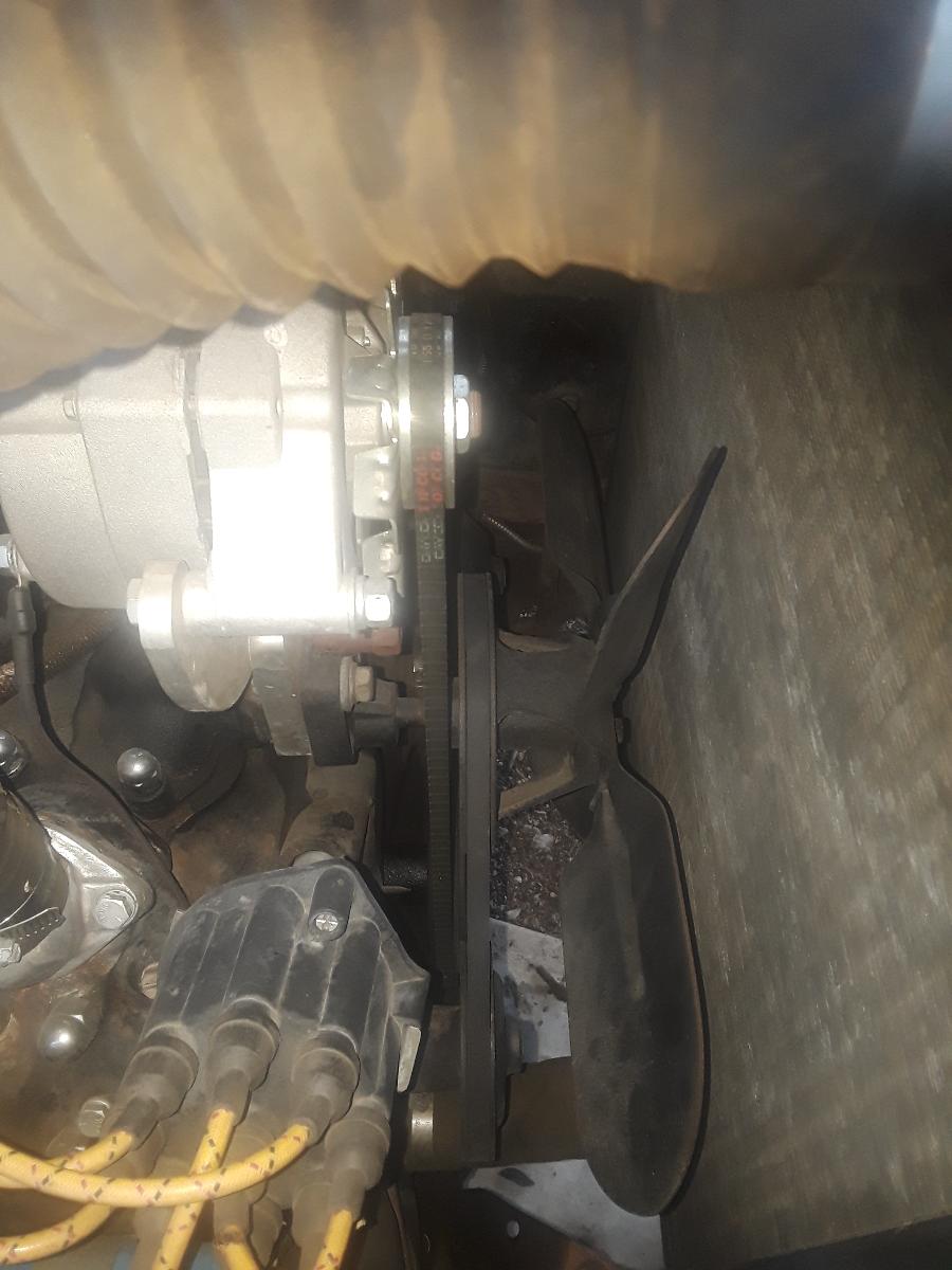

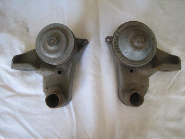

Thanks for the info, a previous post…
“Attached are some photos of the 8ba with narrow belt Merc pumps in my '39 p/u. They aren't very clear, the sun is too bright. I'll take some better ones later this afternoon. From your photos it looks like you have the narrow belt Merc pumps. Wide or narrow the pumps have 2 different diameter pulleys and each uses a separate belt. If it were me I'd send both pumps to Skip Haney in Punta Gorda, FL for rebuilding. He is up and running again after the hurricane but he may be somewhat backlogged. http://www.fordcollector.com/water_pumps.htm”
has a different website that has a different email address.

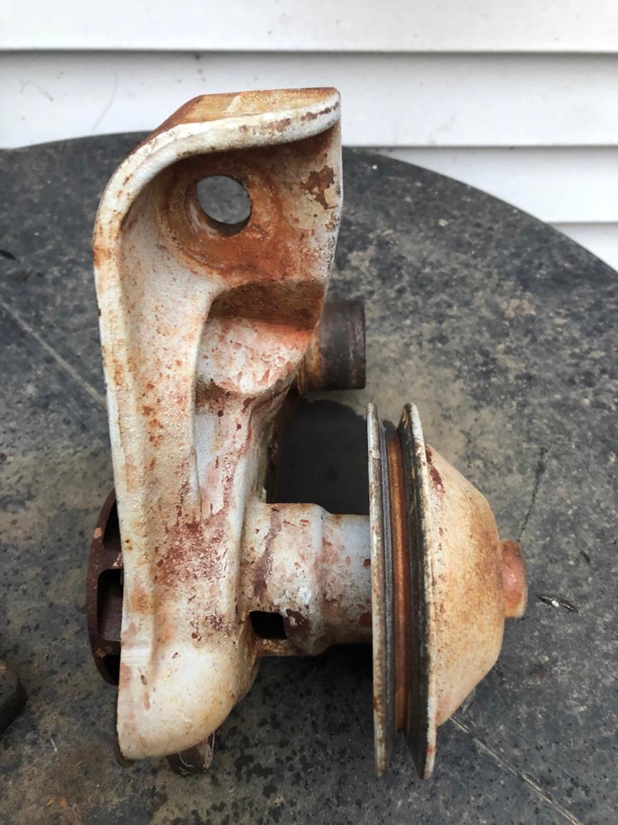

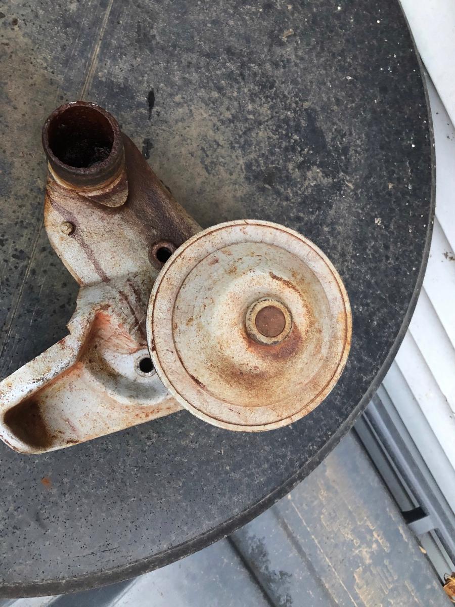

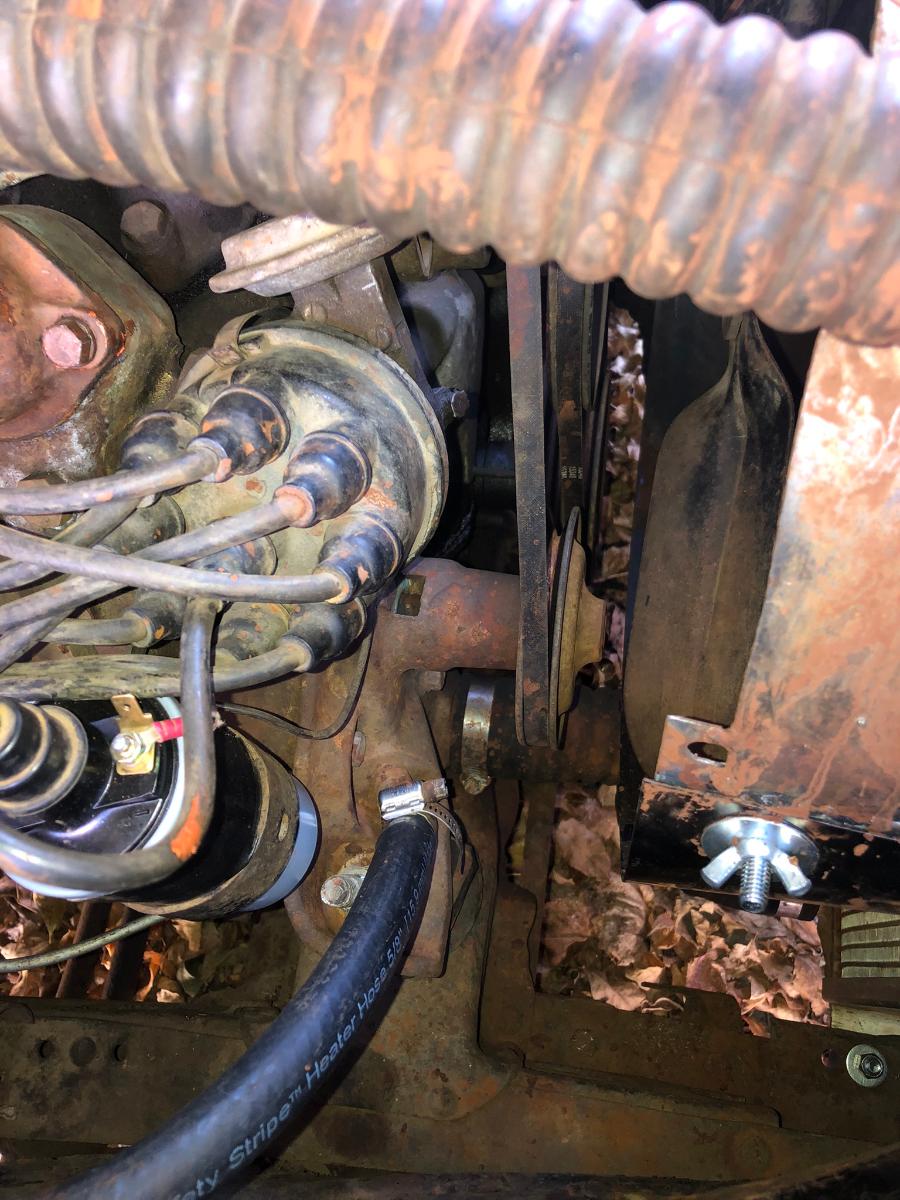

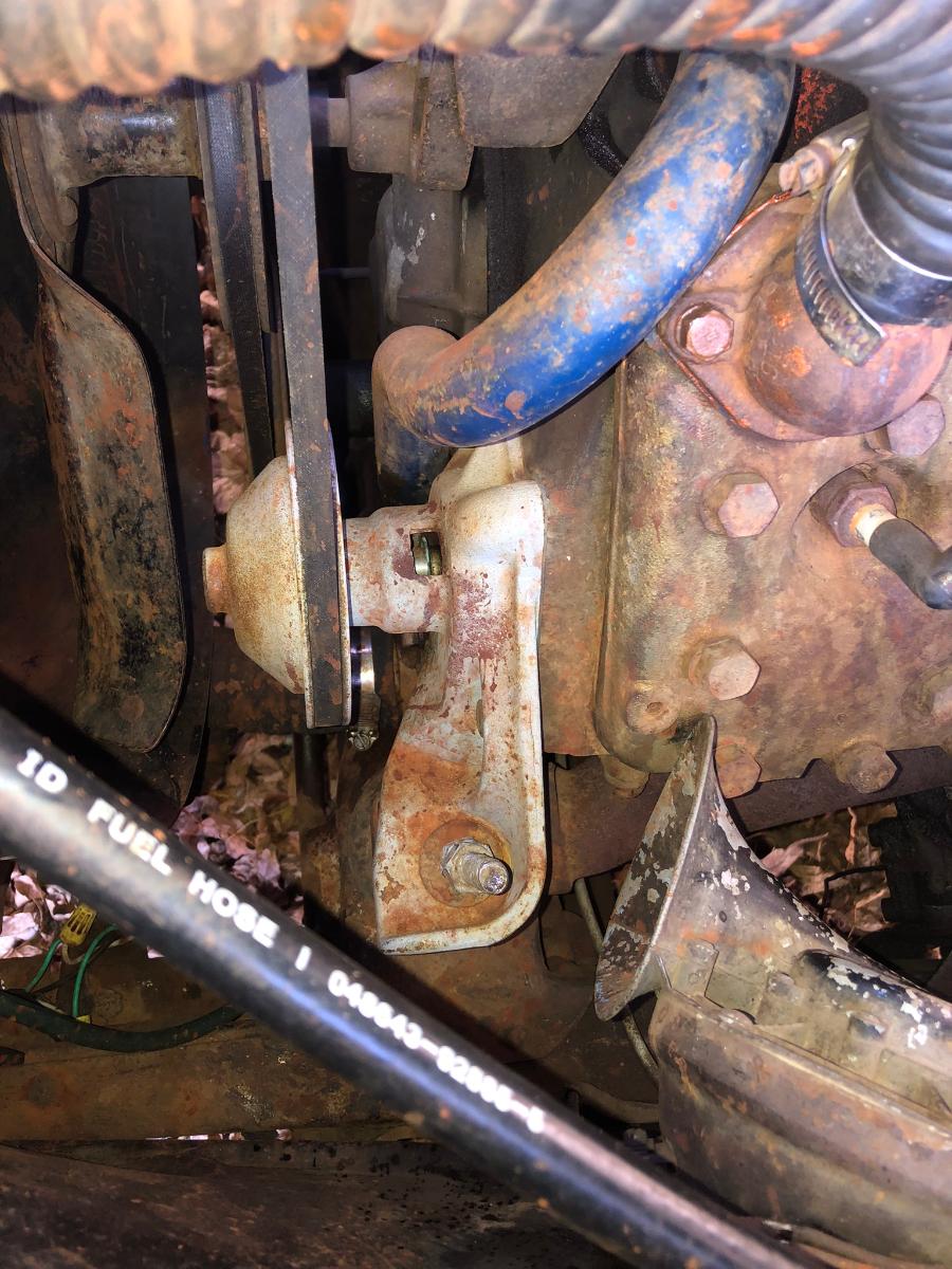

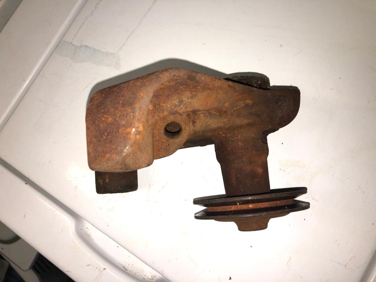

Is there any difference in the hole location other than height between 49-53 truck mounts and Mercury mounts? This 8BA is in a 41 Ford car, there are stacks of hard rubber spacers under the Mercury ears and all-thread going all of the way through. the distance from the frame to the bottom of the water pump ears is 3" total. It's not pretty but it has worked for years. I am thinking about getting new 49-53 truck pumps so down the road someone else isn't faced with this same issue. I can change the other pulleys to match, then everything would be 49-53 truck and easy to come buy off-the-shelf.
My question is, will I just need to cut my spacers to match the difference in height? Or is there a difference in spacing/location of the holes as well? If I were starting from scratch with a 41 car and an 8BA, would 49-53 pumps bolt up to my frame?
I am checking with a local guy to see if he will rebuild my pumps, if so I will probably do that. Skip hasn't replied. I'd like to get this buttoned up, this is my favorite time of year to drive it.
10-19-2022 @ 2:19 PM
Posts: 1979
If the late truck pumps have a mounting flange that is higher than what you need to line the engine up in the car, you can use flat washers of the correct diameters and thicknesses to allow the engine to be mounted properly. Also, if the pullies aren't of the proper type, they can probably be swapped with ones to suit the type of belt that is compatible with your crank and generator pullies.
