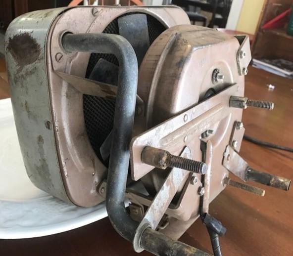

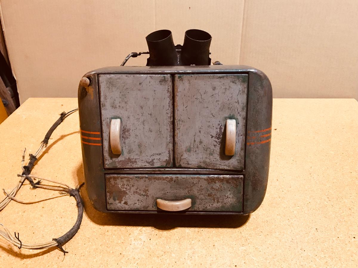

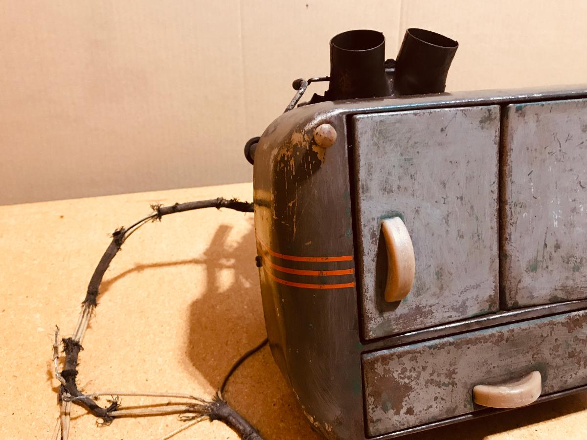

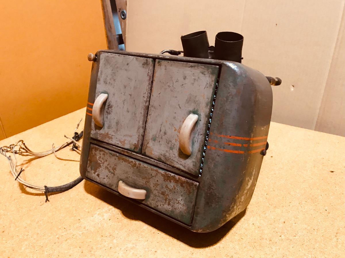

Just pulled the heater out of my '36. Can anyone identify it? Does it look familiar?
I had it tested and the motor is shot.
In keeping the car entirely original, I'm looking to send the entire unit out to be refurbished. I'm sure that someone, somewhere is just the man to take on such work. Does anyone know who this is? Any suggestions on how I might find them?

Ford Passenger cars 41 - 48. Colors and knobs changed from year to year but the basic heater is identical.
To keep your car "entirely original" you'll need to remove this heater in its entirety.

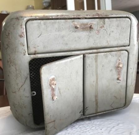

The heater is a 42 - 48 Ford Mercury hot water heater. Your heater is pictured upside down. The 41 Ford heater has the defrost knob in the upper left hand corner of the cabinet like the 39 and 40 heaters have.

The 42 Heater also has the defrost knob like the 41. Heater is 1946-48.

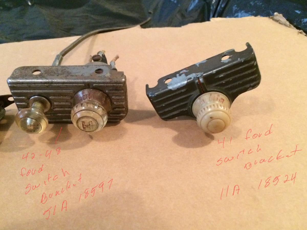

1942 Deluxe, I was using the photo in the 1941 - 48 Ford Book page 3-7 chapter 3 (Interiors) showing the dash of a 42 Ford that included the heater and the heater switch bracket. You will see the heater switch bracket has room for the switch and defrost cable. I have attached a photo of a 41 Ford switch bracket and what I thought was a 42 - 48 Ford switch bracket. If wrong let me know. Thanks Dave

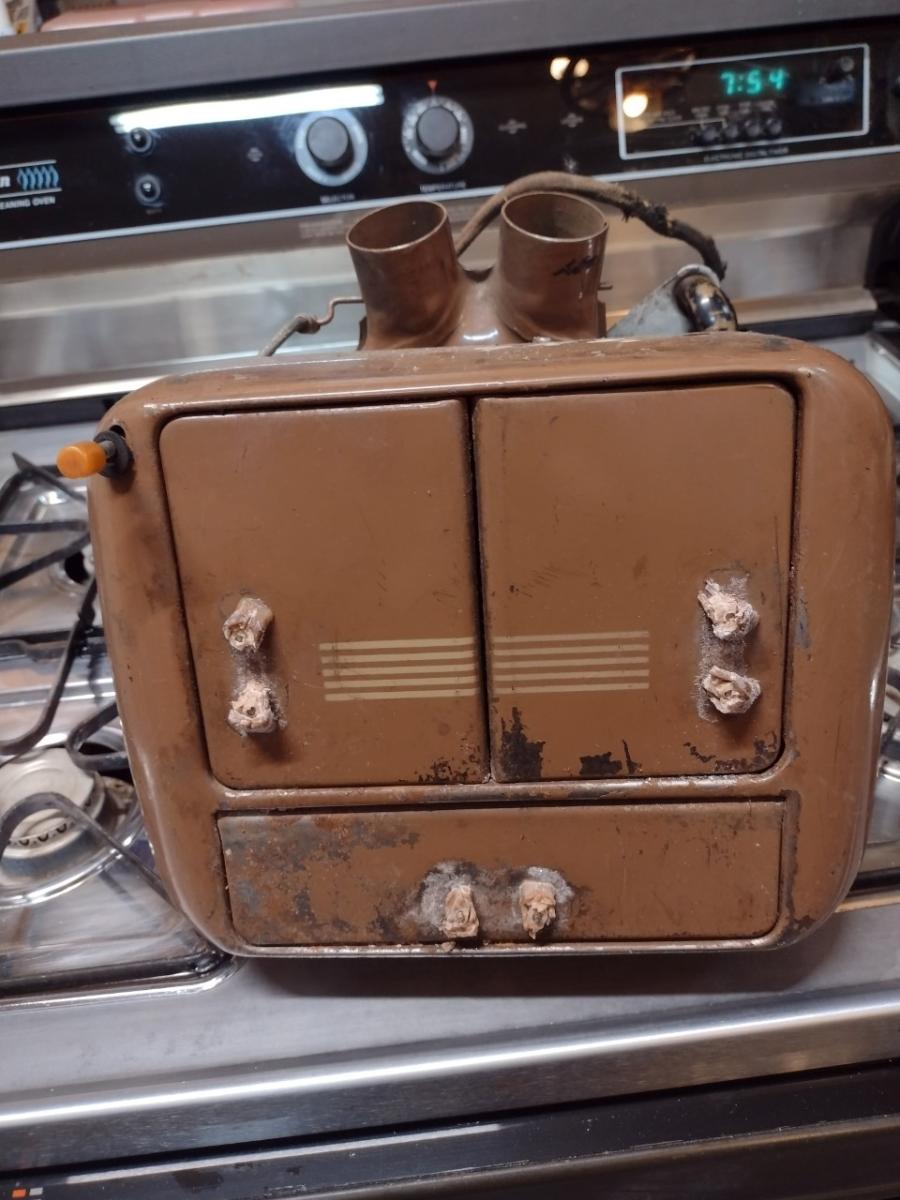

Here's a photo of the heater I bought from Mort Burton a number of years ago at Hershey.
Notice the pull knob on the upper left. The 41 heaters had red stripes on the sides if they
are original paint? Maybe Fred Killian can comment.

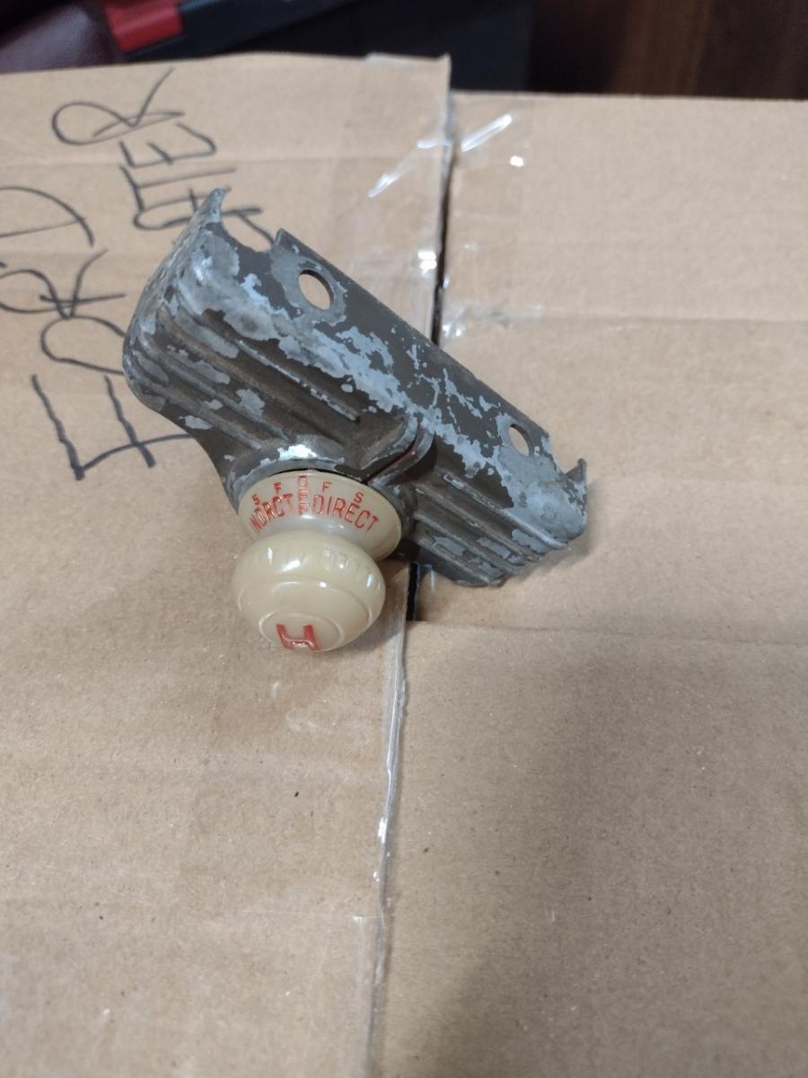

Here's a photo of the heater control which I believe is the 11A one.
The 51A prefix indicates 1946 in my experience. Already been burned
by the "green bible" on parts for my 1942 deluxe coupe. I needed the
radiator brackets which the "green bible" indicated where a 51A prefix
part number. The 51A p/n was a service replacement and requires the
46-8 U channel also. I'm always open for correction.
