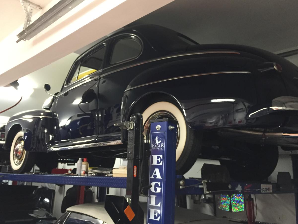

I recently acquired a frame off restored ‘46 Super Deluxe coupe with a flat head. The car has been in storage since 2018 and I want to change the oil before driving it. Probably a very elementary question but I’ve looked on line for the brand and weight oil but get anywhere from straight 30, 10w30 and 20w50. I thought I would use Lucas Hot Rod & Classic Car with zinc but unsure of what weight. Can you recommend or refer me to a source that can advise?
