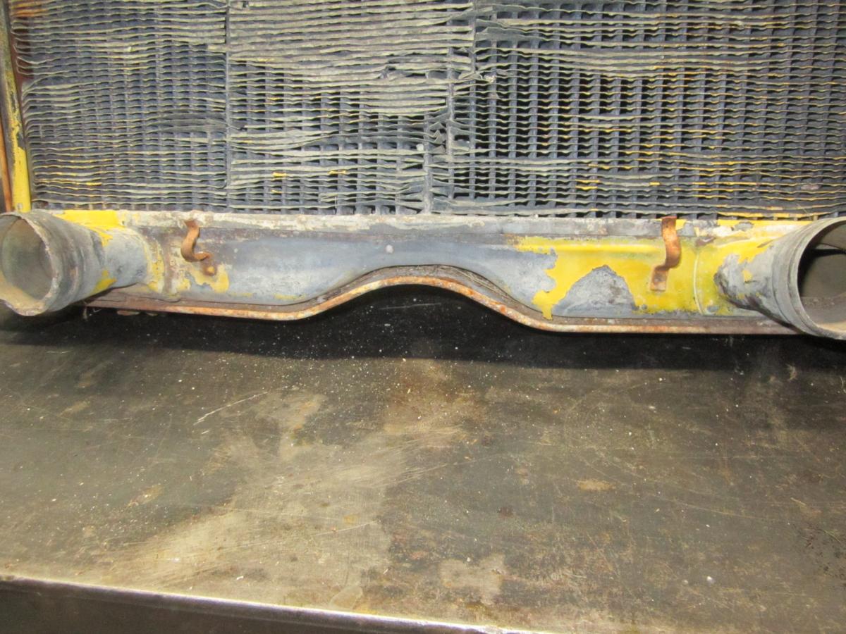

Hello, I have what I think is a 37 radiator. At the bottom, next to the lower hose connections there are two clips. Any idea as to what should be routed through these?
Thanks,
gregg

On my '37, the wiring harness to the right headlight comes off of the left headlight harness. It runs across the bottom of the radiator. Those 2 clips hold it in place. - F F

Thanks for the info. I am not crazy about running the wiring harness along the bottom of the radiator.

That’s the route it takes.

I have it wrapped in that black plastic wireing harness protectant. Its been like that for years, never had a problem.

All the original Ford radiators of the period had those clips. They do the job.
