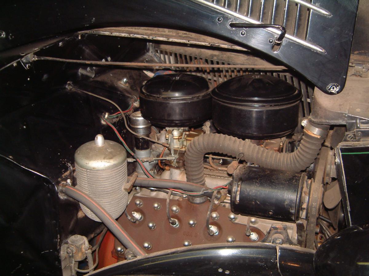

my slightly bad memory says that 39 was the first year, a canister that was connected between two hoses and was replaced with a new canister. I would also say that the bypass filter from a 40 engine would be simple to install and effective as they ever were. I assume that we are talking about a 24 stud engine?

The first oil filter offered by Ford in 36 as an accessory and continued into 1940 is the AC filter. In 40 Ford started offering the Fram filter and discontinued the use of the AC. The clubs 38-39 restoration book has great info regarding the AC filter.

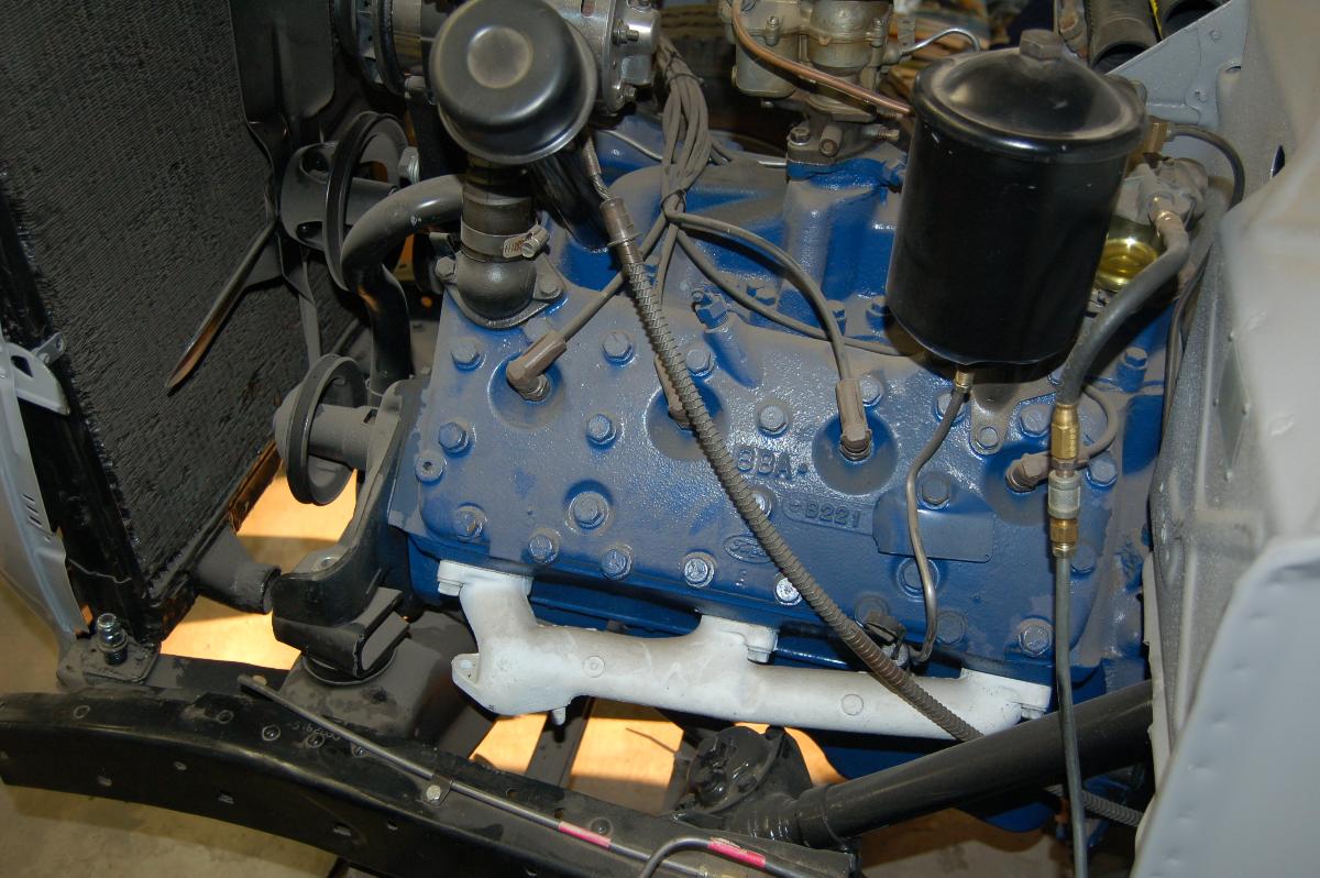

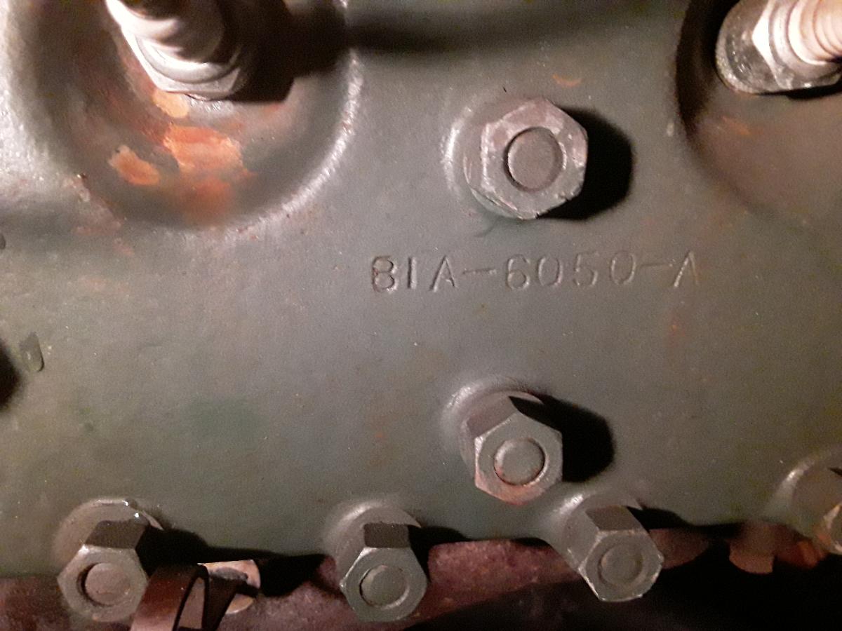

Terry, Ford rated its V8 as 85 hp from 1934 through 1940. If yours is original to the car, it could have either 21 or 24 studs. If it is 24, what markings are on the heads? I’m not sure if an original oil filter will mount on a 24 stud engine. The entire original canister, as stated previously, was disposable, and mounted horizontally on the left side of the block above the head. These units are just not available at all today, and most V8ers have never seen one. I make this point because you continue to refer to an original filter for your car. A previous post on this thread mentioned that he had a mount for an original, and there was a similar canister made in Canada some years ago, but I haven’t heard if anyone has successfully adapted them for your purpose, or even if any are still available

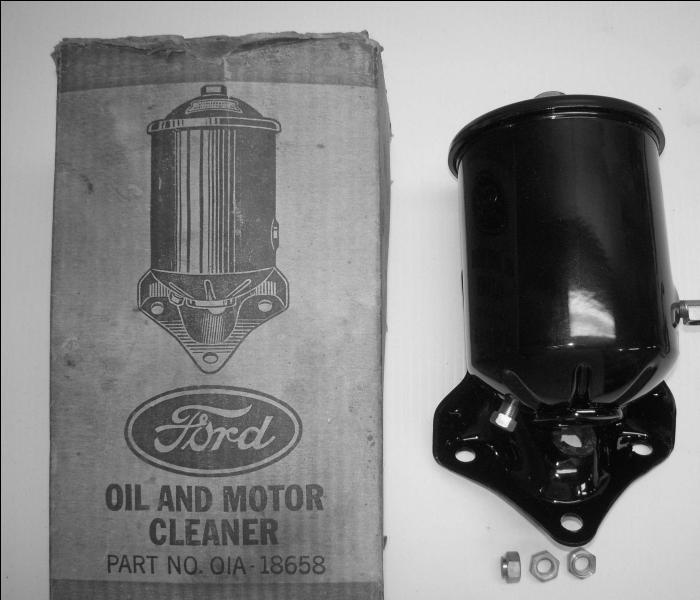

While you may not be able to find an original oil filter for a 1938 Ford, you may be able to find one for a 1940 Ford.
If your car has the 24 stud engine, the filter assembly for the 1940 Ford will fit. Part Number 01A-18658-A is a vertically mounted oil filter assembly that mounts on the left cylinder head between cylinders 5 and 6. It uses a replaceable filter element.
