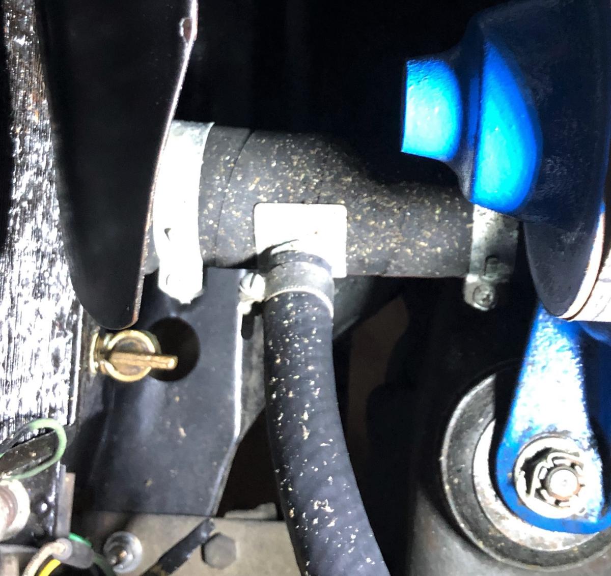

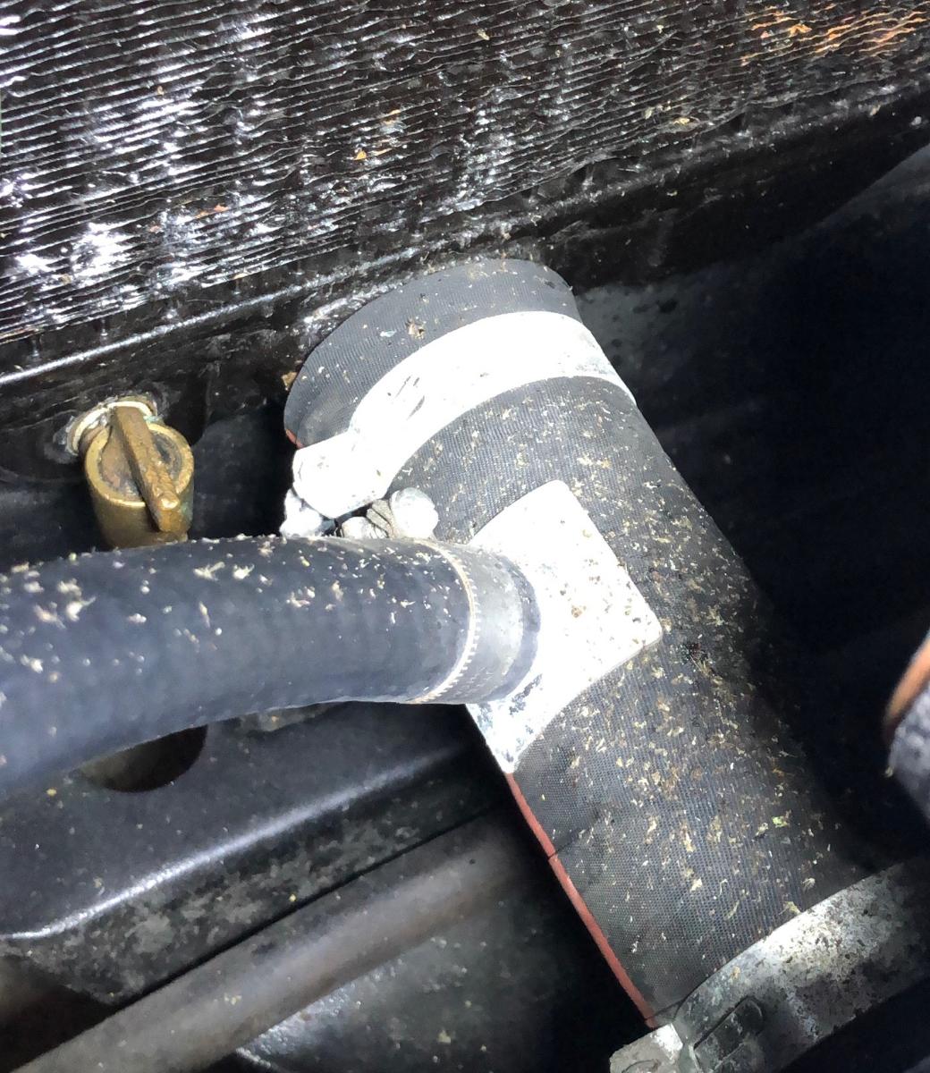

09-02-2022 @ 1:06 PM
Here are pics of the hose connection on my '46, 59AB. I used a leather punch to cut the hole in the lower rad hose, using a piece of hardwood inside the hose to support the wall of the hose. I got my hose fitting ( P/N 91A-15160-A) from Denis Carpenter.
Ignore the bug guts on the hoses.
