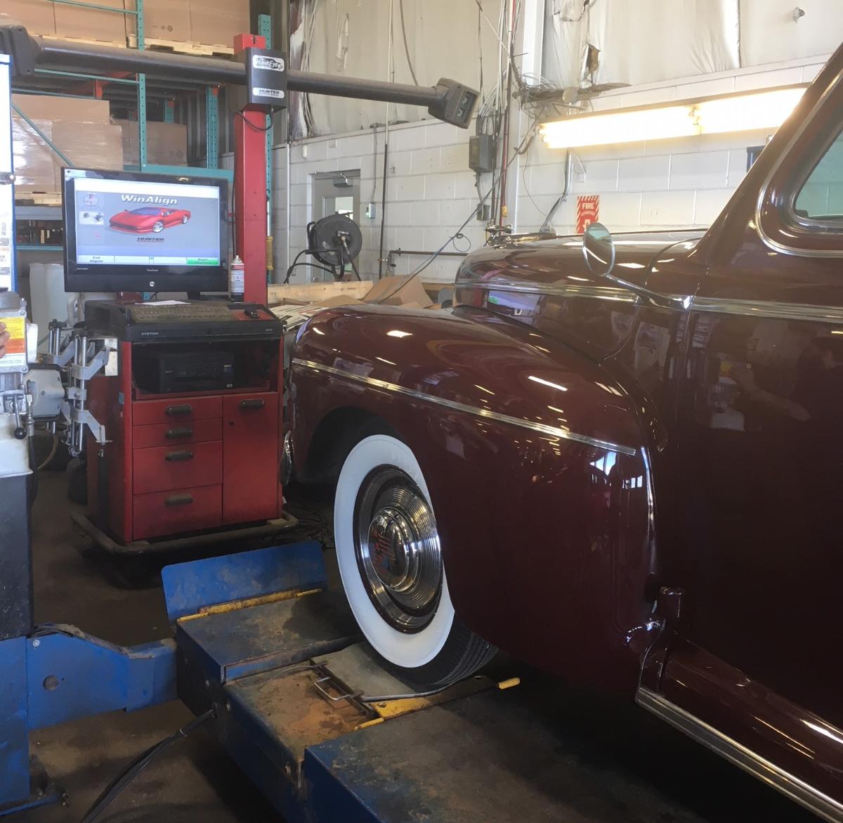

I put a new set of 6:00-16s on my '46 Coupe, tried the toe-in checks at home, and got frustrated with my efforts. All components of my front suspension and steering were in very food condition, but toe-in was an issue for me. I took my Coupe to the local Ford dealer and talked to the shop Foreman about an alignment check. He took one of the devices that attach to the wheels, to make cure it would fit, which it did, and said "Bring it in tomorrow morning with the toe specs and we can do it". He had to do some calculations to convert from inches to degrees for the computer, and set the toe. A thousand or so miles later, the tire wear is even across the face of both front tires. So it can be done.

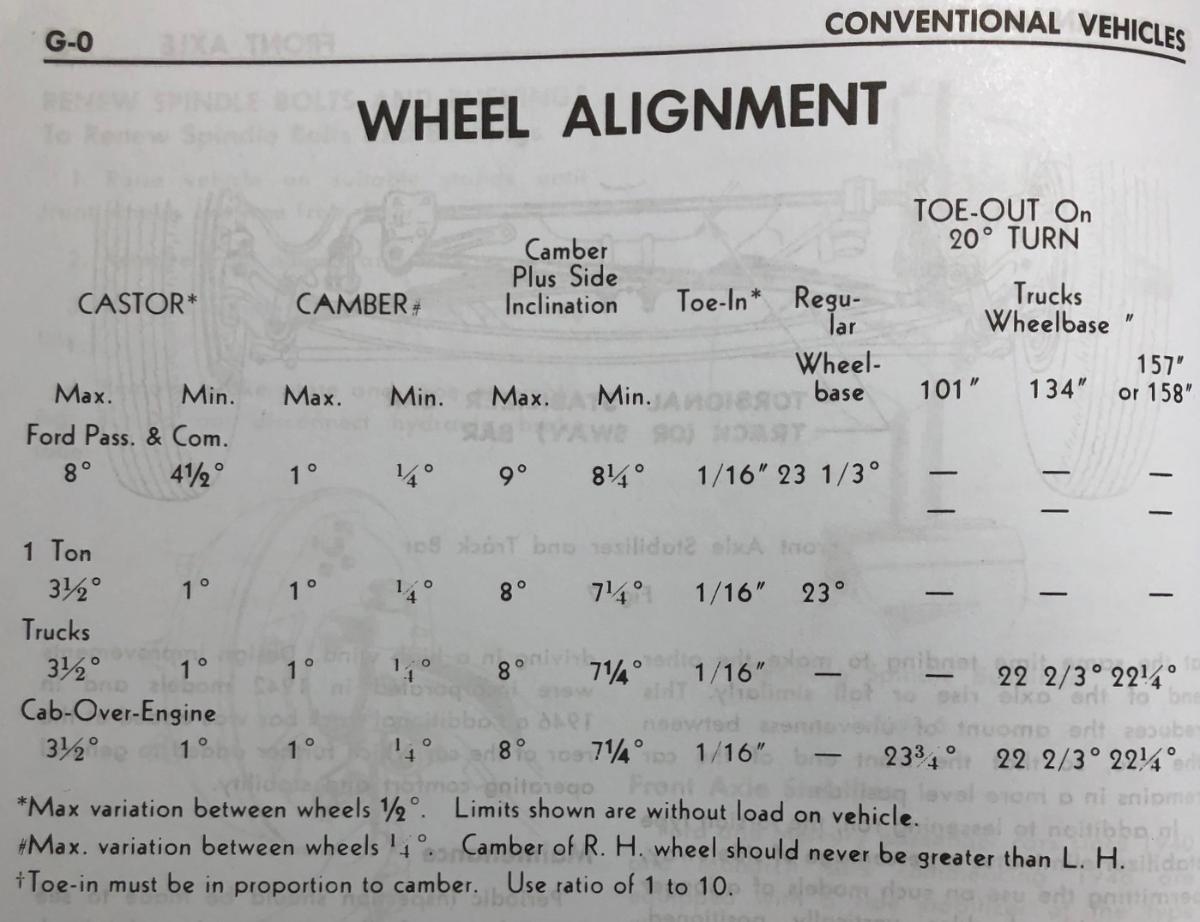

51woodie, that's really fascinating and useful information. Where did you get the Toe spec information? I will give it a go too and if it doesn't go too well, your approach sounds like it might be a possibility. Great pictures too. Thanks so much!
51woodie
09-03-2022 @ 7:26 AM
I got the specs from the 42-48 Ford Shop Manual (reprint).
