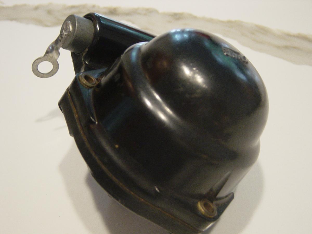

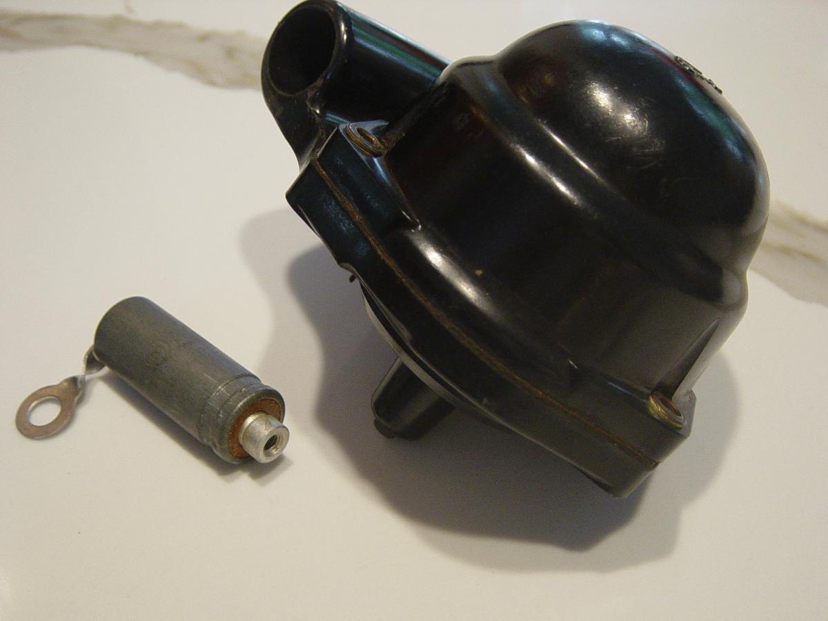

If you have the dome top coil and the original style distributor the ignition condenser is at the rear of the coil inside a molded bakelite tube that is part of the coil. One end of the condenser hangs out of the coil and has a small bracket that connects to one of the distributor bolts for ground. The other end of the condenser is inside the bakelite tube and connects with a screw to the coil. The head of the attachment screw can be seen under the terminal for the wireing.

The 1934 Ford Distributor has only one condensor inside the coil housing that is the top of the distributor. .Those condensors are very hard to find in good working condition. When they get old and hot, the foil wrap inside cracks and shuts off the ignition. When it cools down the connection sometimes resumes until it gets hot again and opens again and shuts the ignition off again.
It's a problem I have been fighiting to 50 years. Somerines a good consensor will last for many years, then finding another good one can take some time. There
are people who solider the original bracket onto an 6 cylinder Chevrolet 6 volt
condensor, others jury rig another condensor to fit the slot in the coil.
