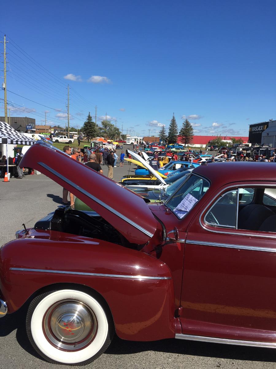

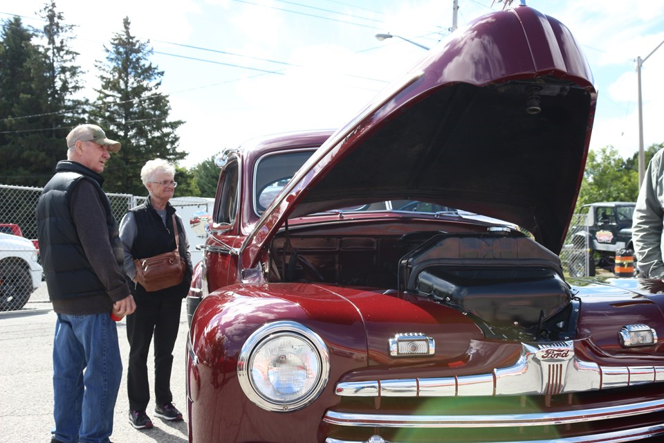

The hood on my '46 Super Deluxe Coupe opens to 30" between the under side of the hood nose, to the hood latch area on the front clip. When I let it go, it relaxes to an opening of 26". I don't know what is considered normal, but that's what my hood does.

When I open the hood on my '46 Woodie the measurement is about 30" and stays at 30".
