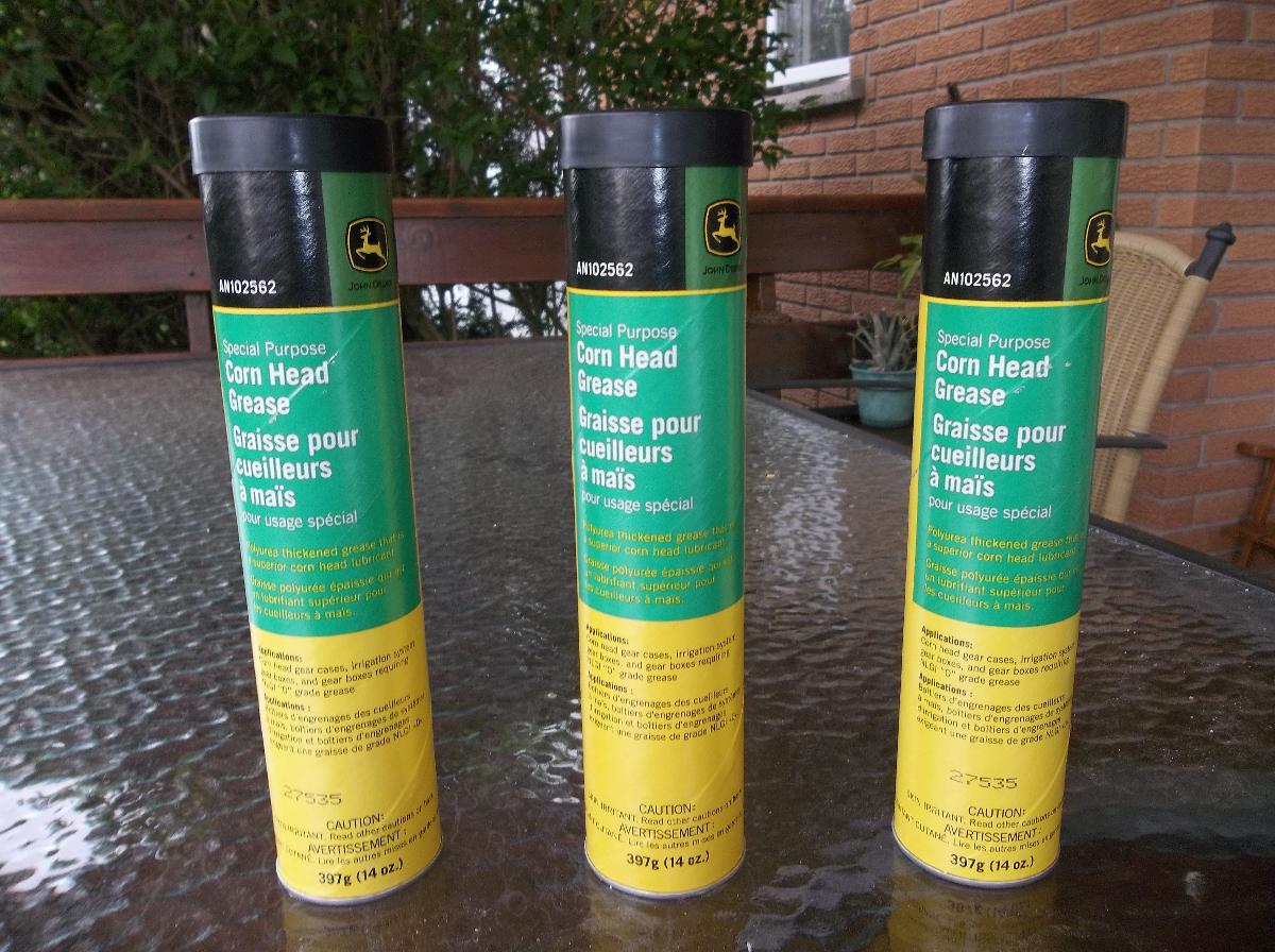

Many people use the John Deere Cornhead grease in the steering gear. Probably your best option.

One solution to the problem of steering gear oil leaks that worked for me follows. 1. Get as much of the old 90 weight gear oil as you can out of the steering box. 2. Install John Deere Corn Head Grease in the steering box. This stuff really works. Do not force too much into the steering box. Put the tube of grease into a grease gun that you have dedicated for this lubricant. Hold the grease gun discharge tube over the fill hole of the gearbox and allow the lube to flow into the box. You may still have a small leak until all of the old 90 weight gear oil is out of the box. After that the unit should be essentially leak free. This product can be purchased at John Deere tractor supply stores. It is available in 14 oz. tubes under part number AN102562. This should solve your steering box oil leaking problem and is much easier than replacing the oil seal.

re: steering box lube. corn head style grease worked great for my '37 steer box. easy to inject into small opening with accessory needle style tube with zerk thats included from harbor frt. i believe where i got it. it just fits into grease gun coupler. Tom.

Grant |
07-06-2022 @ 7:25 PM
Posts: 533
Voila .........
