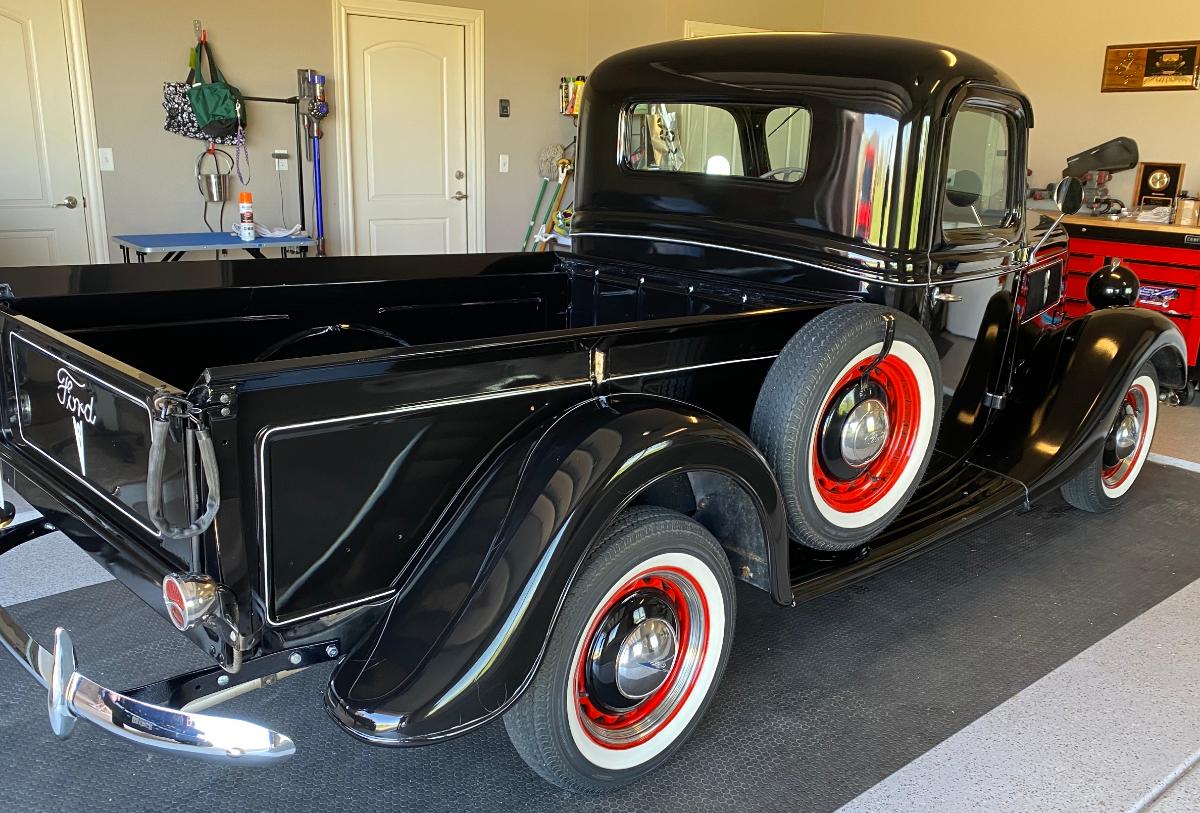

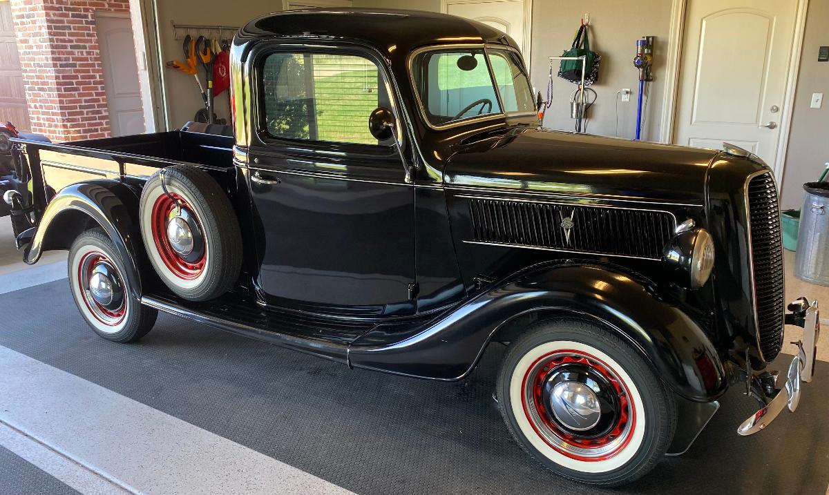

Bought as a gift for my wife. A cool old truck that’s been a work in progress. Any other V8-60 owners out there that I can pick your brain?

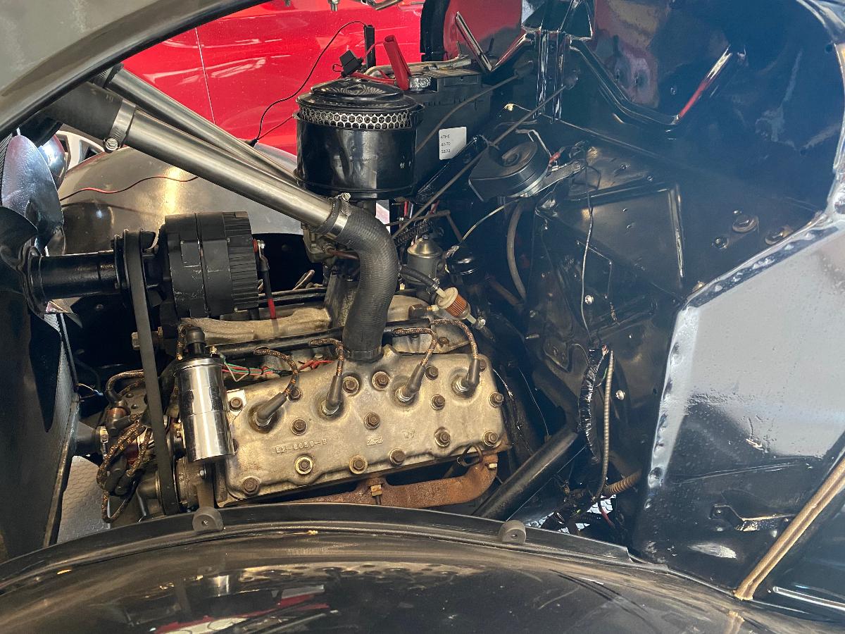

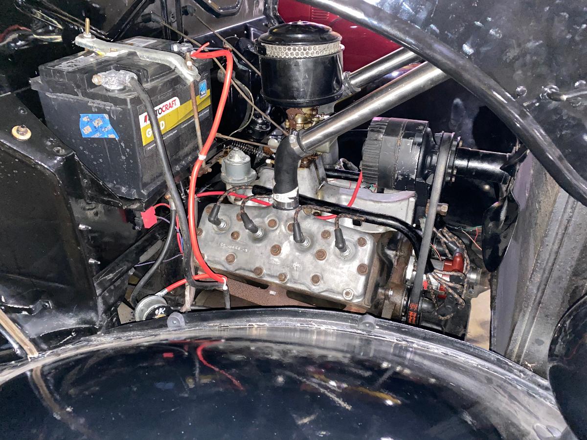

Ok. First standard question. I know they all leak and maybe burn a little oil. Aside from that, what is your standard oil leakage/consumption that you see?
Mine burns very little. Compression is a little weak on one cylinder, otherwise it cranks every time and runs like a top. I’ve had a water pump rebuilt and a front main seal leak repaired, but the engine will easily leak probably a quart every 100-150 miles. The shop says it’s venting normally out the weep hole up front at the bottom of the pan and I’m seeing that also on the cotter pin weep hole. I’m wondering if it’s the rear main seal and if that requires an engine pull….or should I just look at a rebuild? It just seems like an excessive amount.
Is there another oil/vent circulation issue I should consider?
I’ve replaced the oil vent cap with a new one and fill w/4qts.

Gift for your wife....that's a good one. Seriously, that is a nice little truck & I like "the 60" !
06-13-2022 @ 7:38 AM
That is a sweet ride. Leaking that much oil is not good for the truck or the environment.
I doubt that the oil is coming from the oil pan vent up front. If it is the source of your leak, your oil pan has too much pressure in it. Excessive oil pan pressure is developed if the breather is plugged or worn compression rings allowing blow-by. Remove the oil breather cap and look for oil smoke coming from the breather tube. If you see it, the oil pan has too much pressure.
Another thing to check is make sure that you are not overfilling the oil pan. The capacity for the 60HP engine is 4 quarts.
If the breather is clean and the oil pan pressure are OK, the source of your leak could be the rope seal in the timing gear cover and oil pan. Try one of the newer graphite impregnated seals and install the crank pulley before installing the oil pan and the timing gear cover.

That's a very nice looking 60hp '37 pickup! I'd love to own one like that. I'm a fan of '35 passenger cars, but when it comes to pickup trucks I definitely prefer the '37 over any other year.
