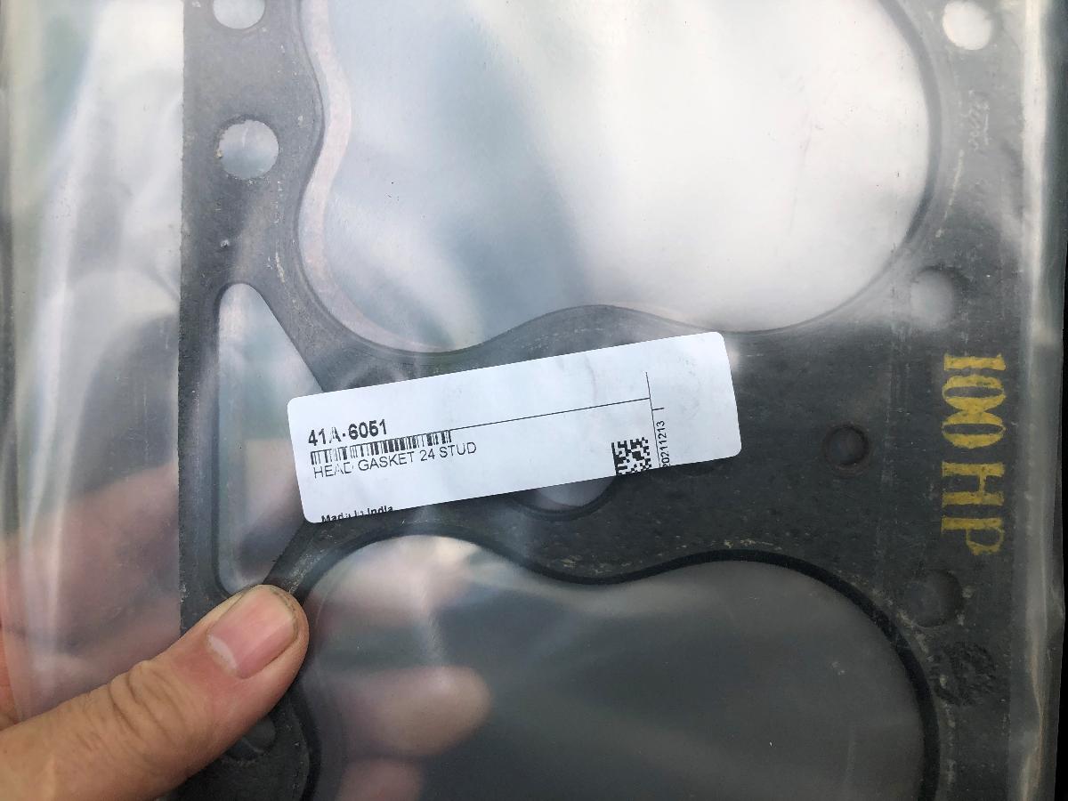

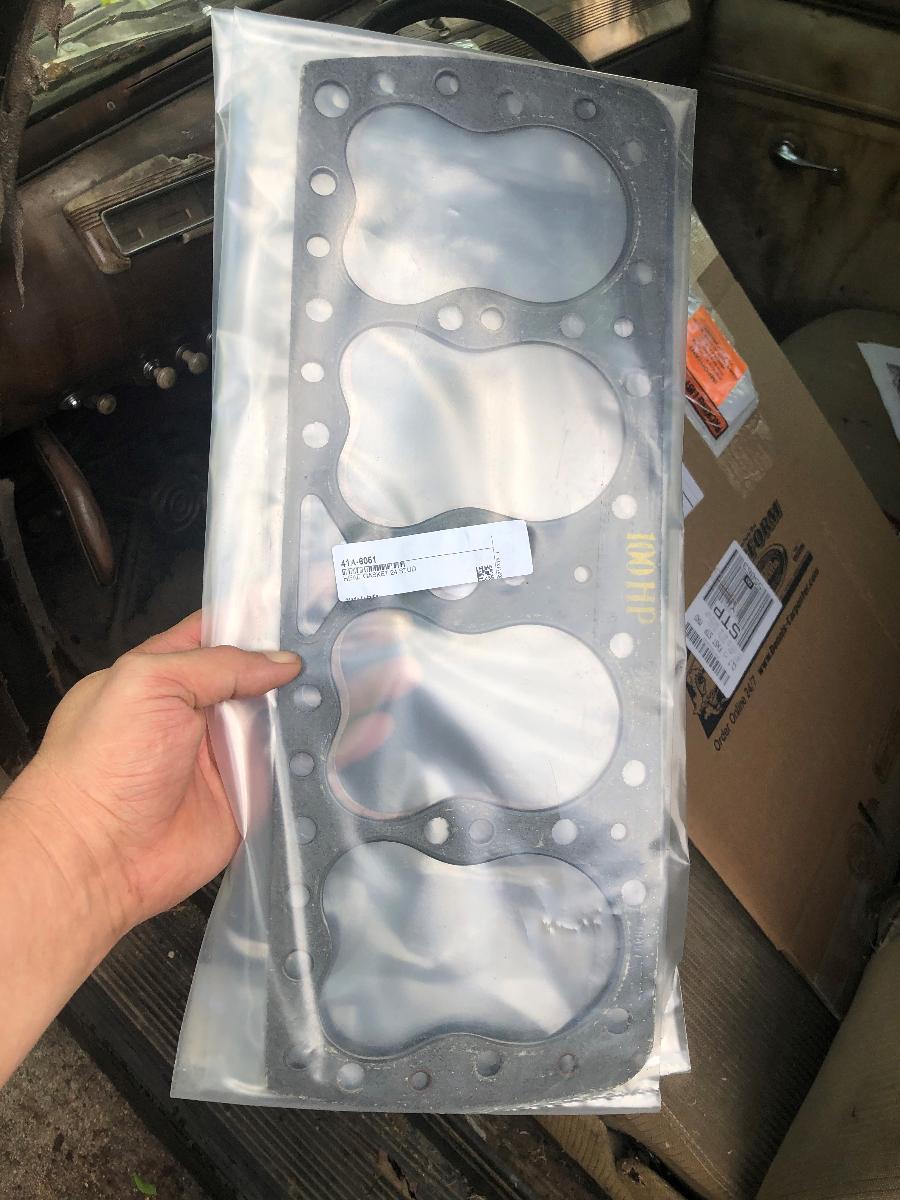

I have odd heating-up issues, car takes a long time to get warm, the drivers side will go up to 220 then drop done to 190, I have had the passenger side run at 190 for 20 minutes and then heat up to 220 briefly, is this trapped air? I have only run it a couple of times because I want to sort out this heating issue. It has an aftermarket aluminum radiator and a 7 lb cap, I added a burp tank which seems to be functioning but still seems like I am burping air into it, I bought head gaskets because I'm sure it could use them and that may be my problem, I bought them from Dennis Carpenter, I ordered based on my assumption that the motor was original to the car (wrong), the gaskets I have cannot be used on this motor, correct?

Judging by the distributor location, 8BA heads and removable bellhousing; you have a third generation Ford Flathead V-8 engine (1949 or newer pass. car or 1948 or newer truck). Those new head gaskets you have will not work on your engine.

"Judging by the distributor location, 8BA heads and removable bellhousing; you have a third generation Ford Flathead V-8 engine (1949 or newer pass. car or 1948 or newer truck). Those new head gaskets you have will not work on your engine."
Thanks, that's what I was starting to think but I'm taking in a lot of new info on old stuff right now, just want to confirm
