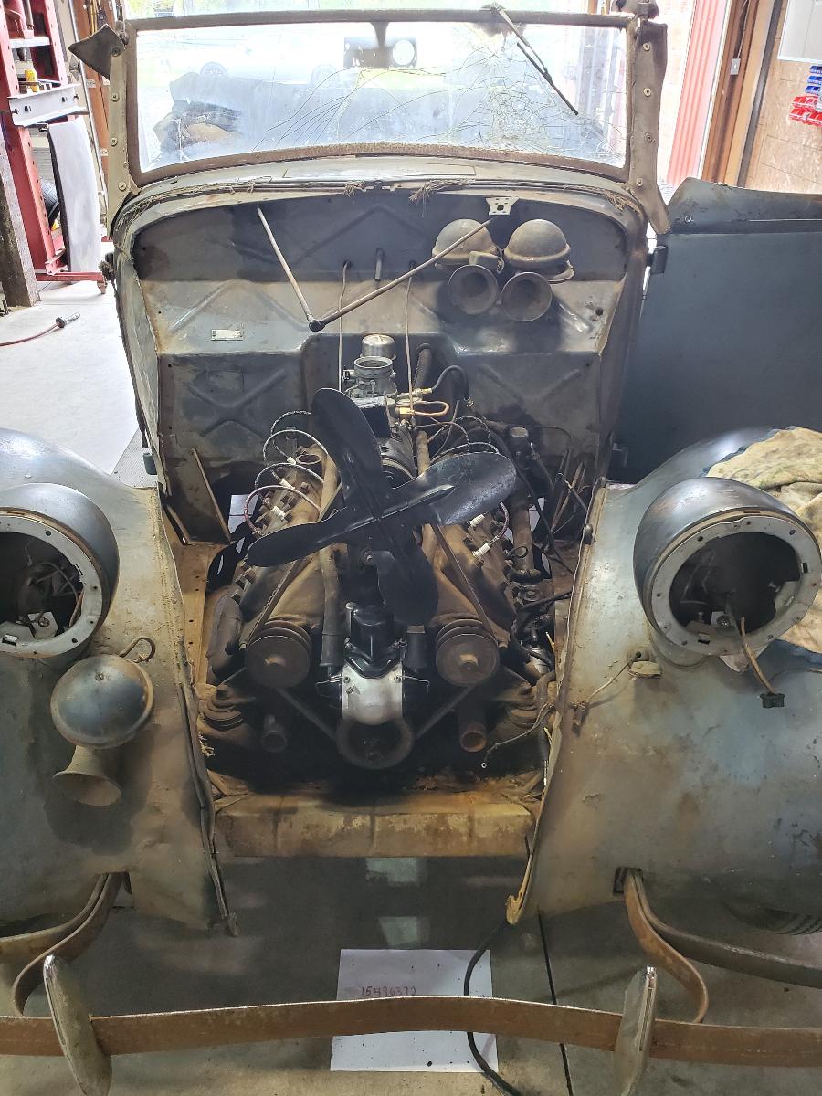

Hello everyone! I'm new to the forum and working on a 35 Roadster, it has what I can figure is an engine out of a 41. The question is I can't seem to find a good schematic on what order the plug wires go on the "helmet style" distributor. Any help on this would be appreciated.

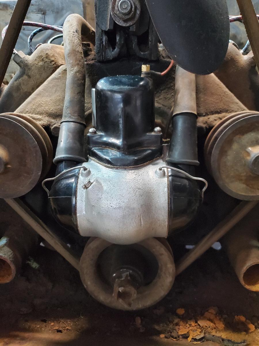

There is a brush mounted in the bottom of the coil that makes contact with the distributor rotor. If this brush is missing, excessively worn or stuck in a retracted position, the ignition circuit will not be complete and there will be no spark.
You can verify that this brush is present and making contact by removing one of the distributor cap assemblies (inner and outer caps) from the side of the distributor and looking inside with the aid of a light and a mirror.
If your brush or spring is damaged or missing, you can purchase a new Ignition Coil Contact Brush (P.N. 68-12010-S for 1936-41 - brush & spring) from Yesteryear Ford Parts.
05-29-2022 @ 4:16 PM
Posts: 1979

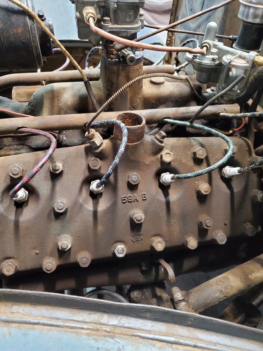

Check to see if your distributor rotor rotates when you crank the engine. Judging by the markings on your cylinder head, you have a 1946 to 1948 Flathead V-8 engine. You have a 1937 to 1941 distributor on the engine. If this is the case and the parts inside the engine are stock, you will have to use a distributor to camshaft spacer ("cam button spacer") to allow the camshaft to drive the rotor. The required item is available from several sources, two of them are: MAC's Antique Auto Parts under P.N. 11A-6280 and Speedway Motors under P.N. 910-12710.
This adapter takes up the space between the front of the camshaft and the rear of the distributor, it is required to mount a 1932-41 distributor on a 1942-48 Flathead V-8.
