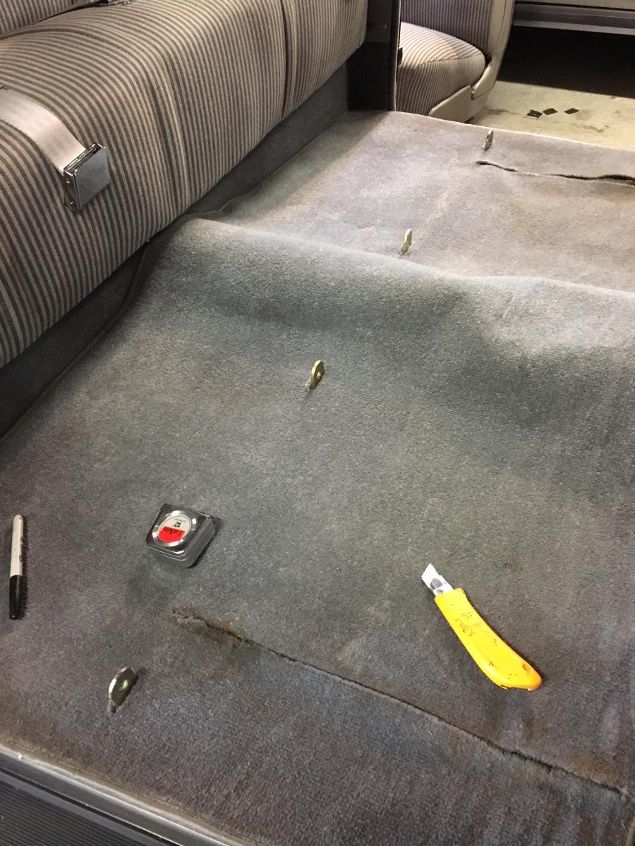

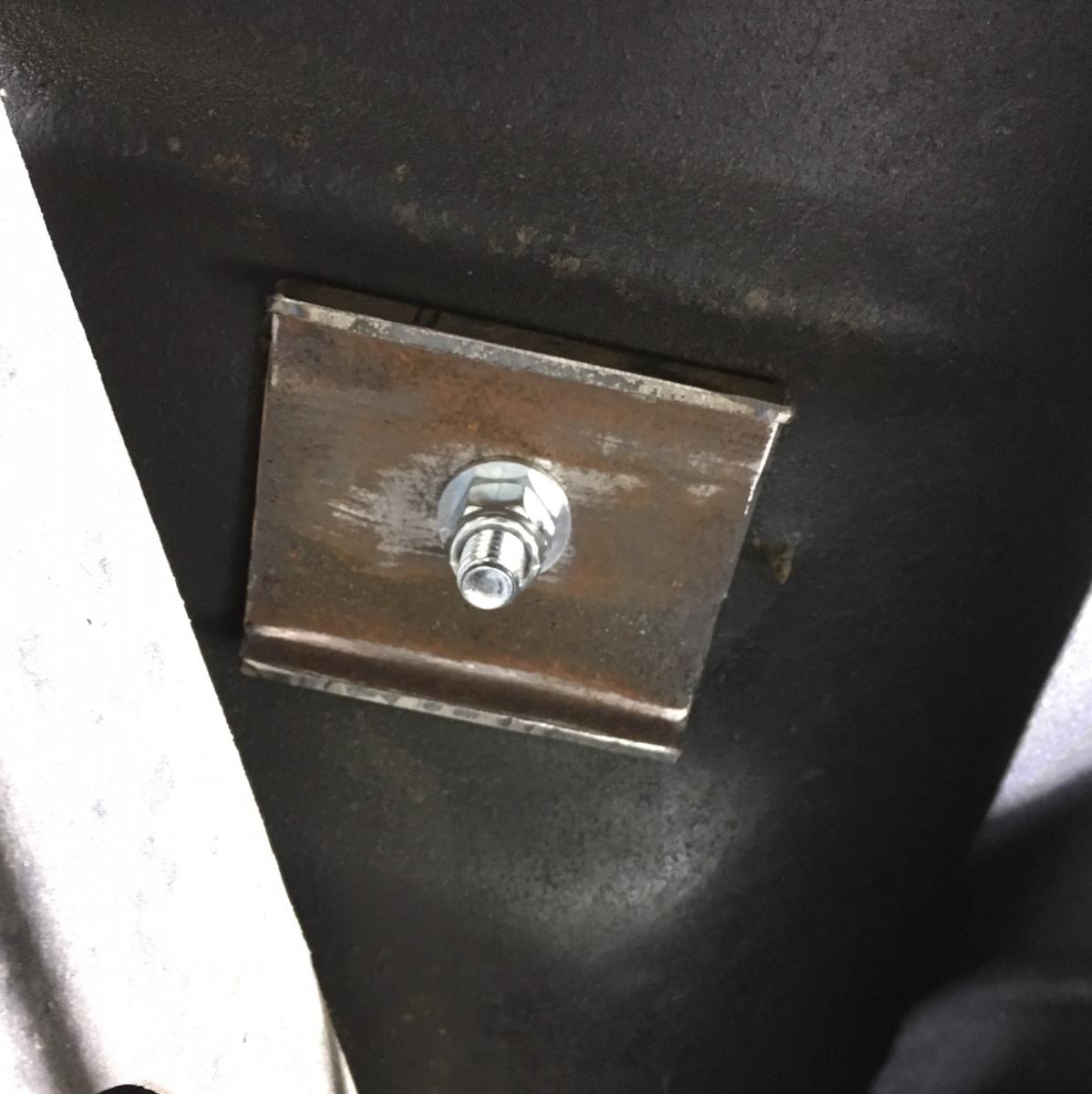

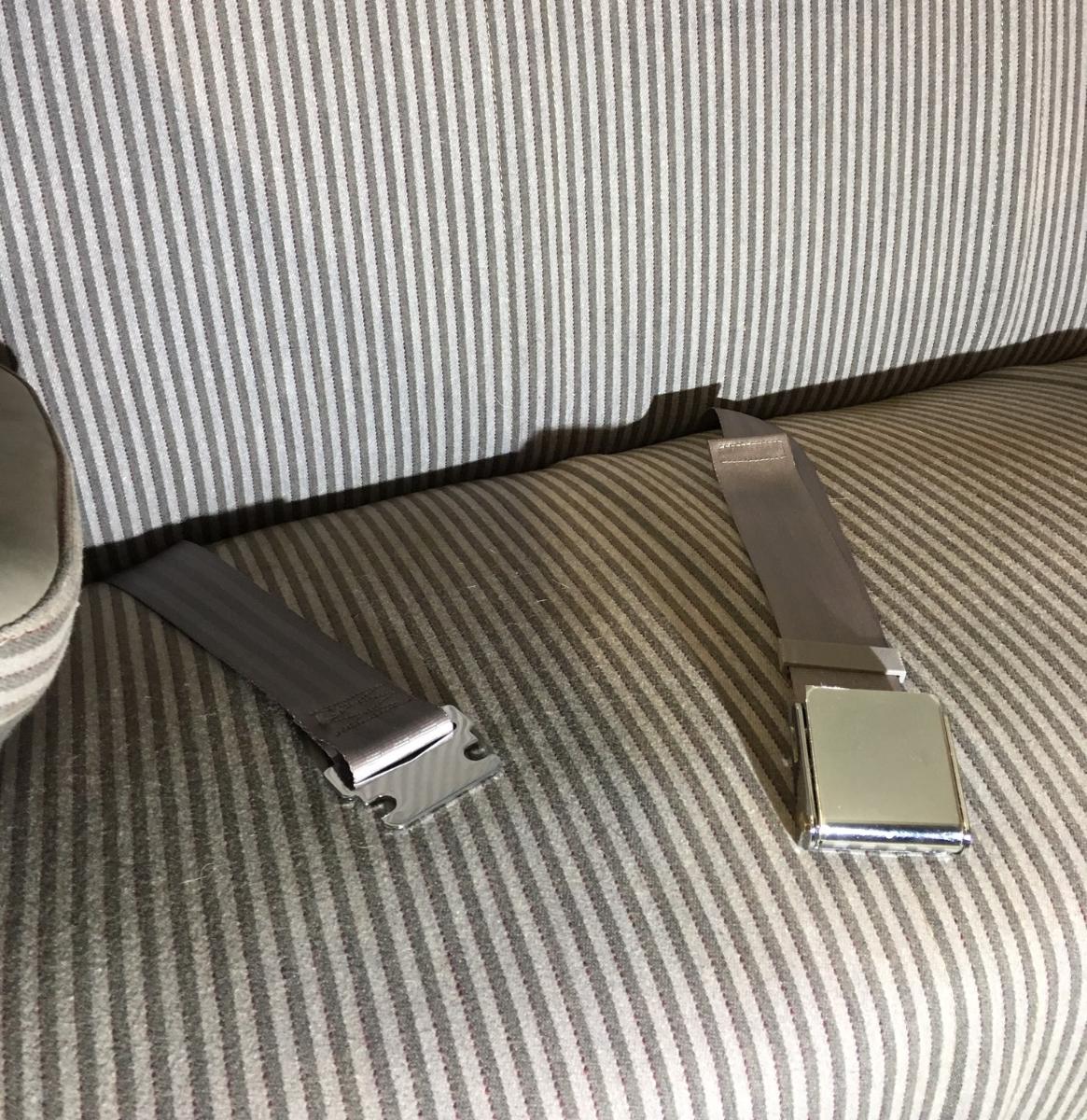

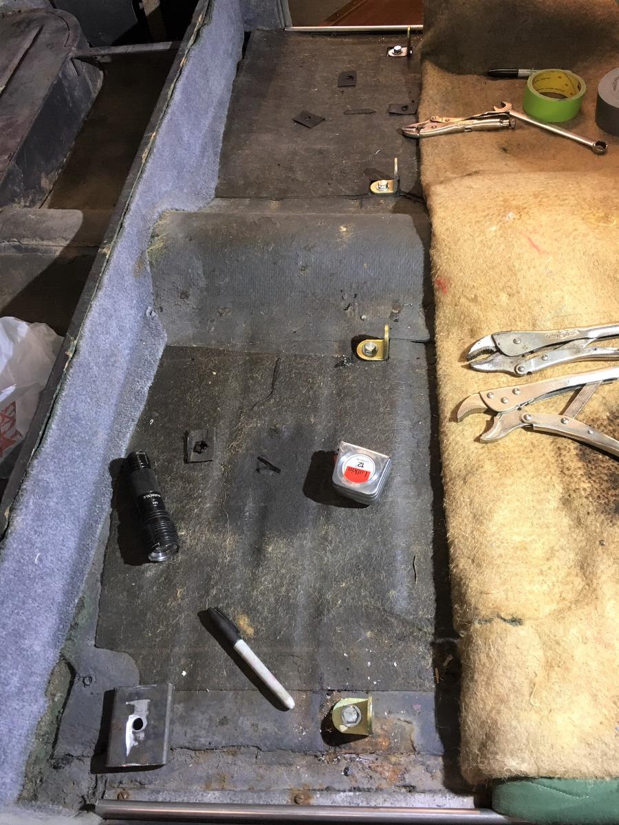

Tim. I'm not sure if these pics of the seatbelt install I did on my '46 Coupe will help. But I'm sure other members will add info. Here is the link to the supplier I got my belts from. I did two sets only, front and back. I made my own 1/8" reinforcement plates that are 2"x 2". The gold anodized angles are from the supplier.
