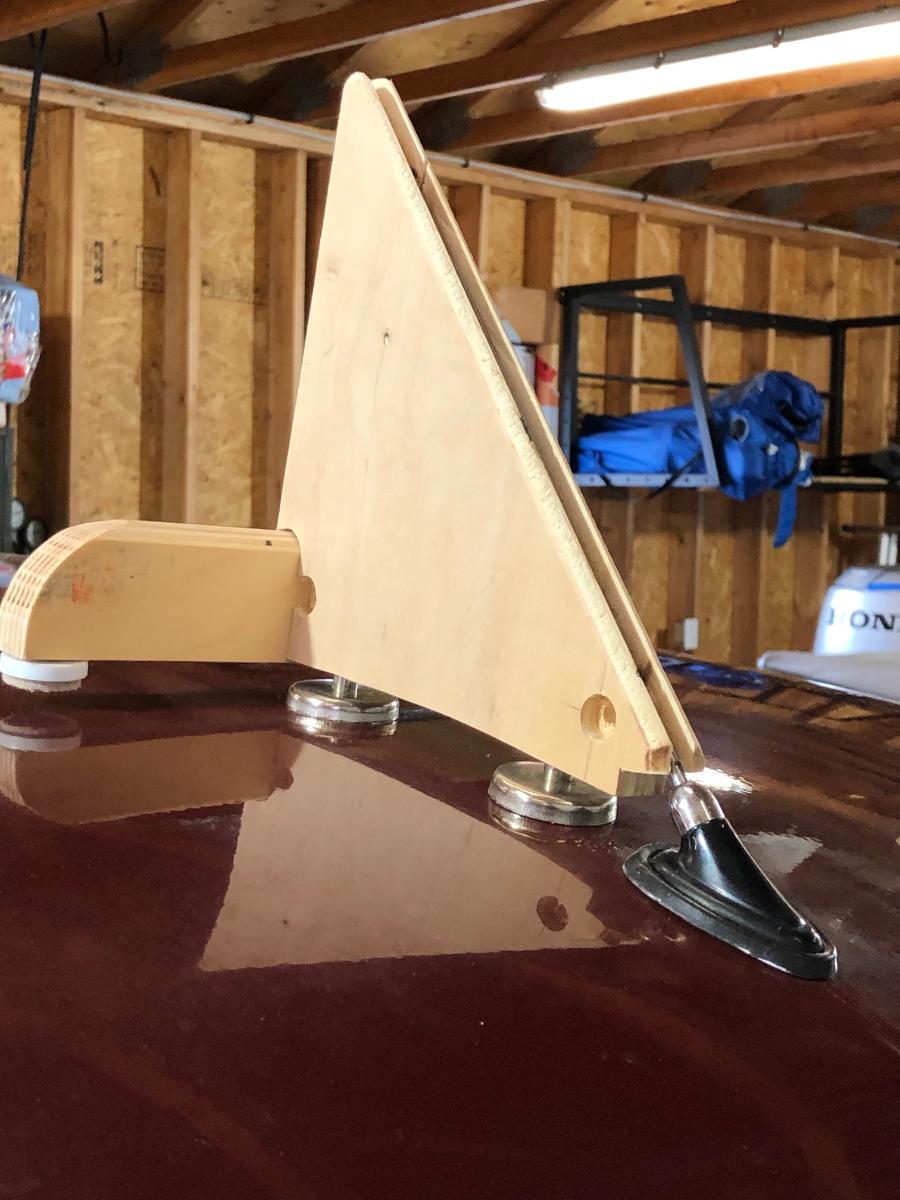

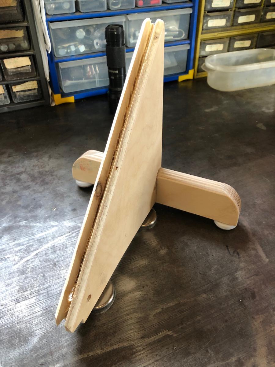

I was getting frustrated trying to put the cover on my '46 coupe by myself, without bending the roof antenna. I had someone to help the last number of times I covered the car for the winter, so there was no problem. So I could do it myself, I decided that a little woodworking job was needed, and built a support for the antenna that attached to the roof with magnets. The two magnet faces are covered with a layer of packing tape to prevent scratching the paint, and the cross piece has felt chair pads.

That is a neat solution to the problem. Thanks for posting it.

Some good suggestions, but my '46 is a stock Super Deluxe Coupe, and the antenna goes from the dashboard by the wiper switch , up through the roof in front of the mirror mount, and can be extended/retracted from inside the car. There is a plastic collar that is used to slide the antenna up and down. No options to remove or modify, and remain original.
