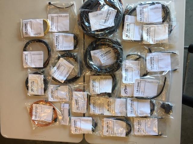

Looking for the best approach to do the interior Dash wiring on a 1951 Ford Custom Club Coupe. Is it better to remove the dash and install the wiring to the instrument cluster, light switch, clock, etc or remove the instrument cluster and terminate the new wires on the instrument cluster reinstall the instrument cluster and then run wires to the light switch, clock light, cigar light behind the dash? Thank You! Dave

Dave. With the assumption that you will be replacing with repro wiring, take lots of picture from a lot of angles. Tag old wires with tape as you remove them for future reference. It will be helpful to have a wiring diagram to follow as well. The harnesses that I bought from Tyree Harris had sheets that identified the wiring.

Thank You all for the responses. I have removed the front seat. The two front headlights, parking/turn signal lights and cross over wiring has been replaced. The wiring to the oil pressure sensor, Temperature sensor, horns, Starter solenoid have been disconnected. Cut the wiring harness at the firewall. The next step to come will be to unbolt the instrument cluster/speedometer. check and clean associated gauge and install new wiring. Thank You again for the input! David

I used Tyree Harris' wiring and found it fairly friendly, drawings were easy to follow.
