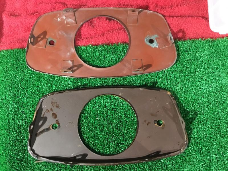

Glove box radios use a special mountings on the rear and a special face plate to replace the glove box door. There are two different Mfg of the glove box radio and each may have different designs to the faceplate and rear mount.

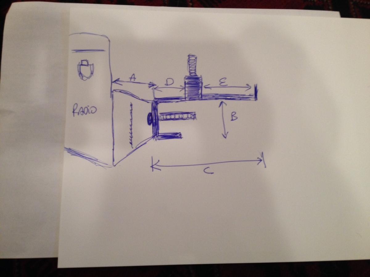

40 Coupe, do you have the measurements for a-e in your drawing? Thanks. Tim

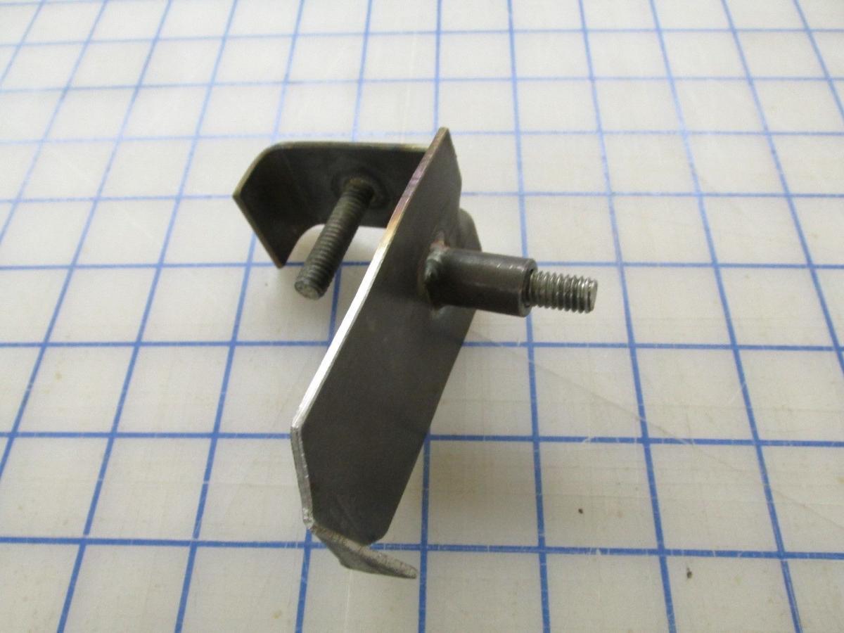

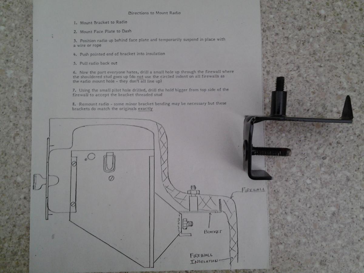

If you search on fordbarn.com you can find dimensions and many more photos of the rear bracket. The photos of the radio faceplate are also from fordbarn.com

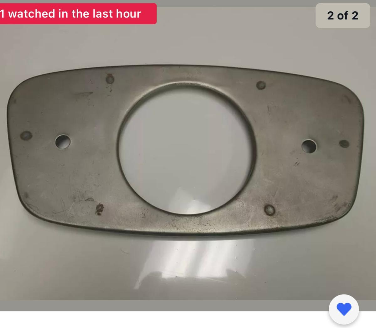

Is this the same size as the glove box door ? Can holes just be cut in the door instead of using this faceplate?
