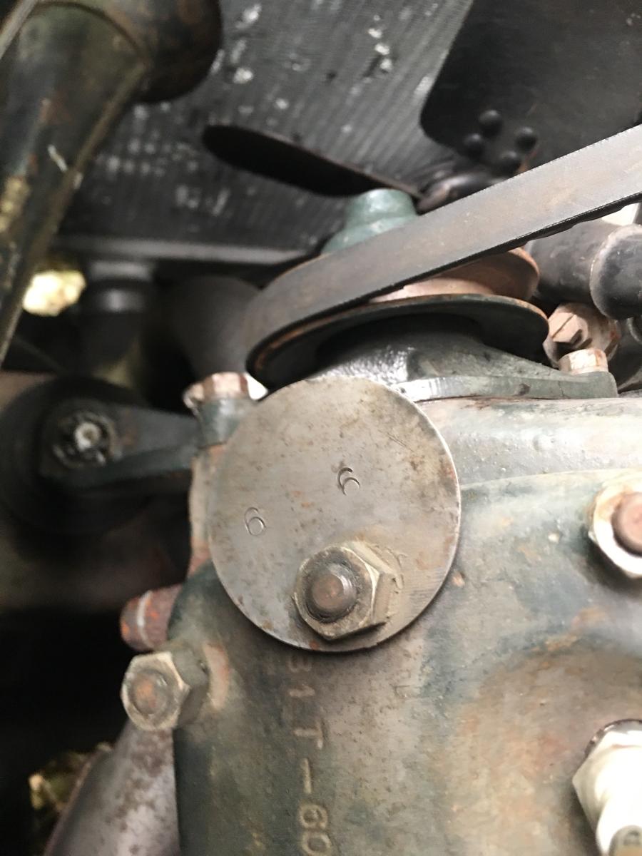

Oh, any knowledge about this particular rebuild (presumably) tag?
