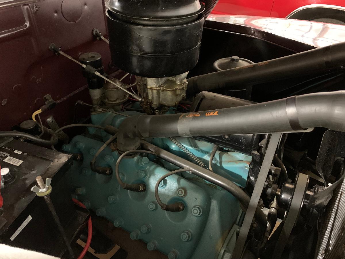

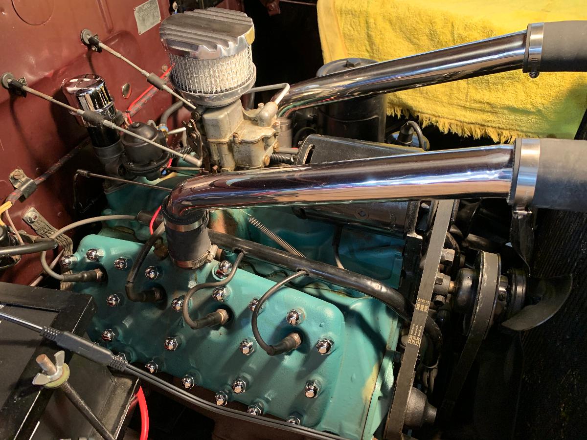

Good Morning
I have a '42 Ford Tudor Sedan with stock 221 V8 (owned for 1 year now and my first flathead - so still am a novice)......it has a bit of a cooling issue as I understand many have.....90-95° day driving around it seems to run in the "normal" range pretty well......if I stop and sit at idle for 2 to 3 minutes it will creep right on up to the HOT......I am thinking I may add an electric fan to help with this issue.....(I am not a "purist" and have already made a few minor changes under the hood so adding the fan is not going to make a difference that way). I am looking for recommendations from any of you who have already went down this road....Speedway & Summit seem to carry a wide variety but I really don't have much of a clue of what I really need.
Any positive input will be greatly appreciated.
Thank you in advance.
(Reference Pics - 1 yr ago vs. now)
