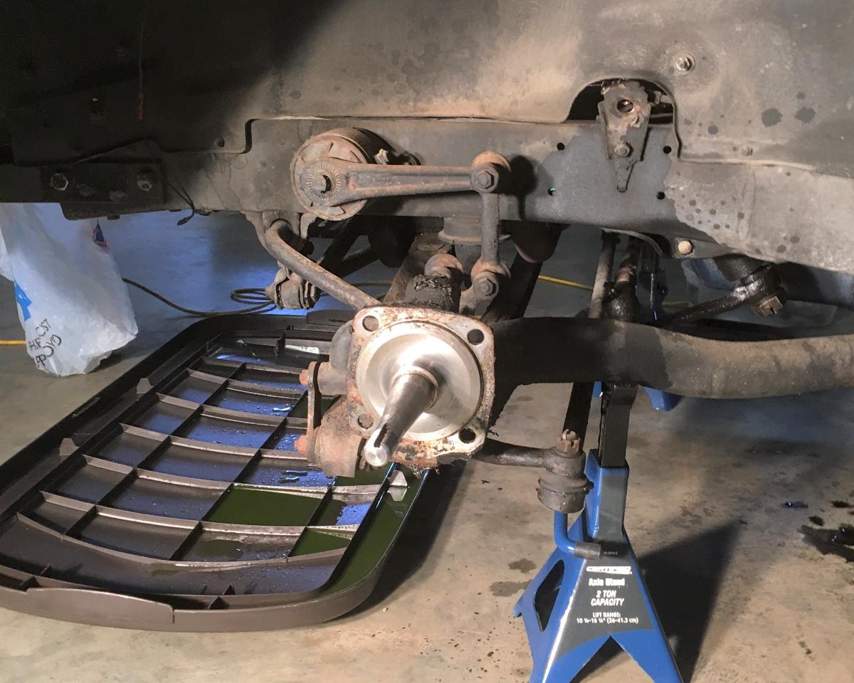

46coupe. If I understand your description, you are looking for the shock links that connect the lever arm to the axle attachment point. I had to replace the rear ones on my '46 Coupe, and I got them from Carpenter P/N 99A18055-A 4.75" long. Check your length. For some reason, Carpenter doesn't list the Marsden nuts that go on the link studs, so I had to get a package of them from Mac's, P/N 21A-351022. The first pic shows the rear shock arm and axle connection point, and the other shows a pic of the front axle link

Thanks to both of you for the website and pics of the parts involved. I'll be contacting Carpenters for the link. My other question is. How do I level the rear axle? It is at about a 20 degree angle right now while the car is on the lift. I tried to jack the left side of the axle up but no good. Would it be safe to put the jack under the drum in order to get the axle level and to attach the link at both ends? My lift is a Quick Jack so the car can only be lifted off the floor a short height.
06-12-2021 @ 7:51 AM
It is not safe to try to jack up the axle by placing the jack under the drum. I would lower the car off of the Quick Jack and just jack up the rear end of the car and place a jack stand on the axle housing near the end that has the broken shock link. Then lower the jack until you can attach the link by bringing the shock arm closer to the axle housing.

After I posted I found the threaded stud on the bottom part of the link. I had initially missed it as it was buried in paint, filler or something else. I figured the brake drum would not be a good idea as it’s cast and could break. I’m helping my wife dog sit this weekend at my son’s house so I’ve had time to think about other ways to level the two sides. I’d thought about doing what you suggested before reading your post. You’ve verified what I thought so now I know it will work.Thanks for your help and again to the other posters for answering the other parts of my questions.
